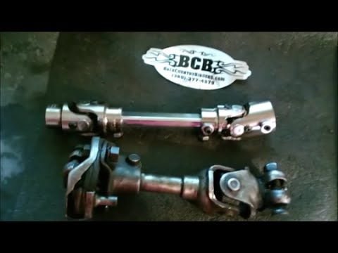

what’s the point with rag joint eliminator ? Isn’t it better with this part ?

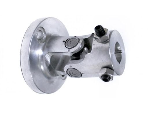

It does away with the flex or rag joint connection and changes it to a splined solid u joint. But you still need the ability to have some movement, so a slide style steering shaft is added. Also by adding the slide style, you can still account for frame/body flex and that way you have some give (compressibility) in the steering shaft/steering column in case of a front end collision. Make sense?
