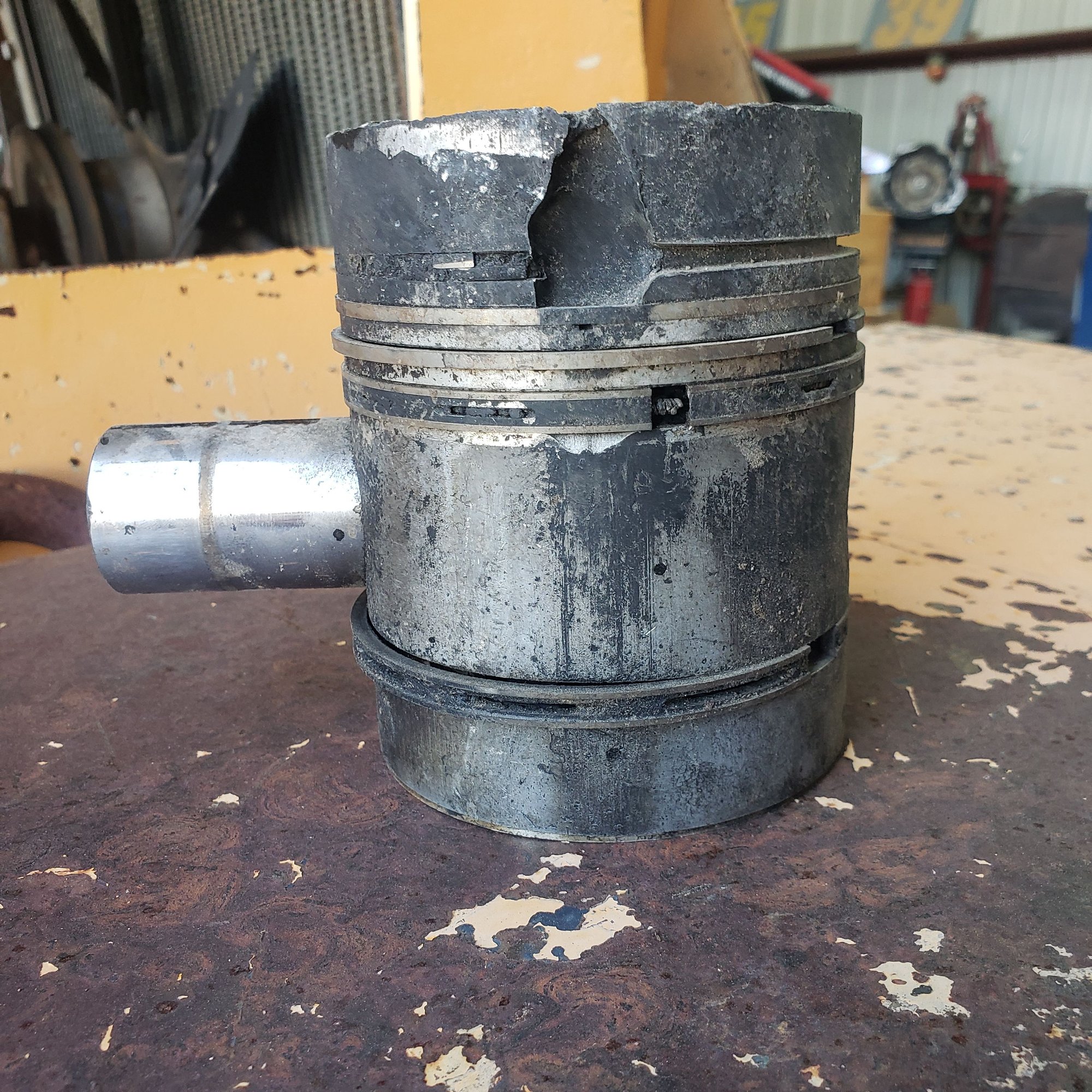

glow plugs died so they were starting it with either when cold, then it got to the point that it needed either to start on warm days, then progressed to always needing either, then got to where either wouldn't start it.
Diesel burns slow which is why everything in the engine can handle the high pressures. either burns instantly and shocks the rings and can crack them, once they crack they don't seal anymore.

Not too sure about too lean at startup . Thats when they smoke the most . (Obviously not lean ) Since they need compression to create heat , a less than capable motor takes longer . The turbo is spooling slow at startup so regulated air does not apply .My statement about octane still stands . GPs can ignite starting fluid sooner than the valves closing completely causing detonation at much lower compression .The explanation was (No GPS ) The picture of the piston is not from a shot or two of ether (Or a year) . If it was it would be all 8. That piston was a problem long before ether was added .
I have 70"s vintage case 188 350 that needed starting fluid every time I started it till I replaced the starter ( have had it for 34 years ) . My 70's vintage case 188 580C came factory equipped with a starting fluid applicator . Has never needed it .
(20 years ) .

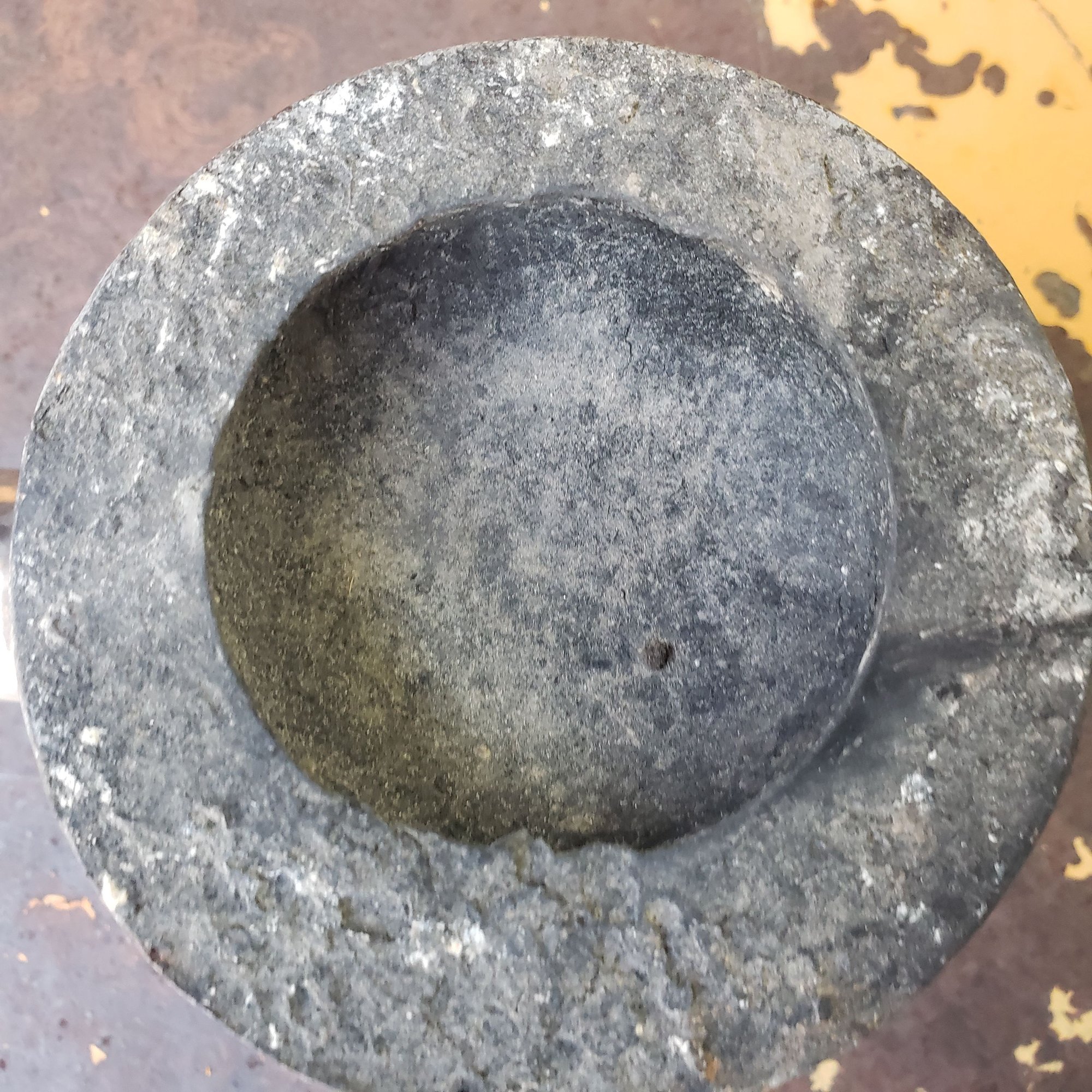

Back to the pic . I would bet the piston cracked from the wrist pin, then there would be a path to the rings . The top of the piston being beat to death is beyond me .Believe what you wish .
BTW don't "HUH" me .

the wrist pins were still serviceable, the damage on the top of the piston is from pieces of the compression ring, the head looked the same.
all of the pistons had broken rings, and the burnt out sides. this is the only one I kept.

You left out details . Starting fluid does not have enough octane to burn though a piston to that degree. Believe what you were told . Believe what you want . The pic of the wrist pin was not serviceable . If you just want to be right I'll leave it at that

yep your right and apparently I haven't been a diesel mechanic for almost 40 years either.
I didn't take a picture of the wrist pin when I rebuilt that engine as they were all in serviceable condition and went back in the engine.
starting fluid didn't "burn through the piston" the shock of it exploding can and does fracture the brittle rings, thus letting burning diesel to go past them.
