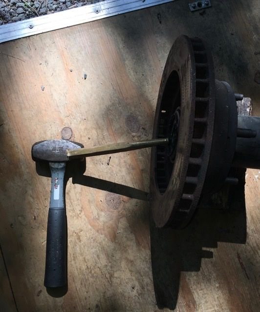

All, my truck was exhibiting a lot of back and forth steering wheel play and vibration. So, I jacked the front up and found that the driver's wheel had a lot of back and forth play (typical bad wheel bearing). So I took the locking hub out and started disassembling so I could replace the bearings.
First thing, the inner spindle nut seemed incredibly loose. Wasn't tight at all, actually. Just took it off by hand.
Second, my bearings appear to be in pretty good shape. The inner bearing and race should be replaced and aren't amazing, but don't seem to have failed in a way that would cause the wheel to have play in it. Is there something else that could be wrong? Passenger side wheel has 0 play.
Third, I noticed that the axle shaft inside the spindle can pull outward and push in a bit. Is this typical for the locking hubs? When I pull it out it sounds like nothing is turning in the front diff, and when I push it in I can hear gears meshing. I assume that's normal.
Lastly, I can't seem to get the races out of the hubs, no matter how hard I beat on them. Is there some magic with how that's done? I'm trying to hit them towards the inside from the outside.
Any help or clarification on any of the points would be helpful.

Old Sep 26, 2021 | 12:42 PM
My4Fordtrucks's Avatar
My4Fordtrucks
Joined: Jun 2015
Posts: 12,830
Likes: 2,435
I’m a little confused what that means.
I've been focused on that inner race, which was being hit in the correct direction. Just can't seem to get it out.
You have the drift/punch inside the hub and are driving the outer race toward where the grease seal was?
or you are going the other way toward the locking hub?
It only takes a few times for them to pop out.

I finally got the inner race out. I just wasn't hitting it hard enough with a hard hammer (Used a rubber mallet). I finally just decided to attack it, and it popped out pretty easily. Now I just have to get the brake caliper back on, and I have no clue how that inner brake pad stays in place while you slide everything back together.
