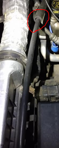

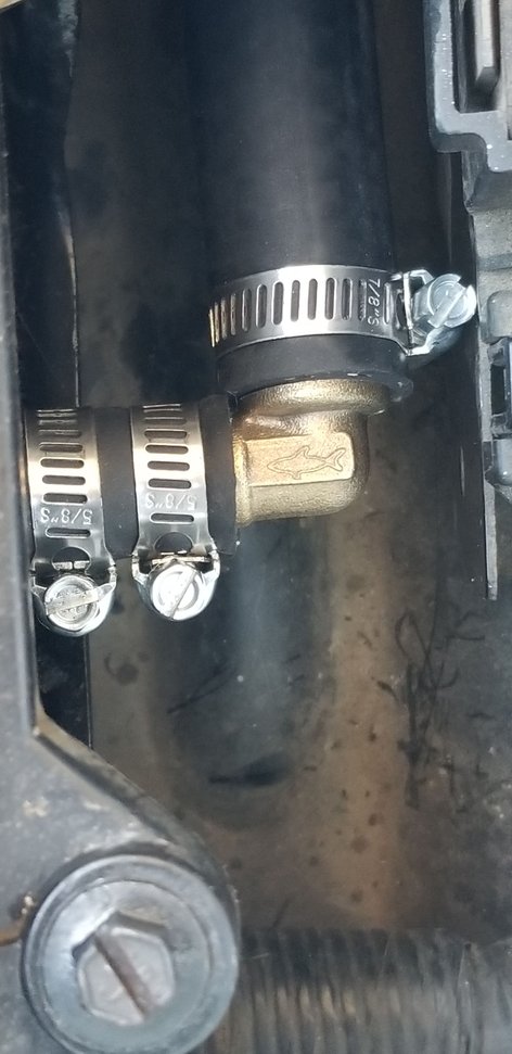

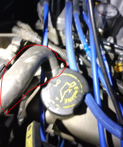

Sandy, I dont think he's talking about throttle body hose, unless I'm reading it wrong, it could happen, has before.
I think he is talking about the 5/8" rubber hose, that connects to neck on oil fill cap, and hose is connected to a hard plastic pipe that goes over to air intake 90's down, and connects to the small filter underneath, the intake air filter, which is part of the whole PCV system.
5/8" rubber hose
plastic pipe, slips into 5/8 hose, runs length of air intake hoses, to intake lid
5/8 rubber 90, plastic pipe slips into, at air intake filter lid

I have never owned a 5.0 or 5.8 and I thought the piece that comes out of the airbox that goes to TB went to the airbox. I see in your picture that it goes to the valve cover even thought your pic is a 4.9. Anyway I misread his post. Thanks for clearing that.
