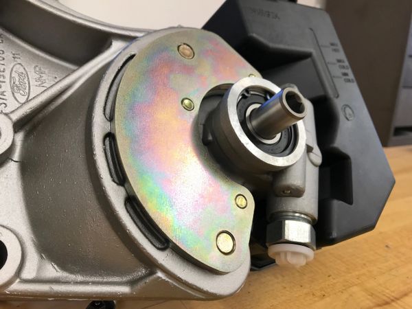

https://leepowersteering.com/collect...mp-replacement
When the day comes I'm probably going this route.
why? If you can find one, saginaw brackets are much less than that, and a replacement pump will be way cheaper as well.
I like the simplicity of the pump you posted. A simple bolt on which is what I was hoping to find. While the pressure is good I don't know if the flow is enough to supply a steering box and cylinder. PSC use to post their pressures and flow rates. My TC style pumps are 1650psi and 4.5 gpm. From the recommendations above I guess I will research the flow rates of a Saginaw pump and try to find a pump for my needs.
The lee ps link has to be a TC saginaw pump but in a c2 housing. The P pump is too large to fit in the smaller design and the TC pump is the smallest saginaw mainstream pump. If it has a bearing by where the pulley goes, its almost definitely a TC Pump. If its not a bearing but a bushing instead, it might be a CB pump but I dont think they would go up in size and weight for a CB pump when a TC is smaller and can most easily be made to work.

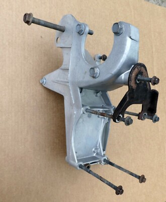

so this is an example of my trucks bracket (96 4.9 with ac) i believe.
Im a little sad now becaue it looks like the C2 bracket for a ranger is smaller than the f series....... but i may be wrong, i dont know much about the C2 pump. Anyone can chime in expertise?
If the spacing of the holes is the same, the bracket i pictured above to use a TC pump would only use 2 of the mounting spots and you would have to presumably pick two spots, the outer most on its own hole prob not being the best one to use if you had to choose. If the spacing would work, that is....
if one can successfully mount a TC Pump, you can just get a remote reservoir modeland find a way to mount it if it was in anyway awkward how it sat on the bracket and then you would need to do something about the pressure line(no idea if fitting is same) and you would need to find a 17mm shaft pulley for it too. tc pumps can spin fast without issues so a lot of care would not be necessary but a larger pulley prob means more wrap too. i think.
Someone please tell me it will work and then someone tell me where im being hopeful and its not possible based on something i missed (((
I like the idea of this. I don’t know what the bolt pattern difference is between the Ranger and Full size pumps are. 90% sure the first gen Rangers used the full size steering box. What is the difference between the 5.0/5.8 mounting and the 7.5 mounting holes for the pump. PSC offered a adapter for the Saginaw pump to fit the 5.0/5.8 bracket but not the 7.5 bracket. I like the idea of the remote reservoir. I used PSC’s reservoirs on my Jeep and Samurai. They filter the fluid and hold more fluid. But for somebody wanting to look more factory a pump mounted reservoir and just easier there are those style pumps too.
