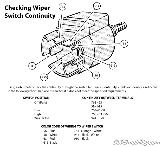

Hey all, I'm slowly starting to put the interior of my 78 f250 back together, my delema is how to test the wiper motor before I go to far with the rest of the install. Don't want to get it all done just to find out it's bad down the road. How would I go about testing it?

Maybe this will help?
Thank you sir, I'll read through it and see if everything works out.
