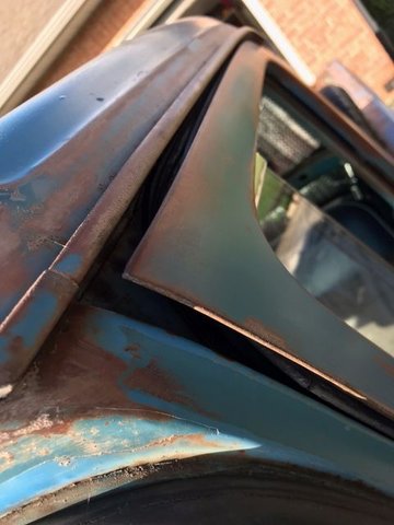

door pinch issue - pictures
Here are some pictures

From what can be seen in the pictures, the door fits nicely except the top front? Does it function properly in this position? If it does then the door needs RE tweak. If not, adjust may still need done. Where does it touch the cab for example.

Door fits nicely and gaps are not bad between the panels. Body lines near line up as well.
When you close the door it stops 98% of the way on its own and you have to give it a 2% nudge to get it to shut on the catch. Passenger door shuts effortlessly. Its sticky where the metal itself on the edge of the door is a little deformed.
I played with the hinges again this morning and nothing I do either door side or jamb side really solves the problem. Alas I might have to run it into a body shop to see if anybody there has an opinion.

Just came in from another round of adjusting. I moved the top hinge door jamb side all the way over, left the bottom hinge alone and although you now have to push a little harder on it to close on the latch the top of the door now at least is inside the drip rail part of the roof. I'm going to call that a win for now...

As part of the door tweaking you sometimes need to bend the door.
With the glass rolled down and something in the door jamb to hole it open a little push in on the top of the door frame to bend it back in.
It may not take much so go easy, a little at a time and test close to see how it fits.
Once you got it where it needs to be go easy on rolling the glass back up the first time if it is a little hard you may need to adjust the glass frame in the lower part of the door.
