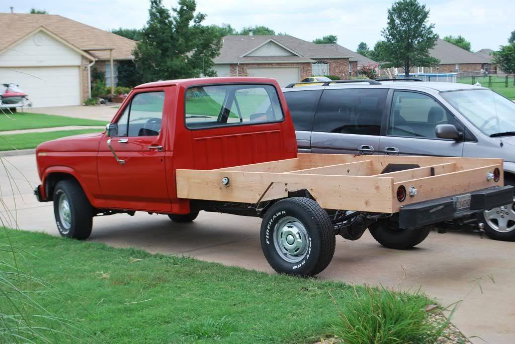

If you aren't going to have the truck for more than 10 years, you can put a wood flatbed on it. They are the easiest

What is said above. Measure the rails and then see if the bed matches up. As far as I know they are all quite similiar and could be made to fit with slight fabrication work. As to the long vs short wheelbase question whoever the guy is that told you that is a dweeb. It doesn't matter what wheelbase your truck is. You can have a crew cab short box with a 156" wheelbase or you can have an extended cab long box with a 155" wheelbase, both pratically identical wheelbases but different box lengths. Superduty trucks come with two options for box length. 8' (Long Box) and 6'8" (Short Box) if the flatbed is 8' as most are then it will fit on the back of your truck and cover the frame rails just like your regular box would.
