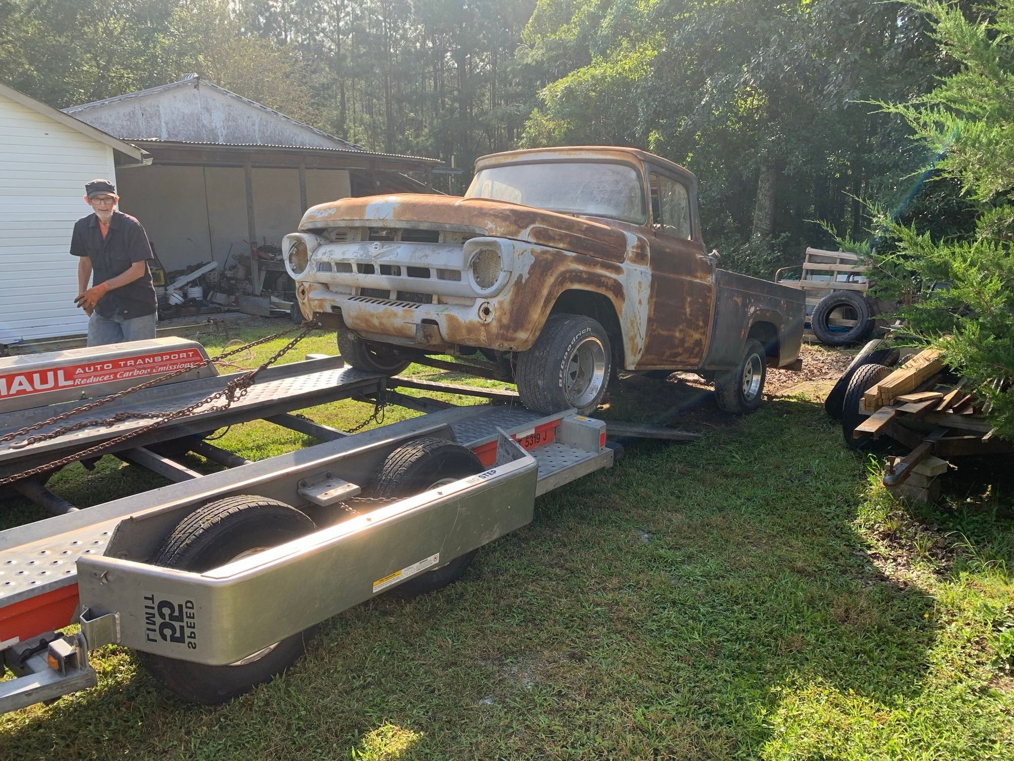

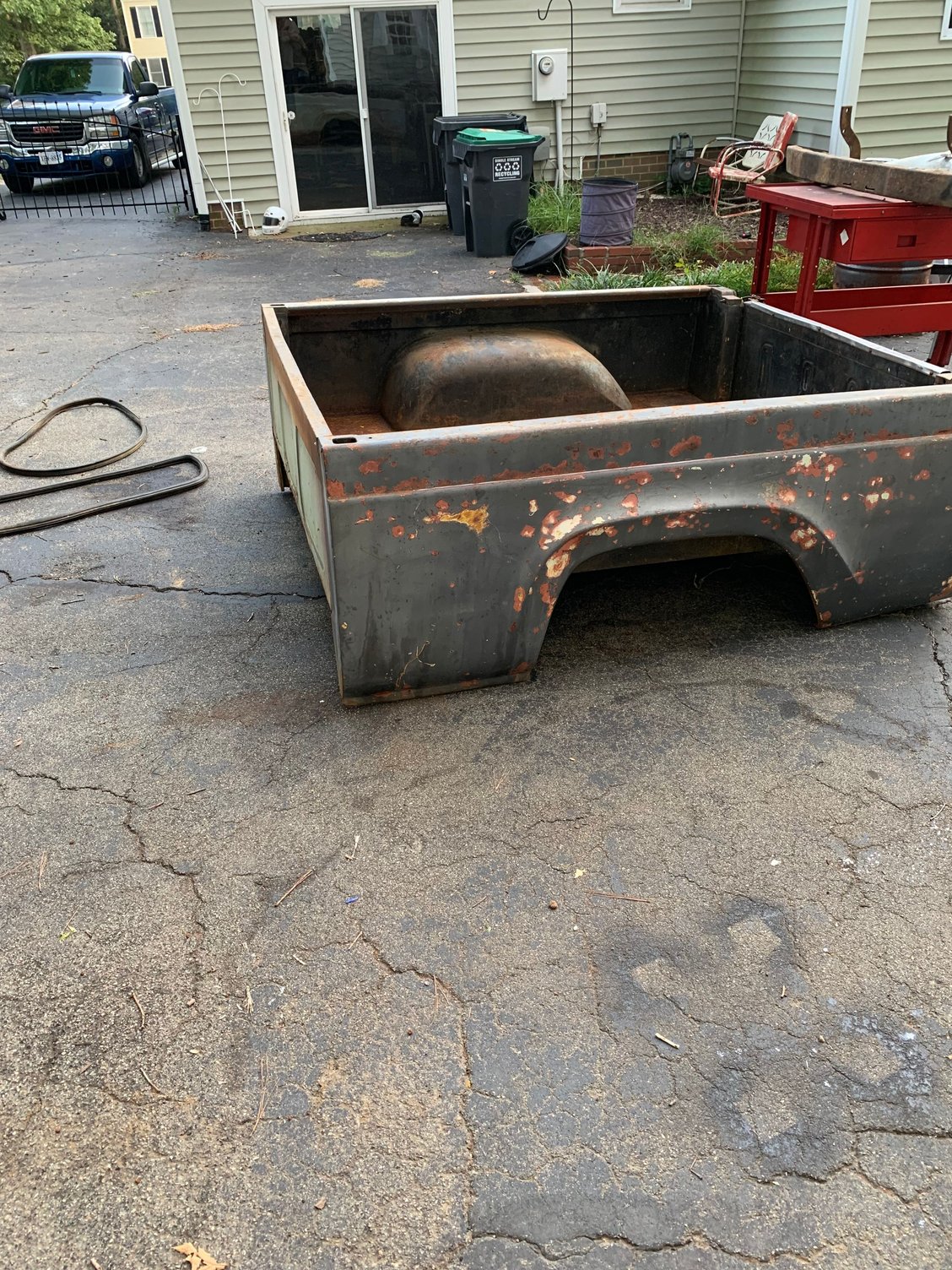

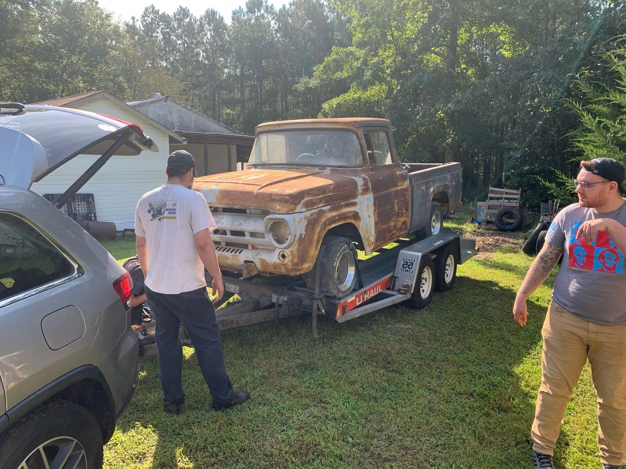

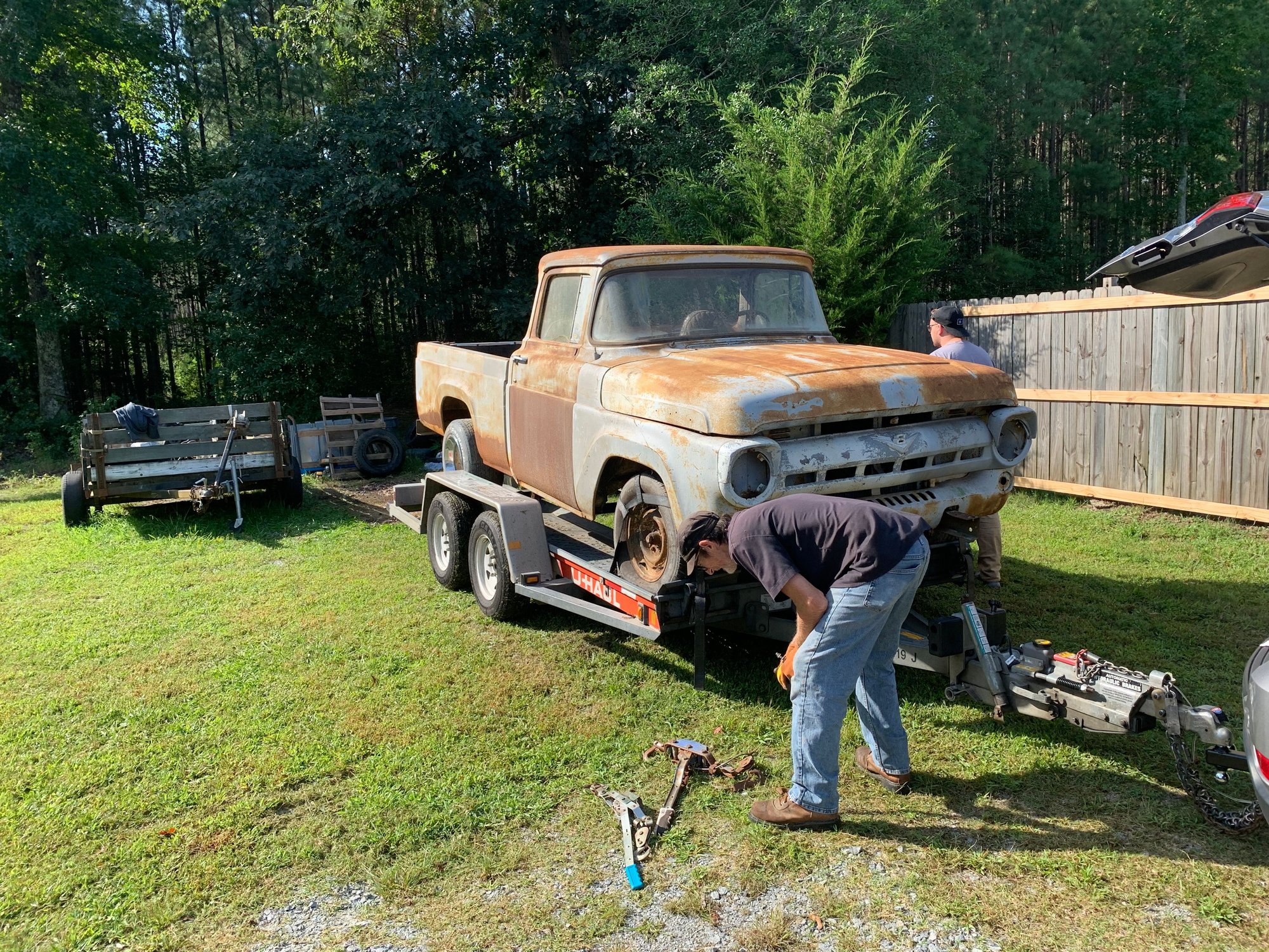

I just bought a barn find ‘57 F-100 Styleside with wrap around rear window to restore. It’s in rough shape and I’m taking it down to the frame. The truck came original with 272 but somebody put a straight 6 in it a LONG time ago. Trying to decide if I should find a 272 or just drop a 302 in it. Planning to put disc brakes on it either way and drop it a few inches. Any thought from the group here regarding the engine?
Pulled it out of the barn with a come-a-long
Loading her up
Strapping her down
About to hit the road
Bed removed
