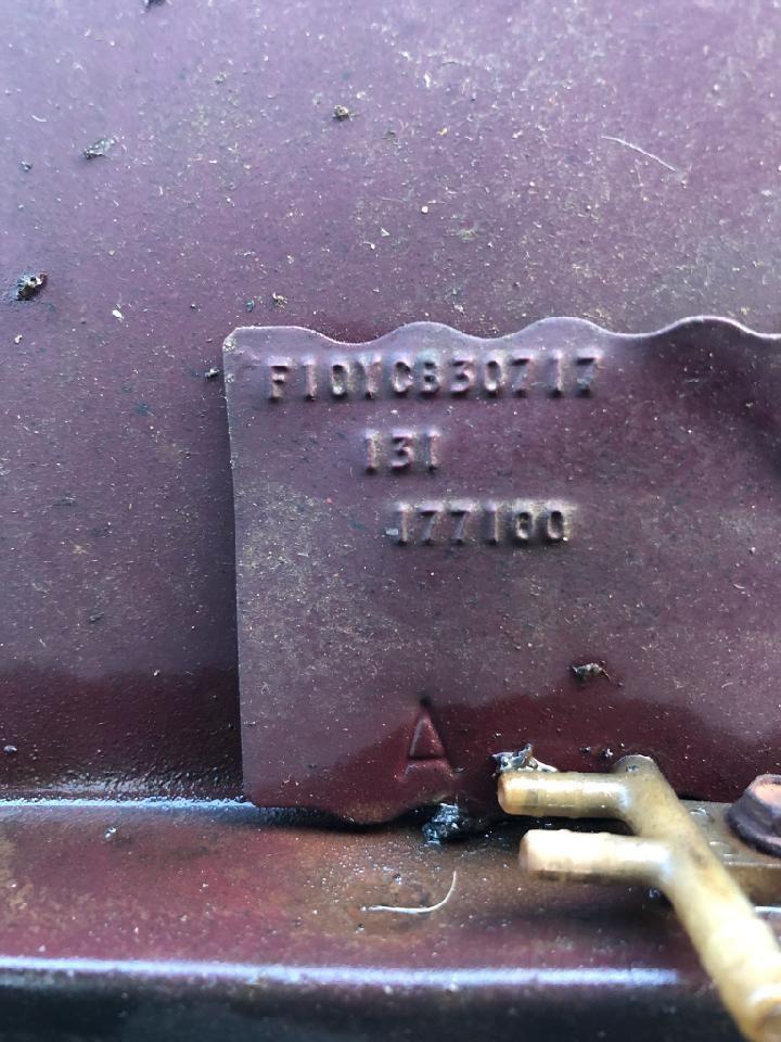

Here is a tag by the driver side hood hinge

Does it have 5 lug wheel or 6 or 8 lug?
The tag you found will mismatch the VIN as it's a factory build tag if I have understood previous comments about these tags correctly. But I'm not sure on how much of a mismatch. This would be F100 vs F250.
Is yours a pickup or something else behind the cab?

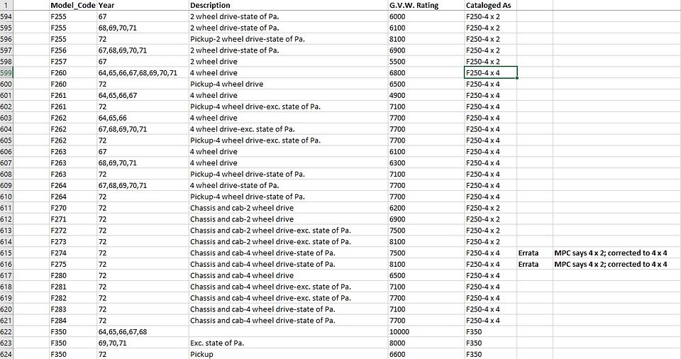

F282

F282 except PA what does that mean?

Especially after 1967 the state of Pennsylvania often had their own "Model Codes" so in the Ford documentation you will see some that are "except state of Pa." and others that are "state of Pa."

Thanks maybe for emissions or inspection stuff over a cert gvw. Its a pieced together truck
