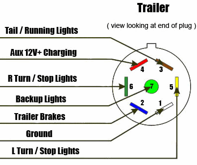

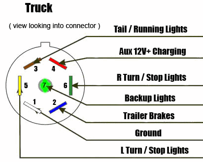

Did you check the the output pin on the truck with a multimeter or test light to verify that the signal is or isn’t there? If he plugged it in upside down and forced it like most guys will it could be as simple as a bent pin
