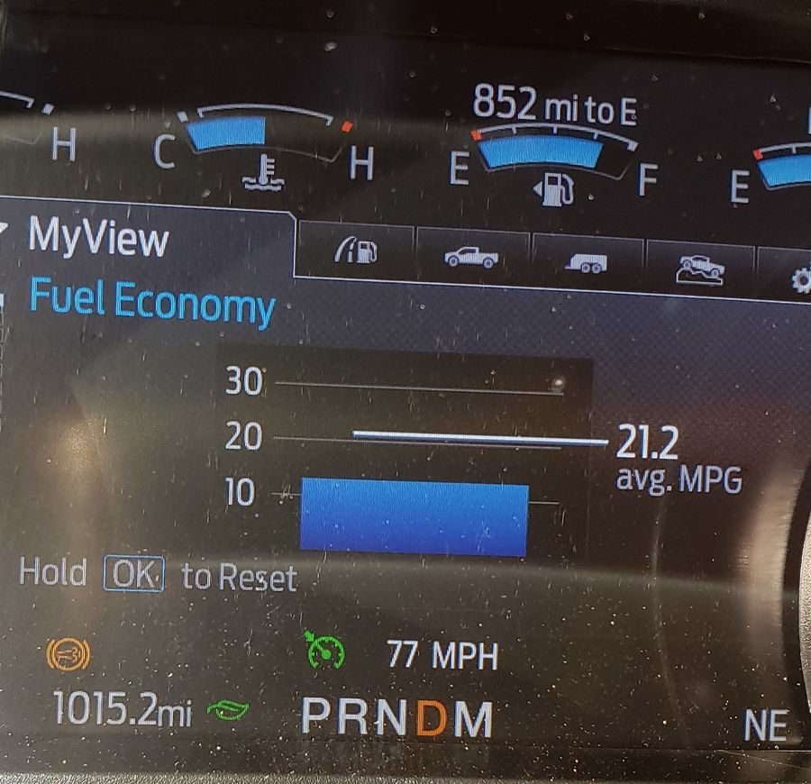

I know some have wondered how to tell when a regeneration is occurring, and some have set up to be able to see the DPF percentage.
Anyway, a quick easy indicator of a regen cycle in progress is by way of the fuel economy readout.
In the pics below, you can see the blue bar in the center of the fuel economy readout shows the "instant" average economy, the number on the right shows the overall average for all the miles since the meter was reset.
Both pics were taken during similar driving, going down a slight downgrade, a situation where the engine is de-fueling.
But, where you can tell that there is a regen in progress is the one where the "instant" average depicted by the blue bar in the center is down near the 10 MPG line, compared to the other pic where the blue bar is up near the 30 MPG line after the regen process has finished.
During the regen miles depicted in the pics, the regen started about the 1015 mile mark, and finished at the 1032 mile mark, which is actually a fairly short number of miles for a completed regen.
So, when you see that low instant average MPG stay like that for an extended amount of miles, that is the regeneration in progress.
These pics are from the second regen I observed in my truck as I drove it the past few days, before picking up a 5th wheel trailer, after which no obvious active regen processes were observed, this due to the fact that the loaded truck was able to use "passive" regeneration to accomplish the needed regeneration.
Active regeneration pic
After regen completion
And, just for fun, it is really cool to see the very high "miles to empty" achievable with the 48 gallon fuel tank in these trucks!

The above example shows you when it's doing a regen cycle.
But, yes, it really doesn't matter if you shut the truck off during a cycle, it will start over again once it is back up and going down the road.

That may be true of the new trucks, but not in my 19. The regen will not restart if the truck has been shut off until it reaches 100% again. Extended stops at stop lights can be enough to interrupt it. The dealership can also enable the DPF% screen if someone does not want to do it themselves. Sometimes free of charge. Watching the instant MPG screen has been a known indicator and is good tip, but it does not give you an idea of when a regen will begin, or end, like the DPF% screen can.

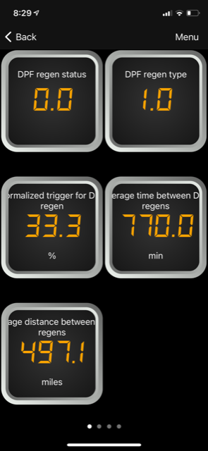

This is how I have my OBD Link set up. The Regen reading goes to 1 when in regen
