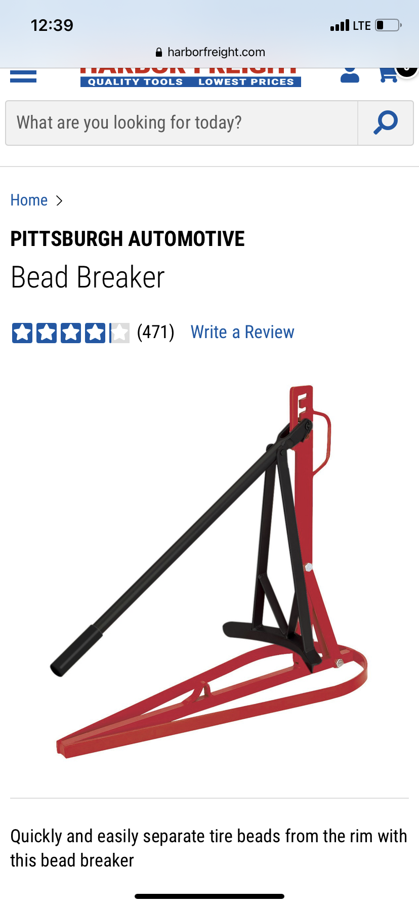

My truck has 18” rims. I actually just noticed that HF makes a stand alone bead breaker in addition to the tire changing tool.
