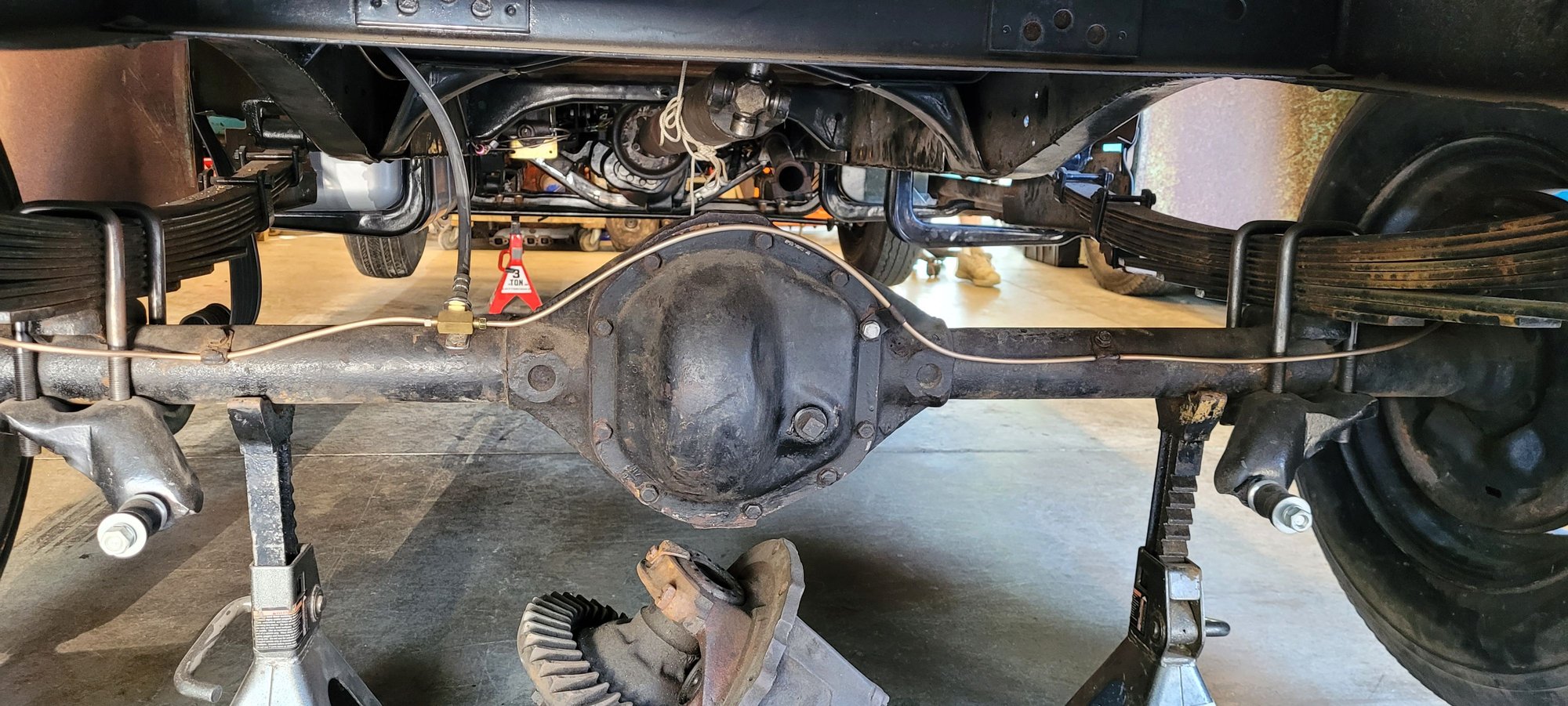

Here are some pics of the rear end. I'm pretty sure it's a stock '56 rear end.

The rear end does look to be a stock dana 44 for 53-56

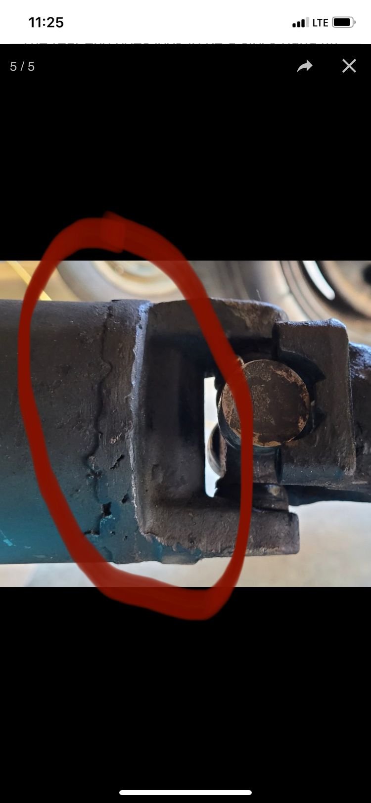

Here are some more pictures. As you can see the universal joint bearings are not fully seated in the mount, even when the driveshaft is fully extended. Those pictures are of each of the ends.

No way that's a factory weld. This shaft has been shortened

That booger weld was the first thing I also noticed, somebody butchered that drive shaft.

I think you both are right. It's definitely been modified. Anyone have a stock driveshaft with a slip yoke near the Cincinnati area? If not, I'll shop around and see if I can find a shop to lengthen it for less than my previous quote of $300. Thanks for the help.
