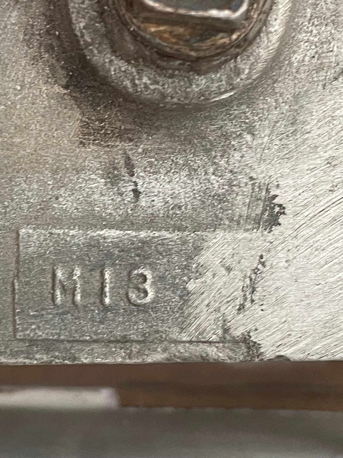

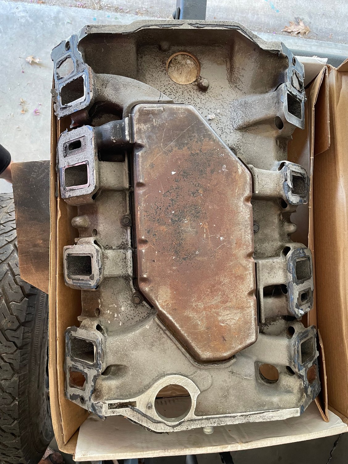

Trying to find out what intake this is, but can’t really find any numbers on it. Anyone have any ideas? Trying to use this on a Ford 360 possibly. Thank you!

Might be worth something as it's a pre-65 manifold.
More FE intake info:
https://www.diyford.com/ford-fe-engi...ltimate-guide/
Inspect it carefully. Note the oil fill pipe area seems to be a vulnerable area.

A lot of the early FE aluminum intakes didn't have casting numbers. Early 390 or possibly a low riser 427. Likely a C3AE-9424-E. Date coded December 1, 1963

I'd measure it to determine origin:
https://www.carmemories.com/ford-eng...nifold-id.html

'61/'62 390HP intake

I ran one of those for years until the exhaust cross over burned through, they seem very thin in that area under the steel splash cover.
