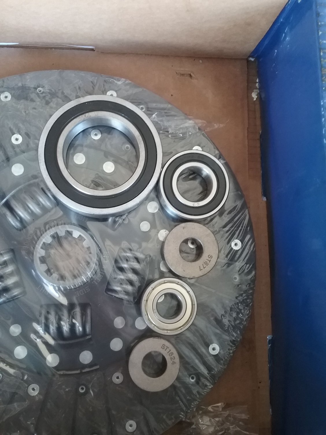

Here's the clutch kit I used on my T98 in my F350. $200 at Autozone with lifetime warranty. New bearings and pressure plate included.

Nice. That's the sort of information I can use. Thank you.
