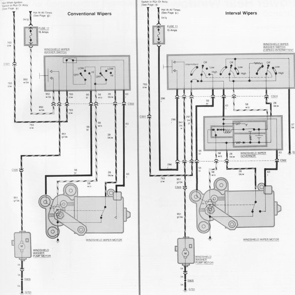

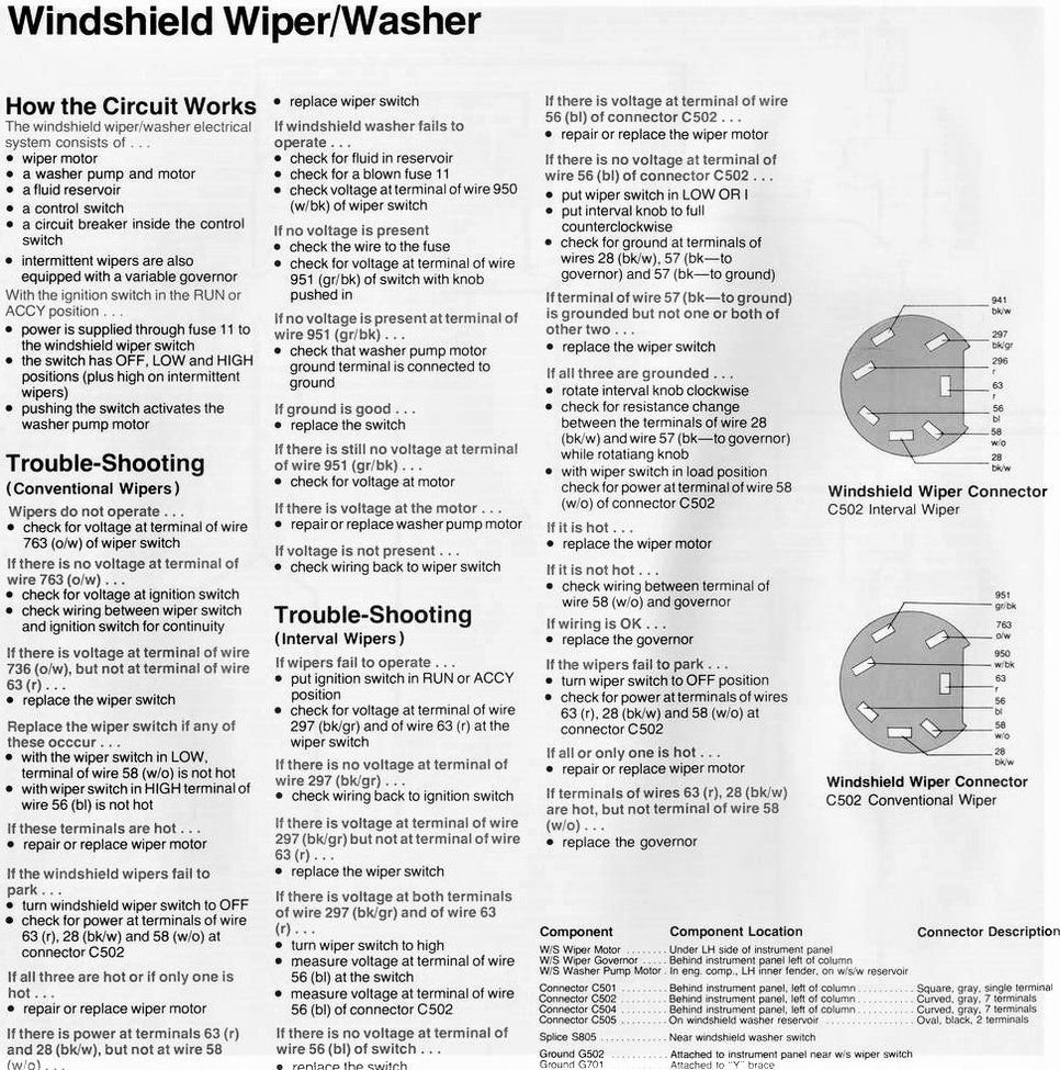

Remember you need a delay switch or at different w/s wiper switch when you put in the delay box. It will have a long sweep like adjustable delay ability. The ever elusive intermittent wiper control box and the splice wire # is. D3TZ-17C476-A (replaced D1ZZ-17C476-A) Intermittent Wiper Governor.

There are TWO different intermittent wiper governors. 1973/77 is one type, 1978/79 is another.
D3TZ-17C476-A(replaced D1ZZ-17C476-A) Intermittent Wiper Governor / Obsolete
