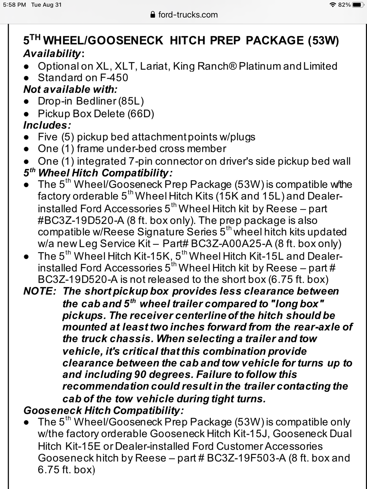

I'm wondering if it has anything to do with the 5th wheel package we got with the truck to save the transmission.

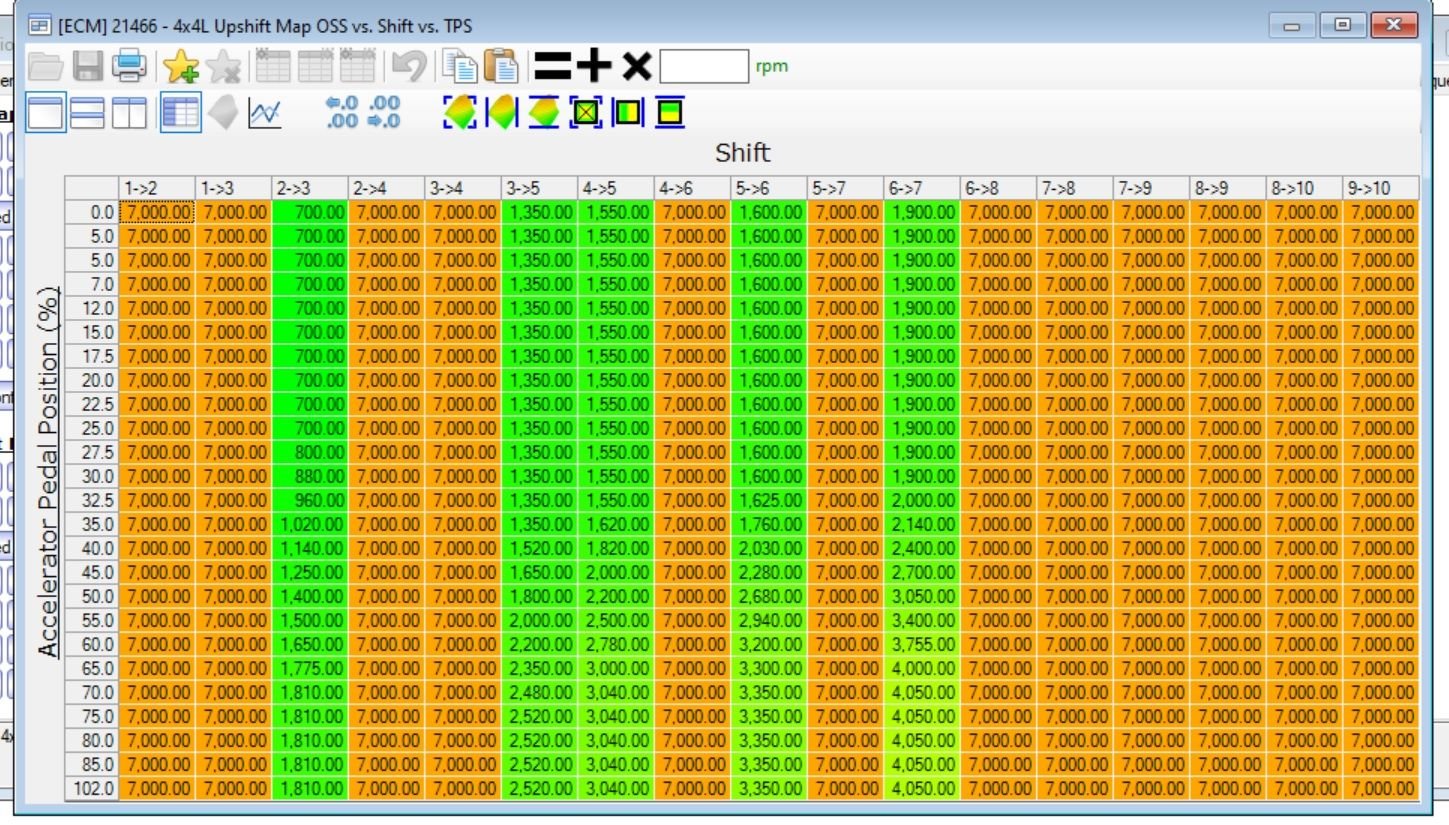

Sound normal you have more than 2 gears here is Fords stock 4x4 low shift pattern from a 2020 based on output shaft speed , they start them in 2nd gear and the higher output speed is then it will shift

Jeff,
My understanding is the fifth wheel package includes mechanical bits (extra frame brace, pucks) and the in-bed trailer connector. I’ve not heard on any drive train “adjustments”.
