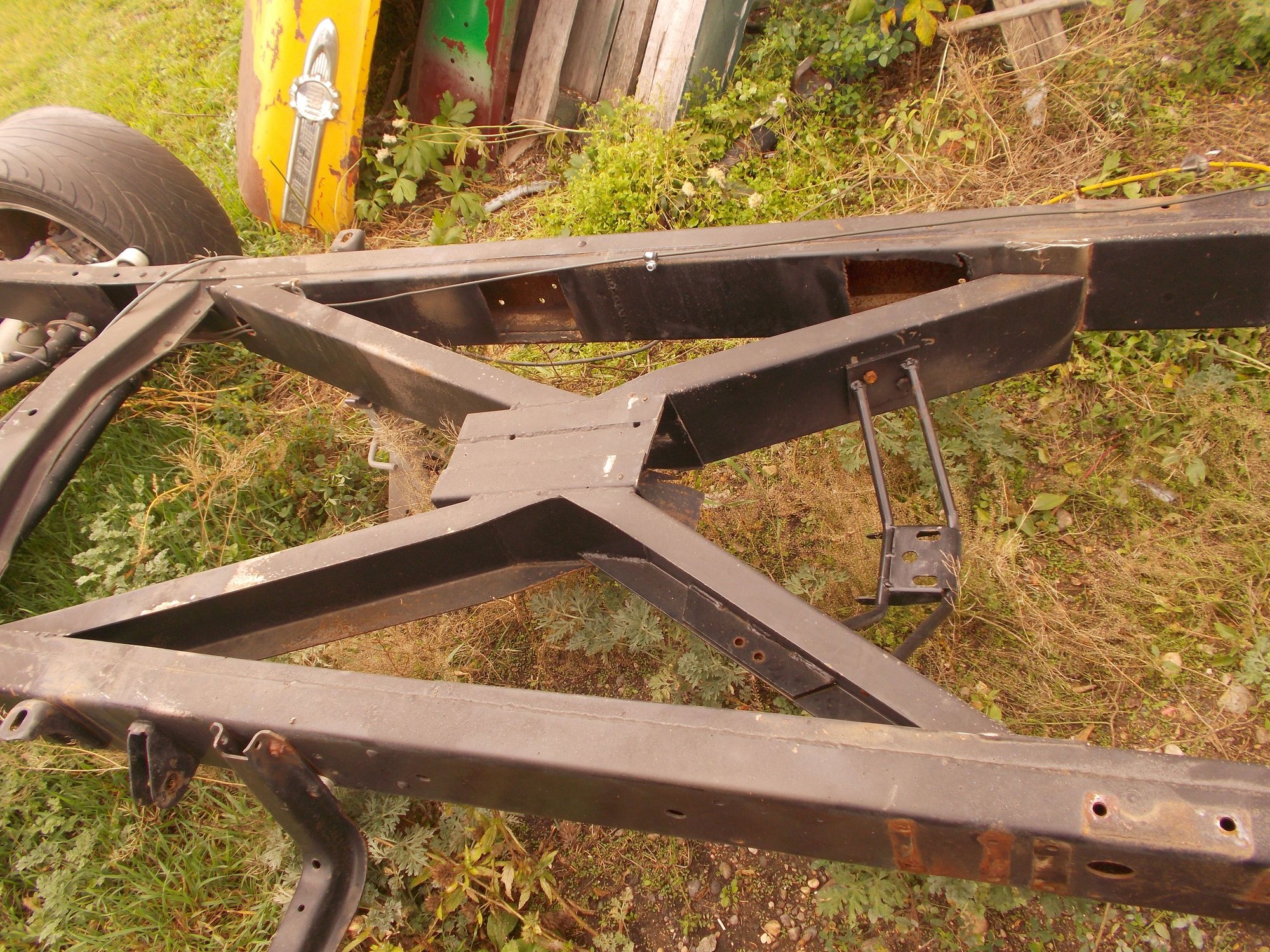

Did you put an x-member in? I got the boxing plates made. Well most of them at least. The trans support was removed when i got it. So I am coming to the point where I need to decide if I put in a x member. Did you put one in? If so any pictures?

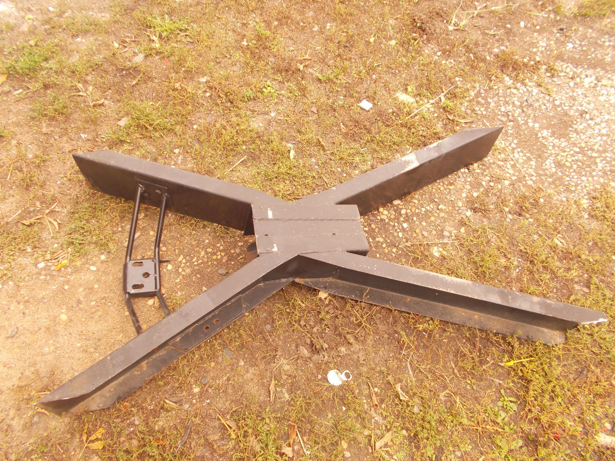

I have removed the po's incredibly heavy and pia x member in favor of one ( yet to be made ) similar to this .

If you are asking me, no I did not. The only cross member I put in was a removable one for a trans mount.
