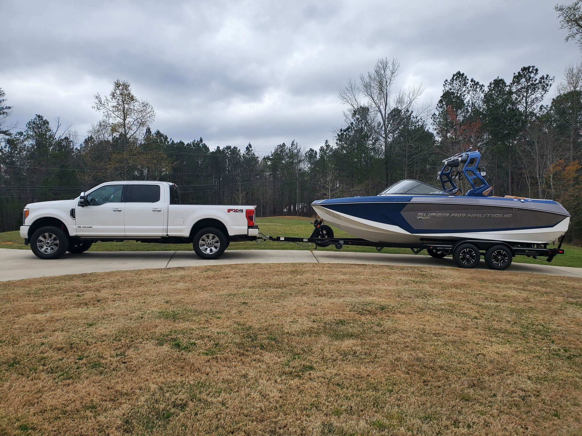

Not related to oil life, but your avatar looks like you've got way too much tongue weight. Might need to change the trailer rollers and such to shift the boat further aft.
Its my driveway. The front of the truck area starts going up a hill. Here it is same day but top of the driveway.

Gotcha' ... Sorry to badger you.
