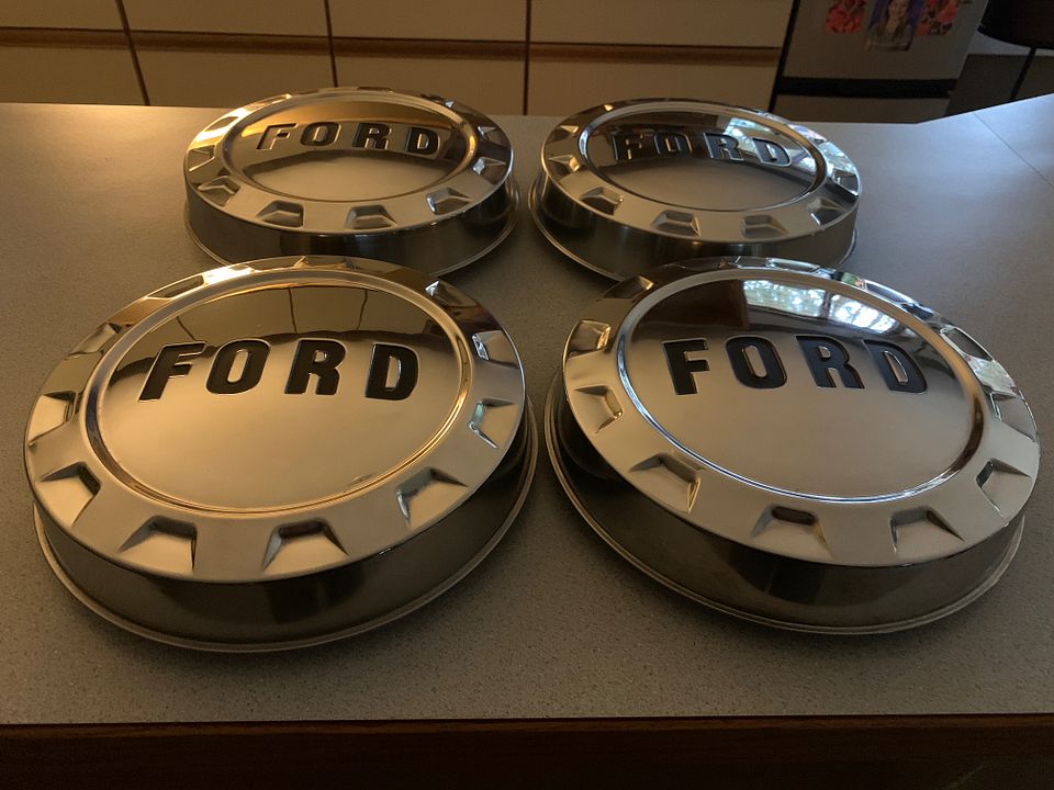

So this style? This is a Type 1 "innie" bottlecap so I assume so, painted versus stainless but is that the overall type? If so I don't know of this Type 1 in the "outie" retention method.

Yes, those kind! I had some exactly like that, but I didn't notice a couple years ago I had two different types of wheels. I didn't even know there were two different Ford steel wheels. The ones I had though fit the outie wheels. So I could get two of these and two of the outie hubcaps if I could find them.

They are reproduced. Mac’s Auto Parts has them, and probably all of the usual suspects. You will have to paint the letters yourself.

I couldn't find them there. Those also look like they're deeper than the ones I had that fit the outie wheels.

Chad’s are for an F250, I think, both taller and wider than the ones used on F100’s.
https://www.macsautoparts.com/ford-p...xoC038QAvD_BwE
Edit: None of that style is designed to fit an “outie” wheel, that I am aware of.
100% Correct. Those are the ones you found on eBay for me some time ago if you recall them. Lol.

Thanks for the link. The ones I had fit outie wheels and I got them from NPD, but I returned them when I realized I had two different types of wheels. I didn't realize because when I started driving it, I just slapped some 55 Thunderbird hubcaps on it my Dad gave me.
