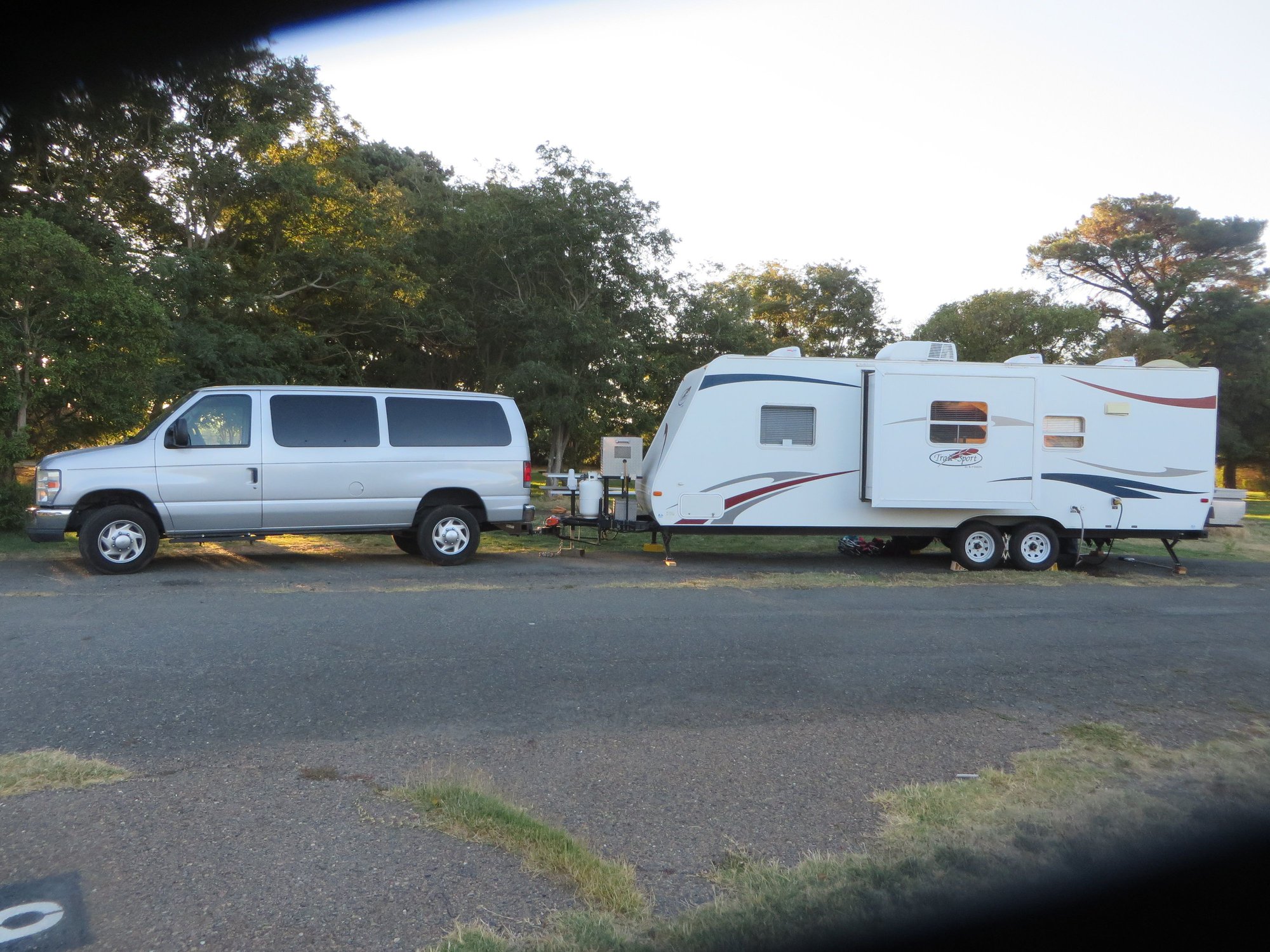

With my '10 e350 with 3.4l, 3.70 I tow a 28', approximately 6k lbs with a Hensley WD hitch without any problems. Highest towed was 7k ft elevation for camping. Probably can but I wouldn't tow any longer or heavier trailer.
