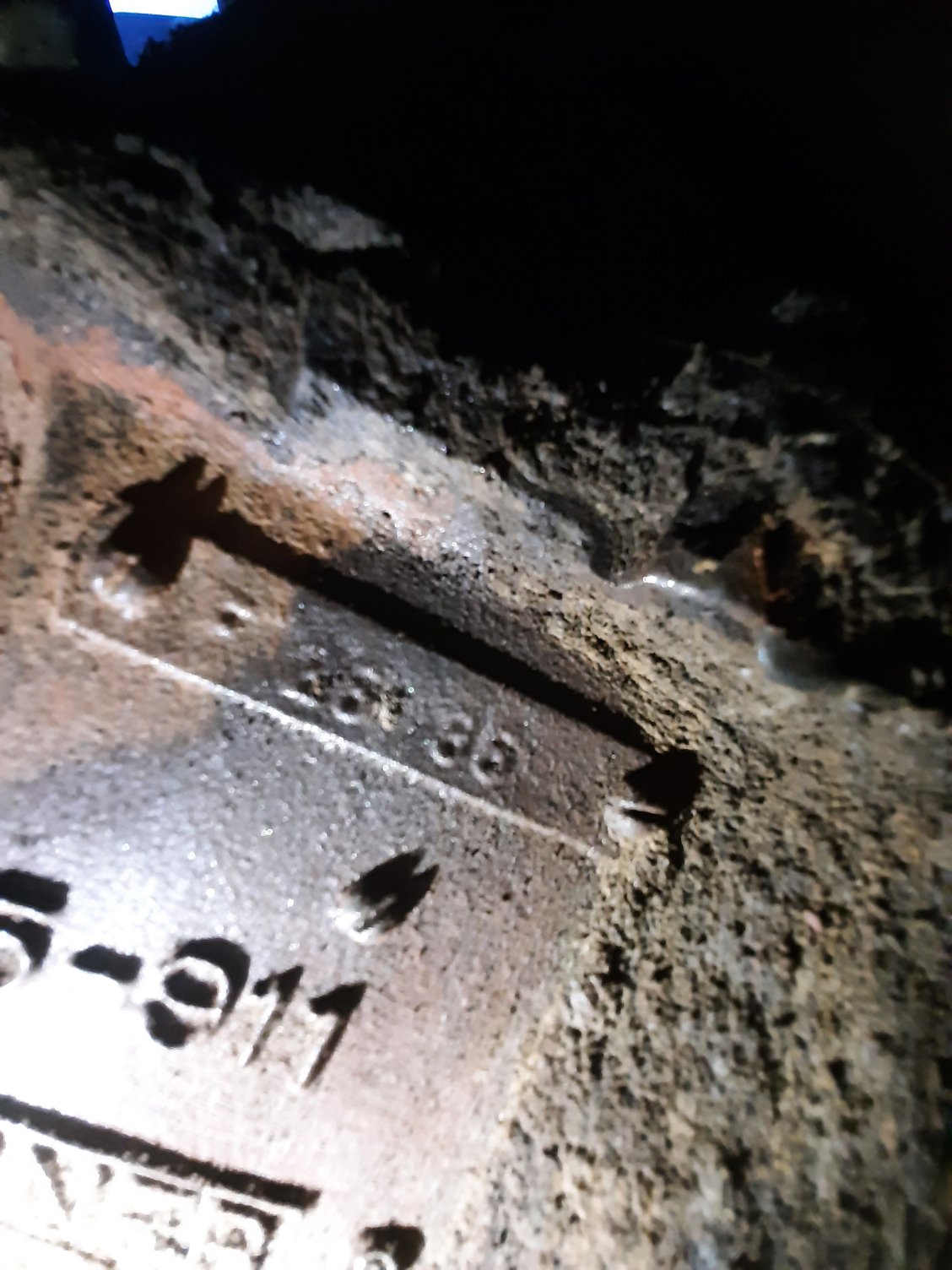

So right to the thick of it, I have no idea what transmission I have, there 2 trucks and I assumed they had the same transmission. One is a 1982 f250, factory auto, converted to manual, then engine is also stamped 83. The second is an 86 6.9, looks to be original transmission. Now through reading alone I have a t18, but, there different between the 2 of them. I have pictures of the transmissions and and gasoline engine but these numbers mean nothing to me and I can't seam to find the right search on Google to actually "decode?" these numbers.
First picture will be the gas engine, second and third pictures will be the transmission that was mated to the gas engine and the forth and fifth pictures will be the transmission that was mated to the diesel engine.
there is also a small tag on one of the bolts on the back of the t18 or t19 transmission from the diesel, I took about 6 pictures to read all the numbers if there needed I can post them.

I thought the T-18 was a gas 4spd and the T-19 was a diesel 4spd? Of course the other is the NP435.
What do the shifter sticks look like? The NP435 stick is the real curvy one. The others are longer and straighter.

Yes, the shifter arm is very curvy, doubling back on its self twice, smacks the dash in first almost, kinda thought it wasnt right. The transmission in the diesel is one, red (where the other one is just the metal grey) and two fairly straight with a single curve in it. Fits very nicely in the truck lol.
As far as gas or diesel i don't know, I've read and heard the major differences is just the synchro first gear in the t19, and some different gear ratios. But as to which came in a diesel and which didn't I'm not knowledgeable with that, and remember the 82 gas was originally an auto, could that be why they put the NP435 and not a t18 or t19? Because it would fit where the others wouldn't?

This transmission:
https://cimg3.ibsrv.net/gimg/www.for...0913841aa8.jpg
Looks to be an NP435. The number cast into it, C13894, appears clearly in other pictures here on FTE. The top cover should be aluminum.
This transmission:
https://cimg6.ibsrv.net/gimg/www.for...9761727888.jpg
Looks to be a T19. All synchro. First might be 4.02 (from diesel) or 5.11 (from 460 gas).
https://www.novak-adapt.com/knowledg...anual/t18-t19/
https://www.ford-trucks.com/forums/4...and-t18-s.html
Shifters come straight and are bent to fit when you buy replacements. Factory bends---might vary by year and model.
Usually you can bolt in any one of those as a replacement for the other.
