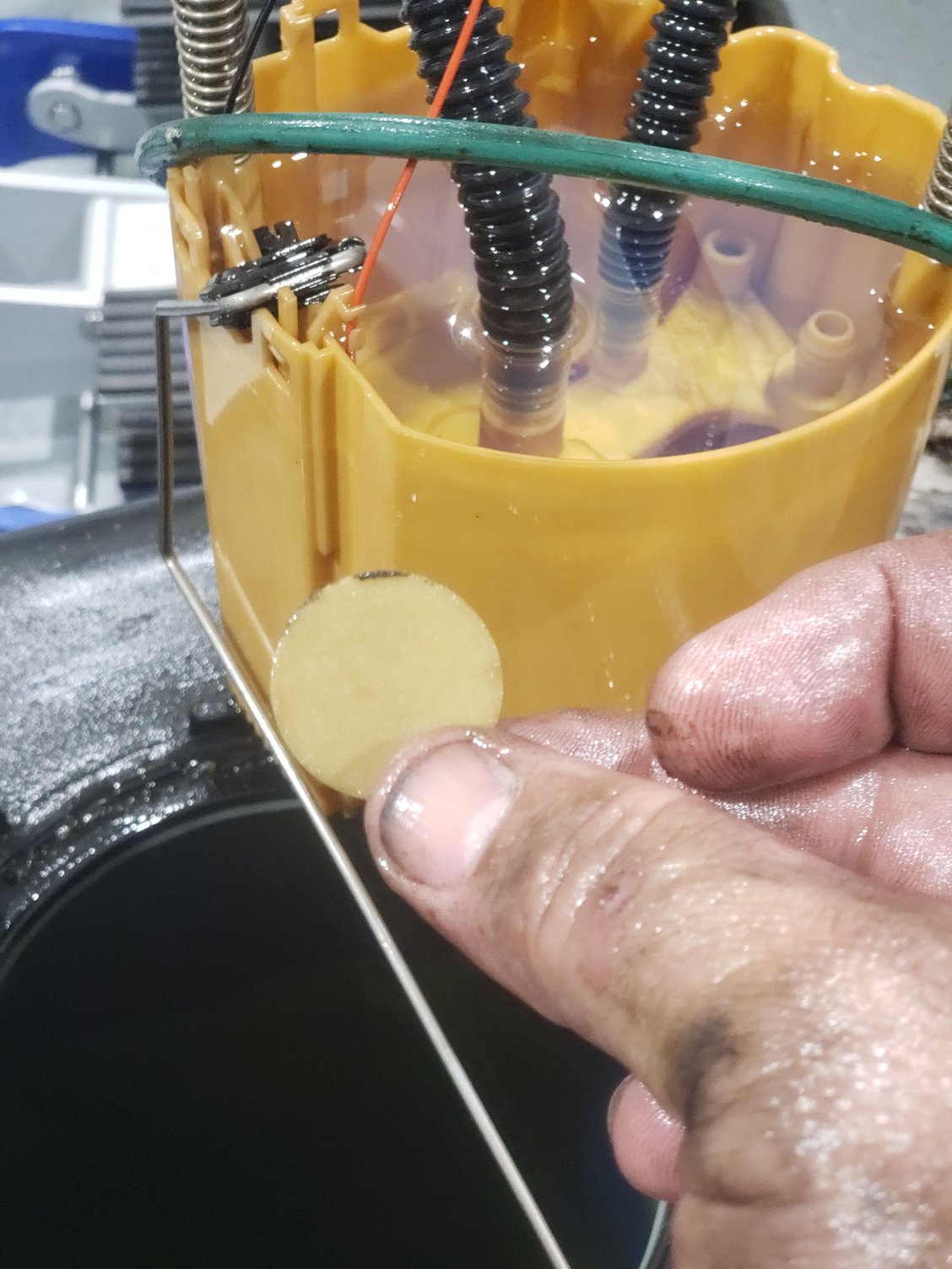

Pulled the tank!!!!

yup...now how did that get there.

Good for you……..cheap fix, but definitely a PITA!
