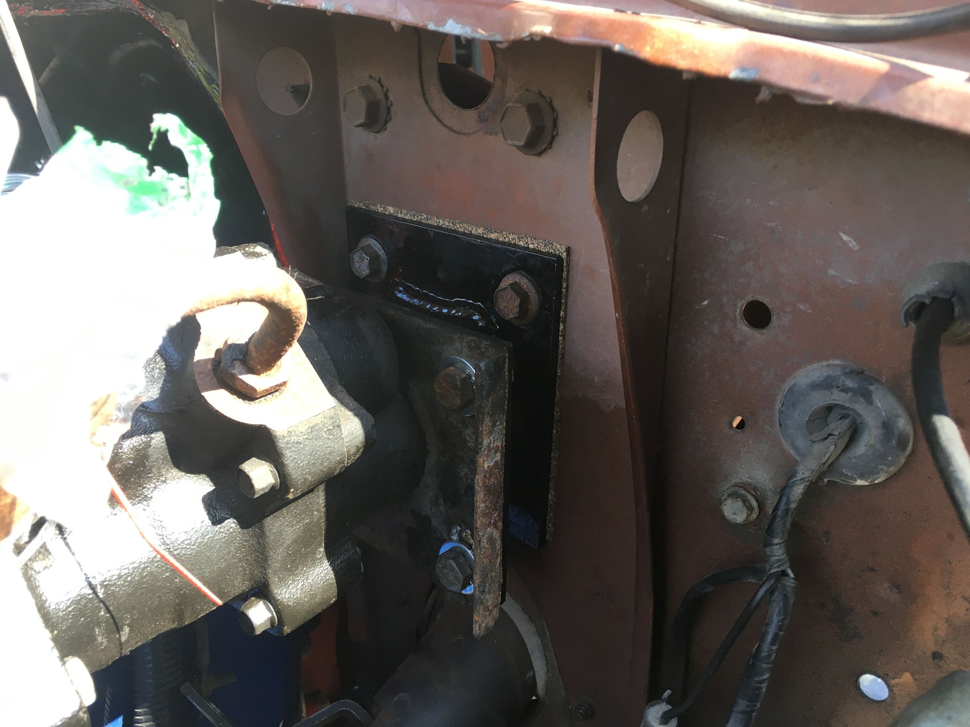

I haven't been getting much progress done lately. I shortened up the stock Superduty lower steering shaft just to make sure that I could. I need to switch to one that has a u joint on each end rather than a rag joint on one just because of the slight angle at the box. I also had a friend spin me a bushing on the lathe so that I could use a standard sized bearing in the bottom of the steering column and I welded that bushing into the column. I also welded the bottom of the Superduty steering shaft on the 77 steering shaft so that I could use the Superduty lower shaft.
I have been battling the rad support recently. I am very pleased with how it is turning out so far but it has been a heck of a chore to modify it in such a way that I can stack all of these rads in here, everything is mounting using the factory mounts so any parts replacement in the future will be easy.. I still need to mount the trans cooler and AC condenser. The trans cooler is going to be straight forward but I have run out of room behind the grille after that for the condenser. I am unsure whether I could find one that is shorter and thicker. The way the grille curves in at the bottom is messing things up for me. EDIT. I did a quick mock up with the grille on to see just how tight things are in there and the picture is not much good but it is way too tight to even dream of getting the condenser up there.

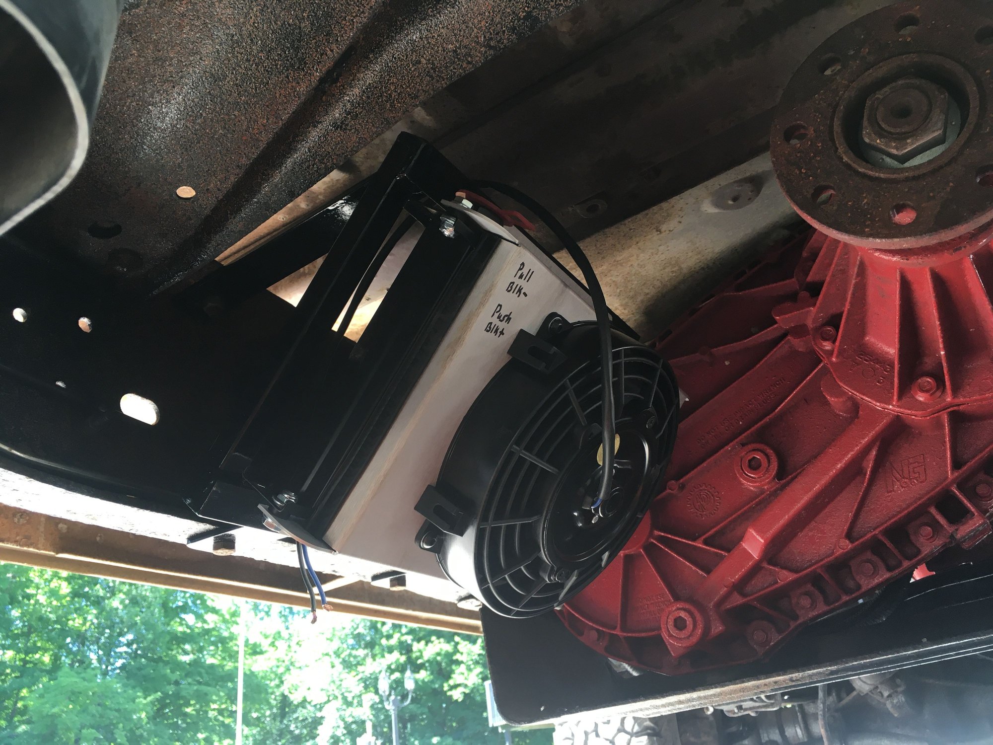

I have come up with a plan for my dilemma up front with the space available for the rads. There is a Canadian on YouTube, Deboss Garage that I try to watch when I've got time, long story short is he is building an OBS with a 3126 CAT in it. He didn't have room enough up front for all of his coolers either and used an auxiliary trans cooler mounted under the box with a fan on it. Seems like the best course of action for me as well. Disappointing only because I now have a $300 trans cooler that is useless to me and I've had it too long to send back.

A little update. I have been buttoning some things up. The intercooler pipes are back and installed, I have extended the tube for the upper rad hose and got it hooked up. Brake lines are all run and mostly tidied up. I have new pads and rotors all around. The interior soundproofing on the floor is done with a new rubber floor and the seat back in. I have got the transmission cooler installed and just waiting for some fittings to get the hoses run. The box that houses the PCM and IDM is finished and mounted. I am finishing up the gooseneck hitch in the back now and then I can mount the brake line to it and be done everything back there.

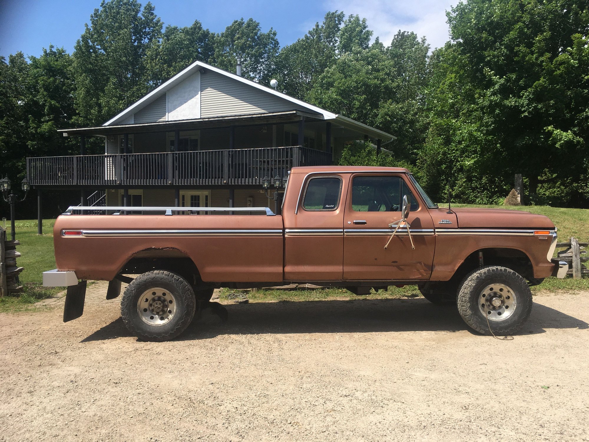

Beyond that I have most of the big parts all sorted out. The truck is all bolted back together, the hood latch is in and the rad support is finished up with the condenser installed. She's all pretty tight behind the grille and will need slight trimming once the AC lines are run. I got the rear bumper I built for my 72 modified and bolted up. I finally decided on a position to mount the front bumper that I can live with. The frame rails stick too far out the front of the truck to tuck the bumper up where it would sit stock so I held it out about 6 inches and will build a fill plate in behind it.
Some pictures of how she sits. I love the looks of this rig.
