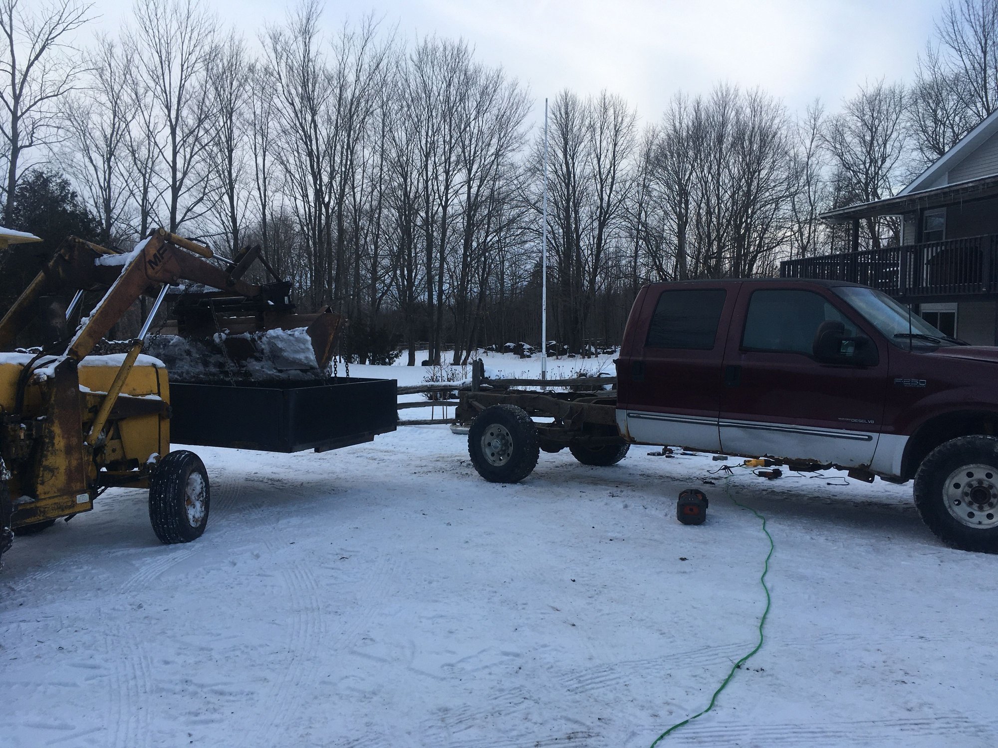

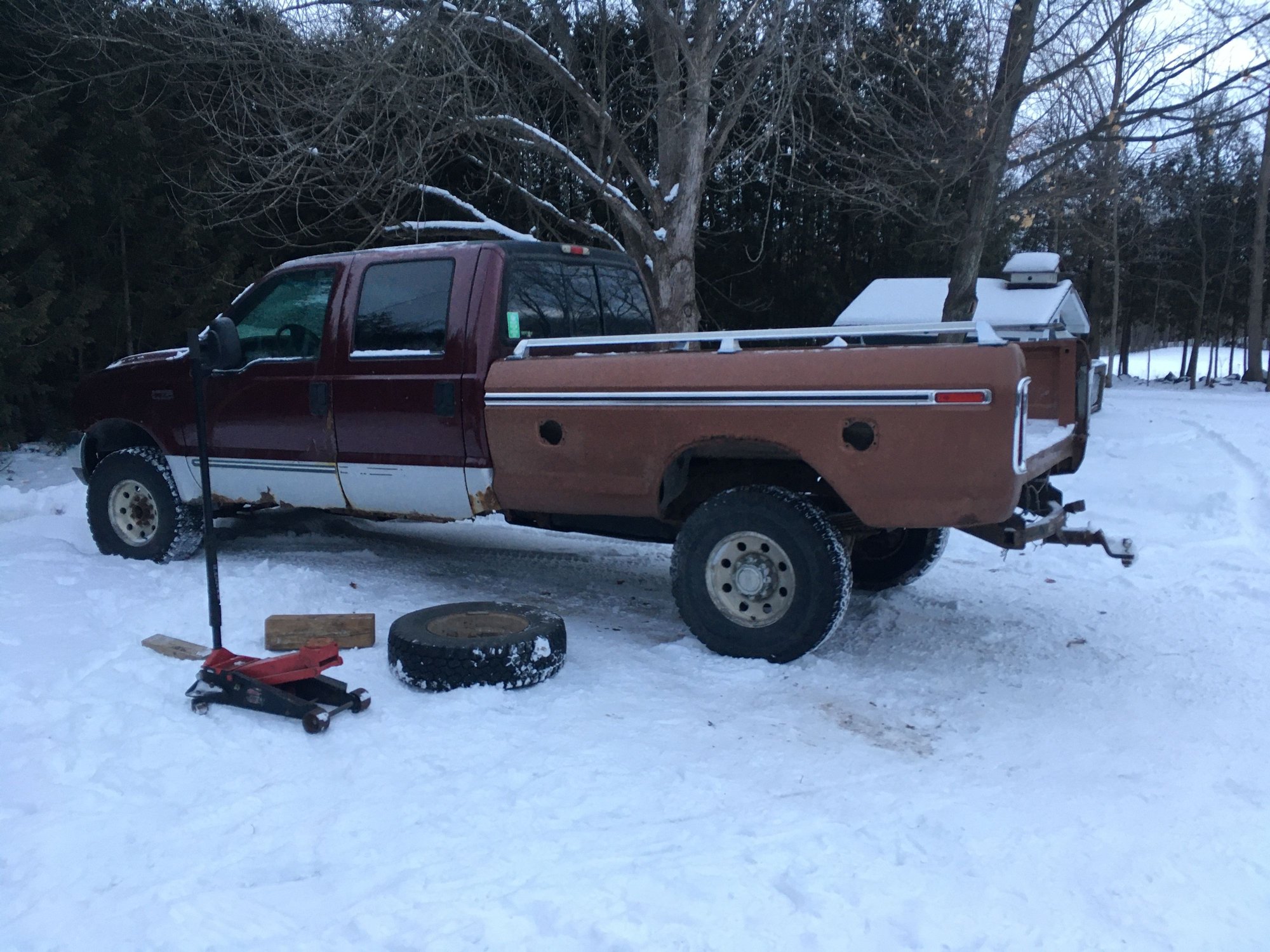

I got around to a little bit of work here the other day.It's been -20 with a nice wind chill but I am excited to start doing something on this project. I got the box yanked off of both trucks and put the 77 box onto the new frame. 4 of the 8 bolt holes lined up perfectly. I had to weld some tabs on the frame at the front since the foremost mounts are narrower than the rest. The fuel fill is in the perfect spot to line up with the forward door in the box. Today I'm going to drill the rest of the holes and then yank this box back off before I smash it up pushing it around with the tractor. This truck is going to have the perfect stance when it's done I think, measurements show that the floor and box rails are the exact same height as my stock 1 ton but the lack of sheetmetal on the sides makes it look like it's got a nice lift on it. Next step is to yank the cab and chop the frame. I am a little hesitant to do this now because I want to keep it driveable to move it around easily and I want to keep the motor covered. We will see. I will probably end up pulling the cab, motor trans and everything else to make it easier when I do shorten the frame. To set the cab and weld up the mounts I am going to have to trailer everything 45 minutes away to my father in laws where he has a hoist and I don't want to do that until some of the salt and slop is off of the roads.

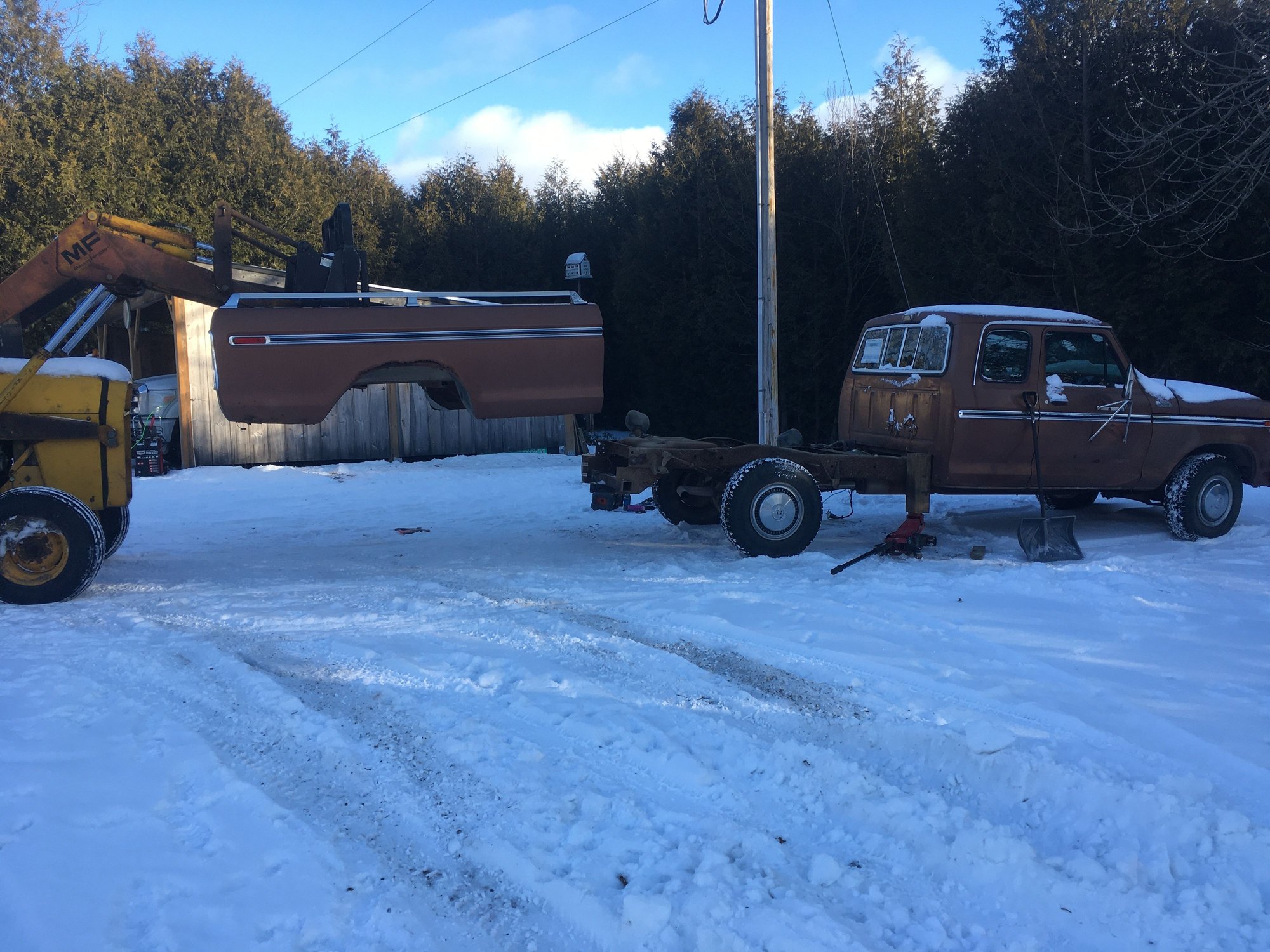

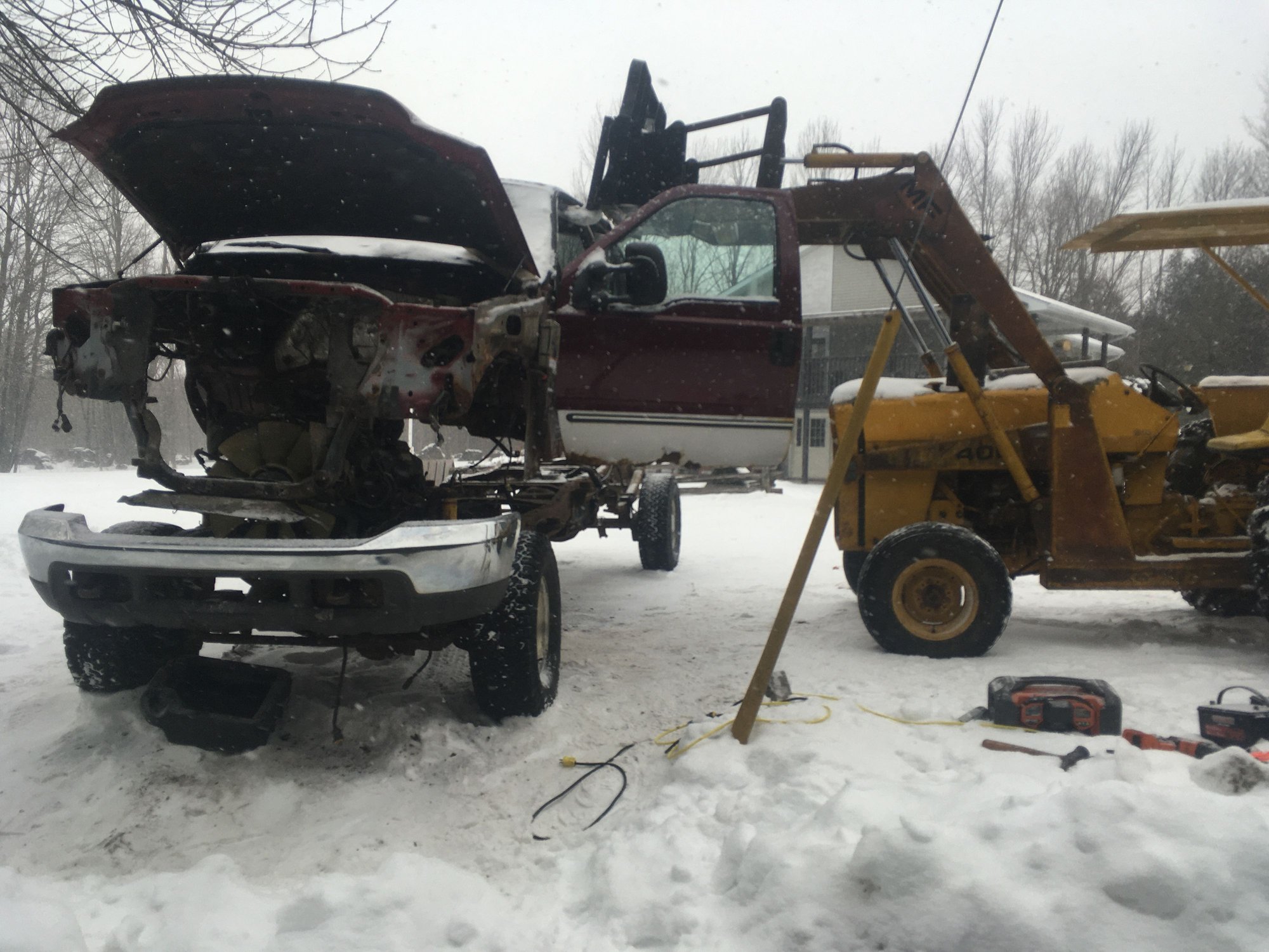

Well as it turned out today was a beautiful day, only about -14 and fairly sunny for the most part. I decided I was going to yank this cab and get on with this project. I spun most of the body mount bolts out yesterday save for the two rad mounts so today with the help of the dog I got everything disconnected and pulled it off with the tractor. Surprisingly enough I didn't forget to disconnect anything and it came off easy as can be. Hopefully in the coming days I'll get a chance to chop it up and shorten it. maybe next weekend I can mount the 77 cab.

Nobody seems overly excited about this build but I have started and I will continue updating it as I go. I pulled the motor out of the frame today after I got home from work and tomorrow hopefully I'll get home early and start chopping up the frame to get it the right length for the Supercab. I need to pull the fuel lines and chop off the cab mounts still.

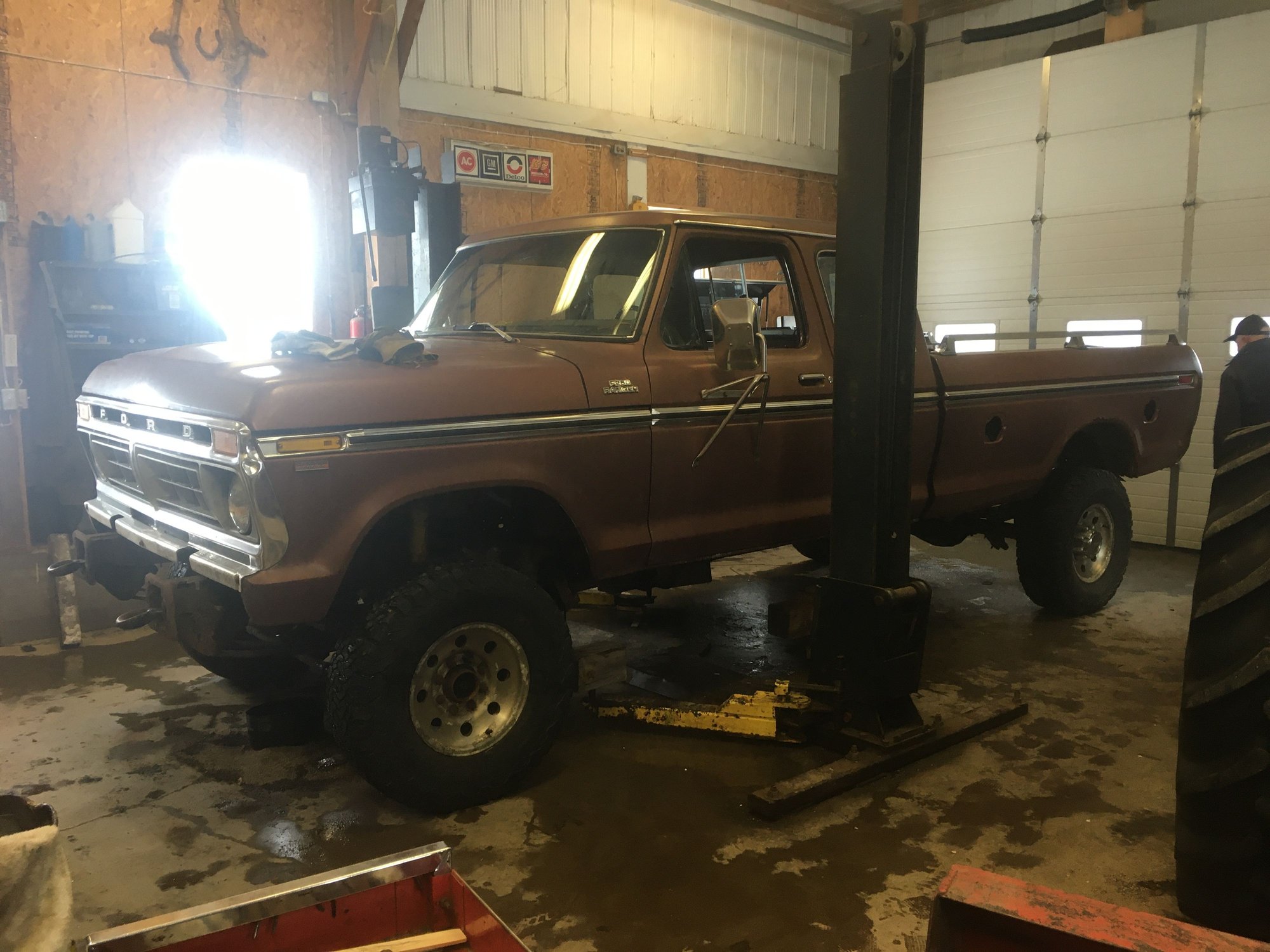

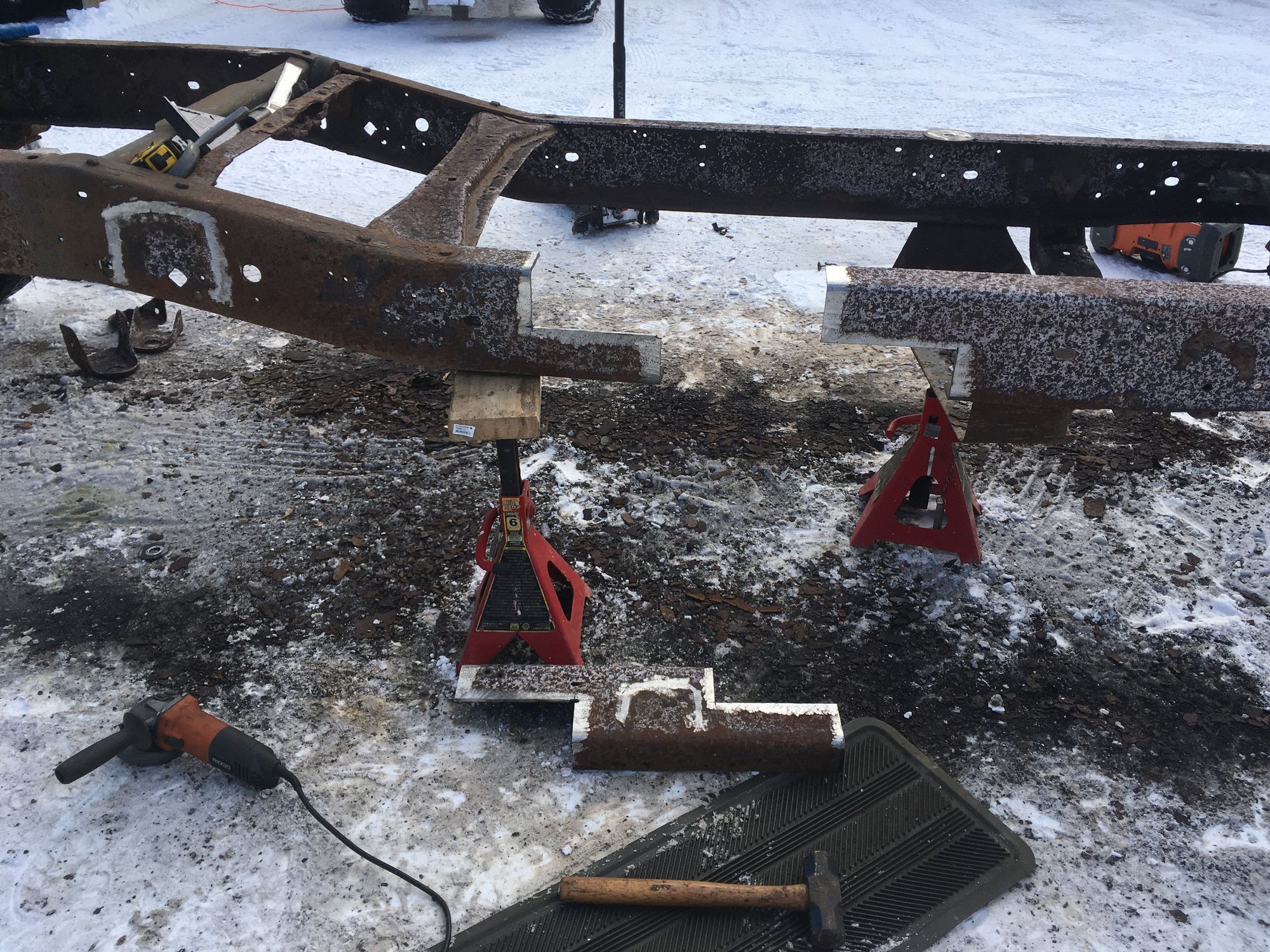

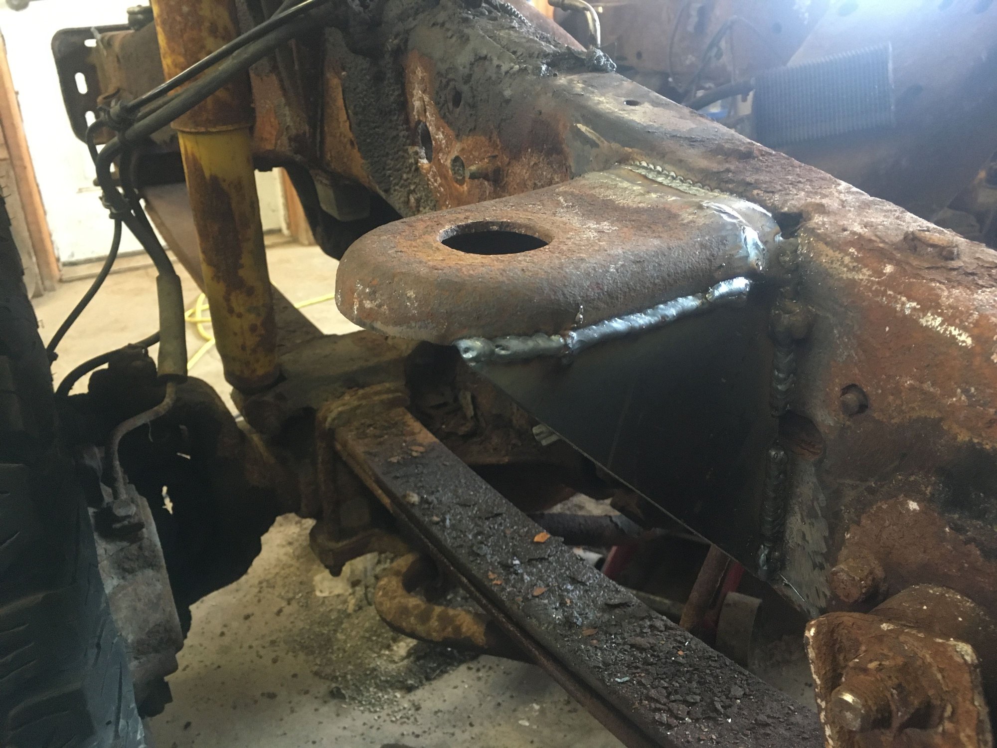

Well finally some exciting progress to look at. I got the frame shortened up, a fancy fishplate on the outside of it. When the frame gets sandblasted I'll weld one on the inside too, just too hard to grind it nice and clean in there with all the rust and stuff. I trucked all the bits over to my father in laws and used his hoist to lift the body off of the 77 frame and set it down onto the 99 frame. I cut off and reused the rear cab mounts from the 99, just had to trim them a little. The fronts needed more material so instead of scabbing it in to the existing mount I just cut the plate off of the top and made my own "arms" for it, unfortunately I had to go over the rivets they had in there where they double layered the frame. To get the cab on there I had to shim the box up 3/4". When it was bolted straight to the frame the body lines would line up only when the rear crossmember on the cab was touching the frame. I figure 3/4" is plenty to avoid any contact due to squish in the body rubbers. I reused the 99 body rubbers. They looked to be in really good shape and I figure if they go bad then it would be easy to find mounts to replace them with so many still on the road today. She sits a little higher than I would have liked but I think when the motor goes back in it will drop 2" or so in the front which will be perfect. It is going to be interesting to try to build a bumper to cover up those frame horns. The springs mount to the very front of them so I figure I had best leave them how they are.

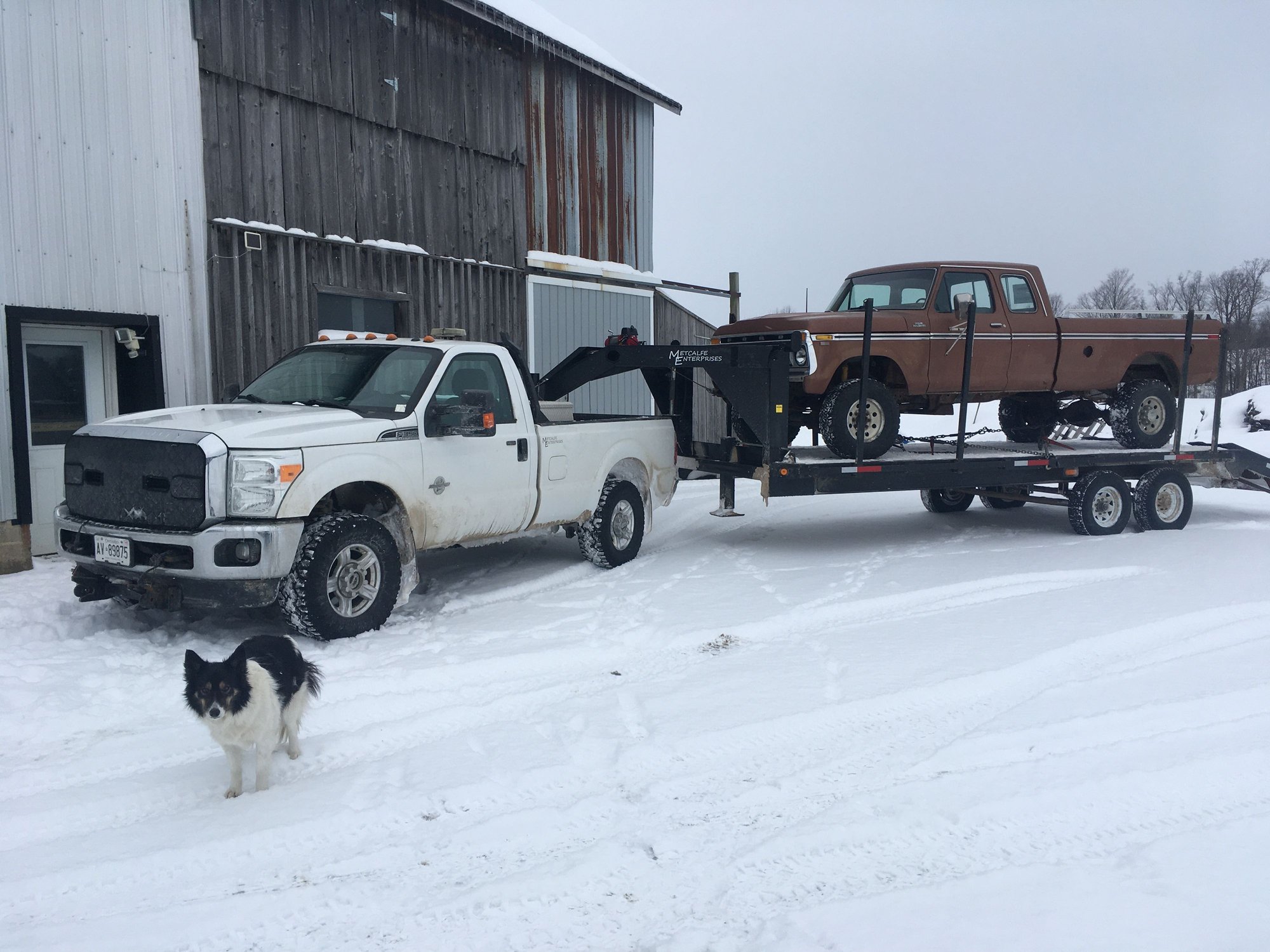

A picture from today. I got old Tumbleweed fired up and brought around. I stole the gooseneck hitch and the steering wheel out of it for this truck, I'm going to keep the rear bumper off of it too for this truck but will have to modify it some. Once I get a little closer to running and driving Tumbleweed will get sold
