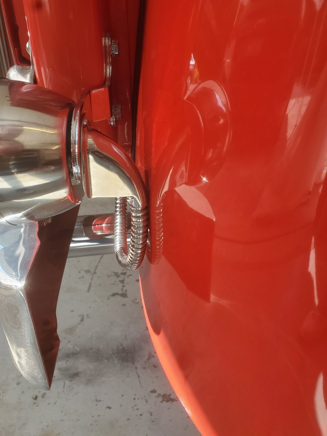

How much clearance should I have between light and fender? I might be able to move fender forward a litte.

You've got all the room there is to have. The problem I see, if I'm seeing it correctly, is your wire guard is supposed to be against the lamp body on the other side of the bracket. Relocating that will give you the clearance you're needing.

I will have take my air grinder to the bracket so the guard will raise up high enough to align with bolt holes. I did consider that option.

I took care of the issue with a little metal removal with the air grinder. Only one bracket had to be done.
