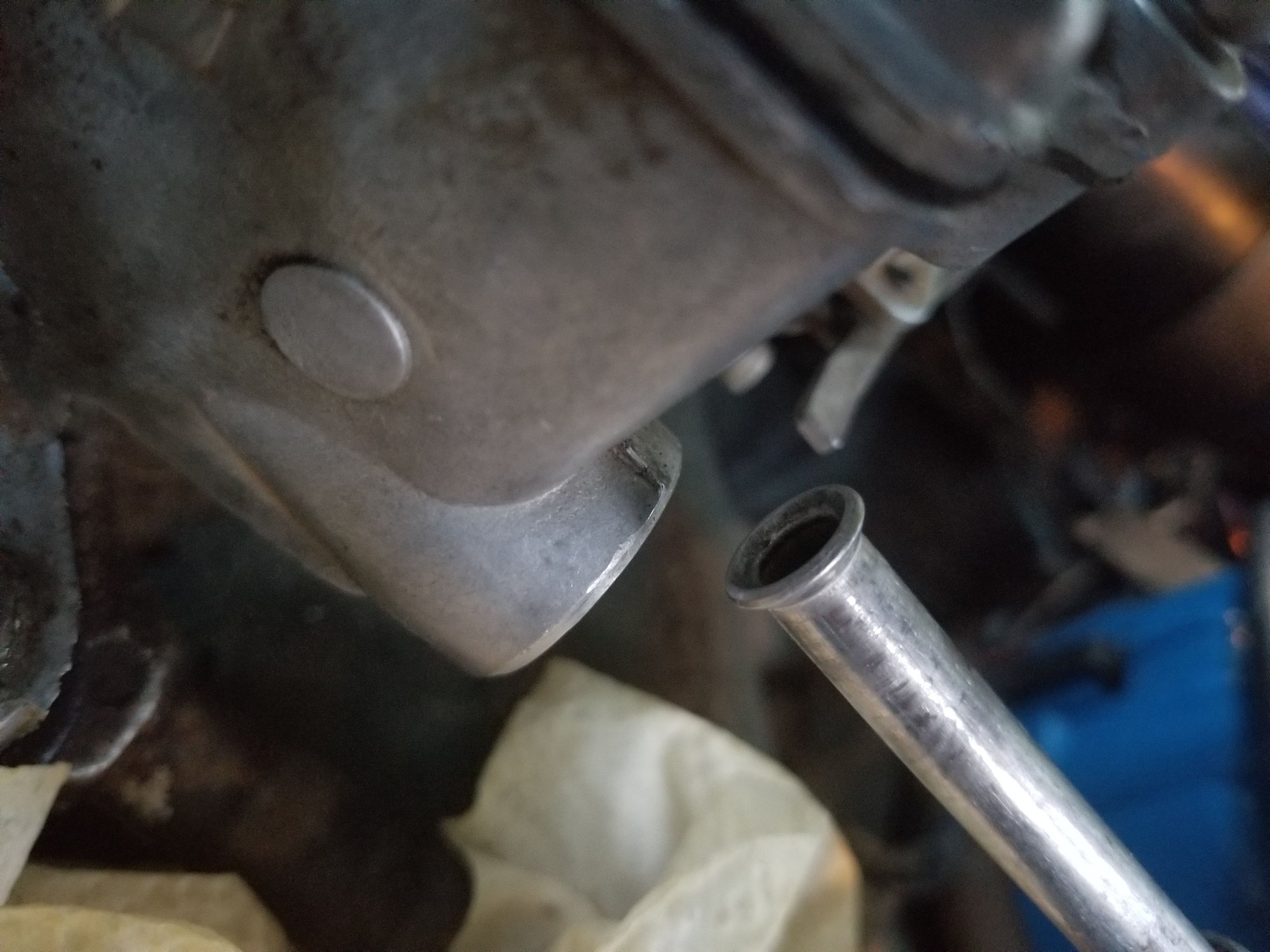

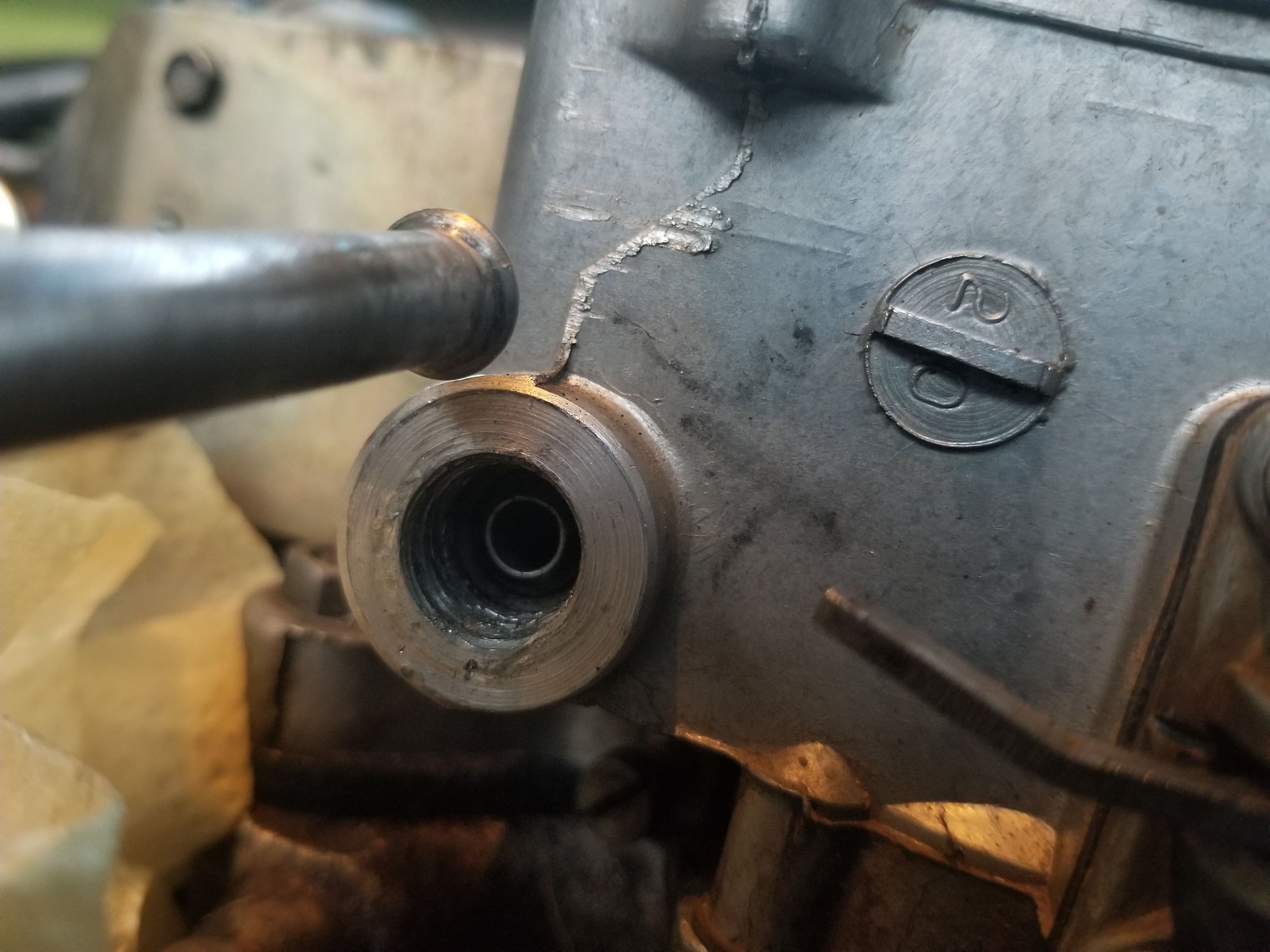

Looks like the inlet was put in at an angle and the threads stripped out....or the picture is very deceiving. Remove it and check the threads.

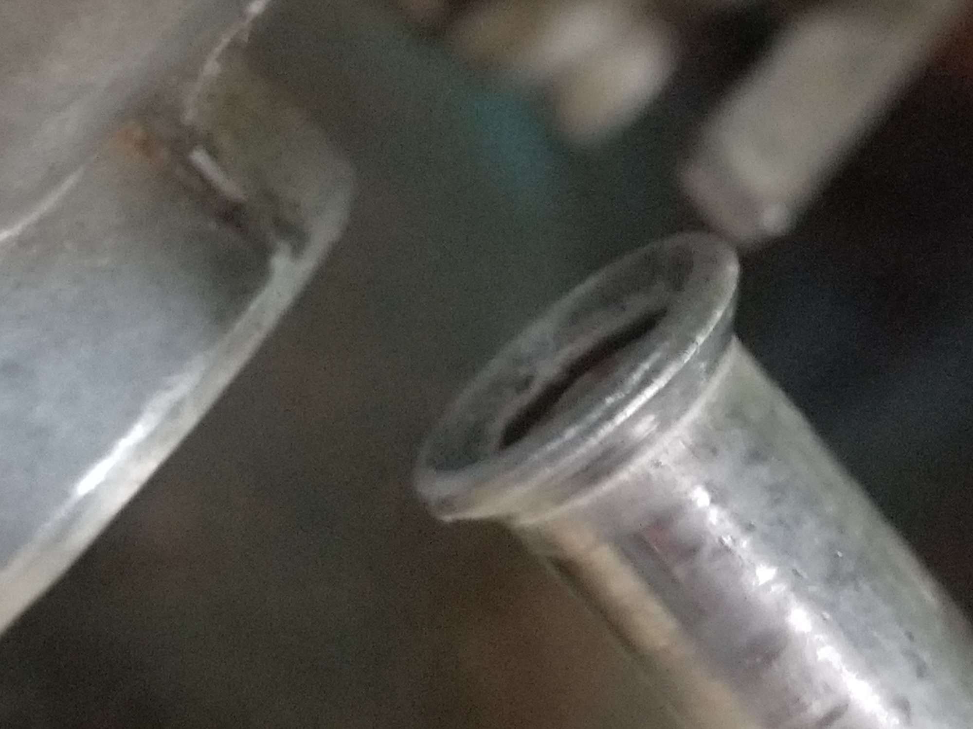

Here are some more shots of the fittings...
Would plumbers tape help if the threads are the culprit?
Old Sep 14, 2021 | 12:59 PM
  #33
Lahti35's Avatar
Lahti35
Joined: Aug 2014
Posts: 181
Likes: 58
Those threads look gnarly but mostly intact, the boss that the flare seats on looks good though... This is a common issue with old carbs. Don't JB Weld it, it's not fuel proof so they say, more importantly it's not removable.
I've got this same issue but worse on my 2100 and will be drilling it out and going to the next size threads with a brass male/female fitting. That way i'll be screwing/unscrewing fuel line from the brass fitting and not the soft carb body material. The flare fitting does the sealing, fuel should not be getting past it to the threads. Maybe clean the end of the fuel line with some scotchbrite pad work and make sure the corresponding carb side seat is clean. Be careful how much you tighten that fitting. I have seen carb thread repair inserts but have never used one...
Well hearing it's a common issue definitely makes me feel better. Thanks. I could swear I didn't feel like I was forcing anything into somewhere it didn't belong or anything. It didn't feel like I was cross threading anything. All went together really smoothly.
But I'll try the scotch brite and report back. No JB Weld - good tip thanks (I won't lie I had thought about it).
So this "flare fitting" on the fuel line just butts up against the opening on the carb and should not leak at all and the threads just hold this connection in place? It seems odd to me is all. Metal on metal and no gasket or anything to hold it in place other than this one threaded nut. But all right I'm game. Hopefully I can get it to connect back up right. Thanks!
