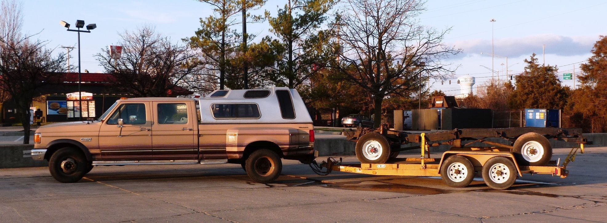

My 1987 F350 dually carburated non catalyst 460 with limited slip dana 70 rearend . Paid $2k and had 104,000 miles on her. Hauling home a 76' highboy chassis.
