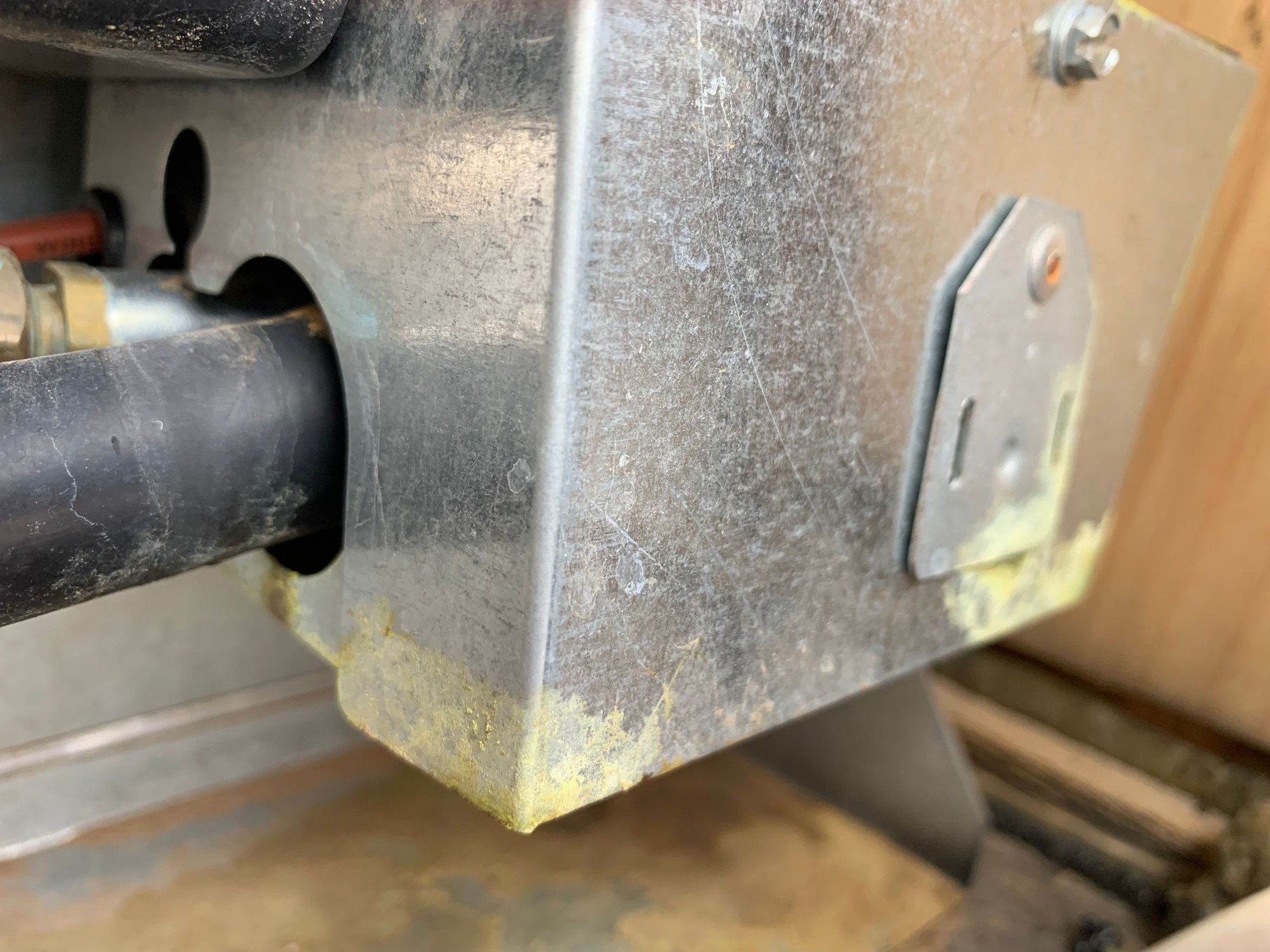

Good morning crew (Somewhat). Somewhat because I always keep a little extra ice in the freezer in the RV. Went to get some yesterday afternoon and all I had was a puddle of water in the bottom of the freezer section! Yup, fridge not working (It is level). Turn switch off for a bit, turn it back on, the green LED stays on for a few seconds, then blinks rapidly 5 times, then steady for a few seconds, blinks 5 times, rinse-repeat.
As far as I can dig, this indicates the circuit bosrd. Does anyone know how to test this for sure?

Forget the circuit board………I am screwed!
Copied from the norcold guy dot com
Make sure there is no yellow powder or residue on or near the cooling unit or any smell of ammonia. If either exist, your cooling unit has leaked ammonia and needs to be replaced.

Yup………late to the party. My model of fridge is one they discontinued (imagine that), so with a little research I found a brand new direct replacement cooling unit for my model. Replaced that, all is good now again.
I guess I should have updated my thread here so that everyone would know the issue was solved. Old guy forgot he had started this thred! LOL
Bought it from www.rvcoolingunitwarehouse.com The hype is that they are better than the Norcold unit and use better materials. Made in USA by the Amish. IDK. Seems heavier built. Time will tell.
