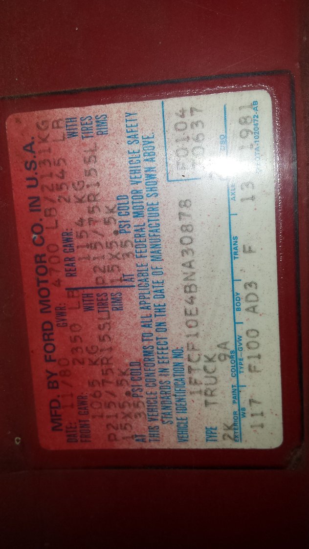

I just checked my 81 flare side 4x2 and if reading the sticker right the rear springs on mine are GARW 2545 and think it rides really nice.
Dave ----
