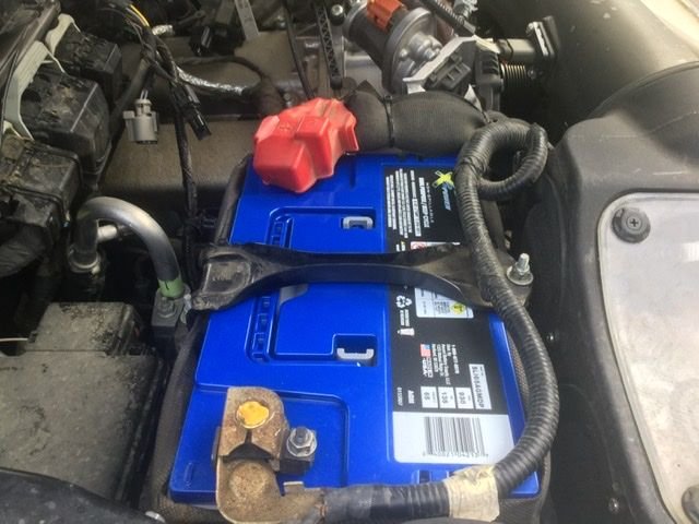

Originally Posted by ford390gashog
The BMS module reset will reset the battery age to zero. Might as well do it while you are there.
The bluetooth function on my laptop was down for awhile so I tried an alternative reset procedure. 5 flashes of the high beams, 3 presses of the brake pedal, something like that. I really don't know what it did other than making the bat light flash a couple times.
The Bluetooth started working on the laptop so I connected to Forscan and now have some questions. Where can the battery life be found? Just to verify the reset. Also, where are you making the change to AGM? Bellow is what I am seeing in the BCM.
