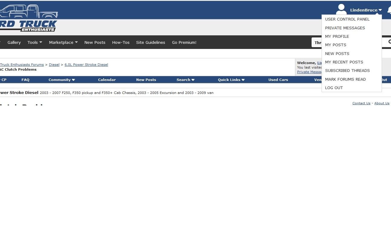

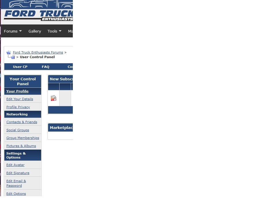

Go the very top the home page and look at the far top right. Left click on the down arrow next to your name and left click again on User Control Panel. That will take you to another page. On the left Side of that page look for Settings and Options and left click on Edit Signature. That will take you to another page where you can write up s signature. Have fun. B.
