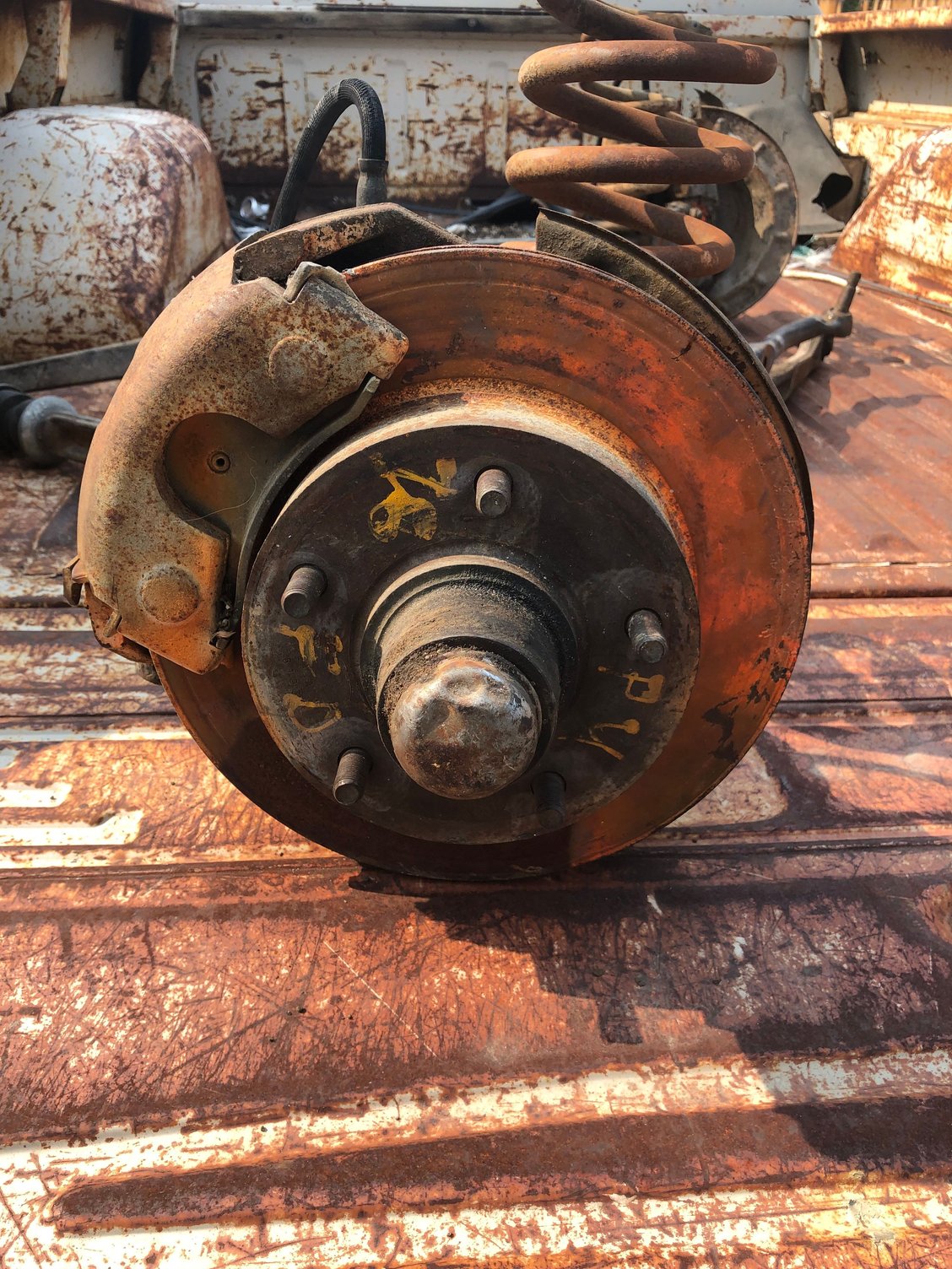

So I found the front suspension with disc brakes for an f100 at a swap meet and grabbed it. My truck currently has drum brakes up front and I want to swap it with the disc brakes from a newer truck. I plan to clean these up and rebuild the brakes and swap out the entire front suspension of my truck. My question is I want to replace the king pins while I have it out and I’m wondering if someone can help me determine what year truck the new suspension is out of. I know it’s between 73-79 but I assume the king pin is specific to the year? From looking at the dust shield I was guessing this is maybe 73-76. I heard the later 70s models had vents in the dust shields. Any help is appreciated.

What is the cast engineering ID numbers on the I-beams? That will give you a year range.
https://www.fordification.com/tech/Ibeamsspindles.htm

D2TA-8-DA
D2TA-9-DA

According to the article, I believe those are 73-74 beams and spindles so use those kingpins on the chart.
https://www.fordification.com/tech/s...variations.htm

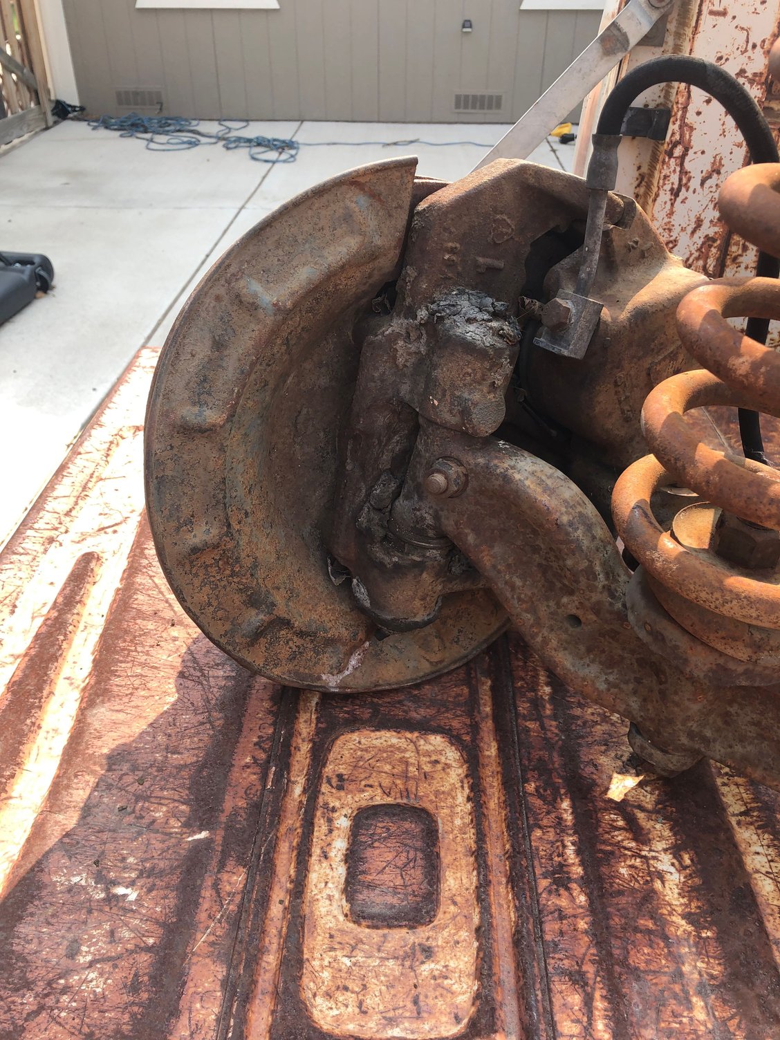

Looks like someone was doing cutting torch work on the axle.
