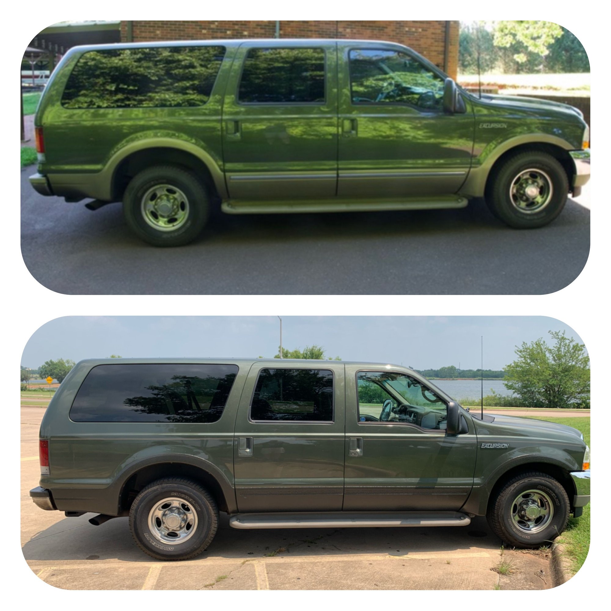

I believe I read somewhere that a 35” tire on an 18” rim provides optimal ride quality. If that a fact or opinion or just depends on a number of other variables?
My EX drives much better than I anticipated and I don’t have any problems with it myself. I’m attempting to improve where I can for the wife and kids (3 girls). I plan on keeping this vehicle for a long time and constantly improving various things.
As a personal aesthetic preference I would like to increase the wheel size to 18” or 20” to fit the large vehicle better. I was also hoping to raise a couple of inches.
Sorry for the long post, I’m excited. I know everyone loves pics. Top is when I bought last month, bottom is current after I had some rust repair done and the plastic trim bedlinered.

Welcome, I cant help you with the diesel but enjoy my 2WD so much my Tundra sits for weeks while I DD "Bertha". Just my two cents but I prefer a stock look and yours looks good.

I don't think your lift options for a RWD are as wide open as they are for the 4X4s and I'm pretty sure that 35"s won't fit on a stock RWD wagon. But I do agree on think that 35" rubber just looks "right" on these big wagons, mine is on 35"s and 18" wheels.

For 2wd, 285s will fit stock. Lift options are a 2 inch spacer to level it but a nightmare awaits you to align it without grinding the knuckle or a 6 inch lift also exists. *Cue the lifting a 2wd haters*
​​​I'm also in the camp of liking a good looking stock rig and I echo above that your X looks sharp. 87k mi is one hell of a find. If you're after filling the wheel wells more here's an option without touching the suspension...

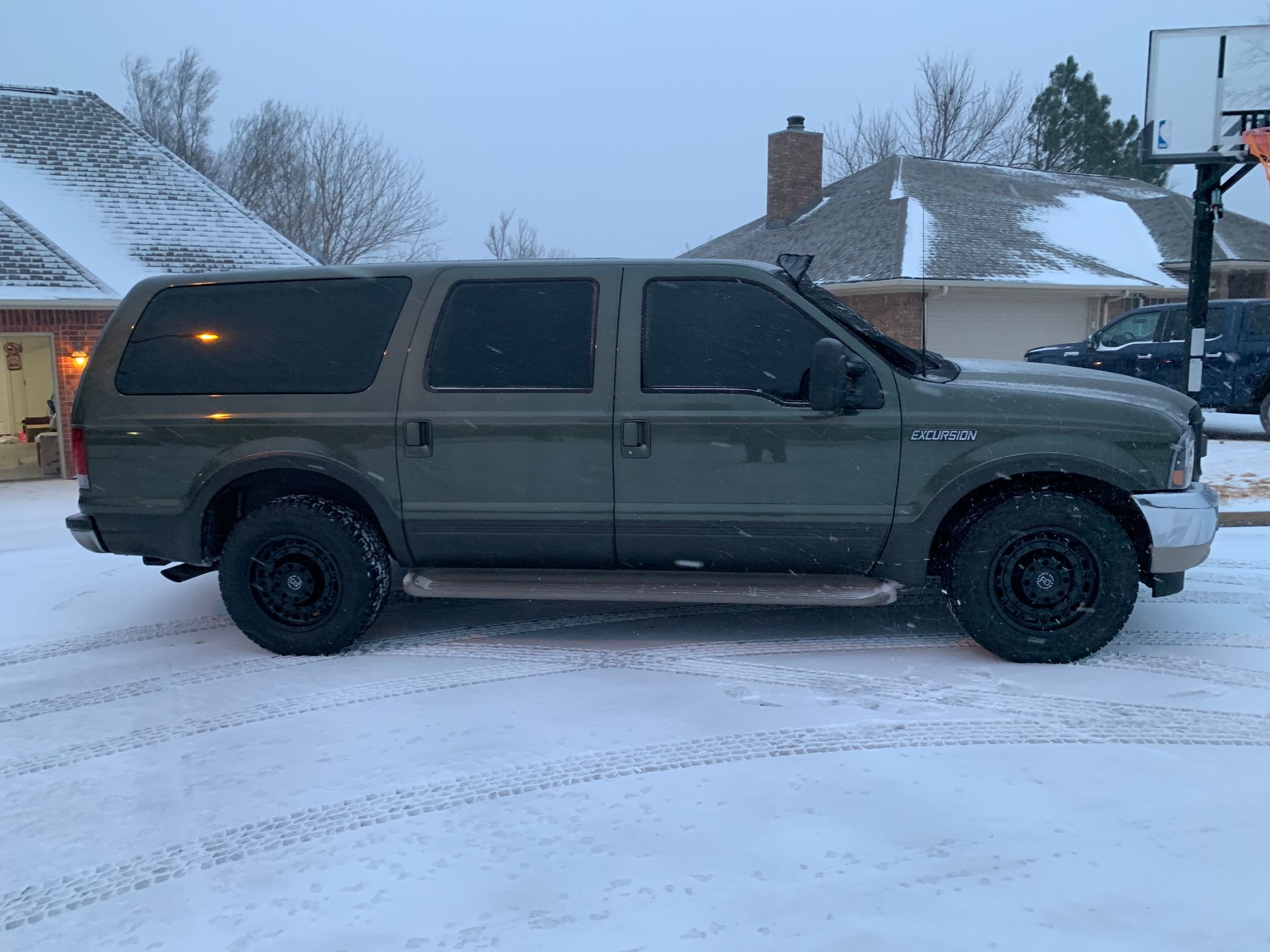

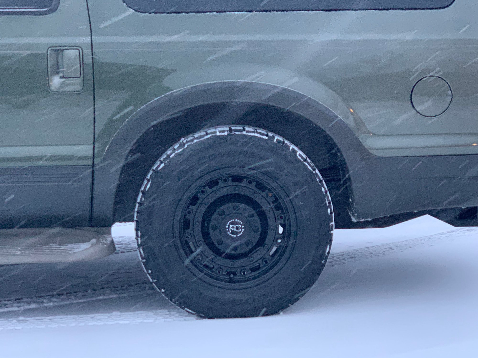

Overdue update
I determined the wheels I wanted in October and they finally came in late January. I ended up with Black Rhino 18”x9.5” -18 offset.

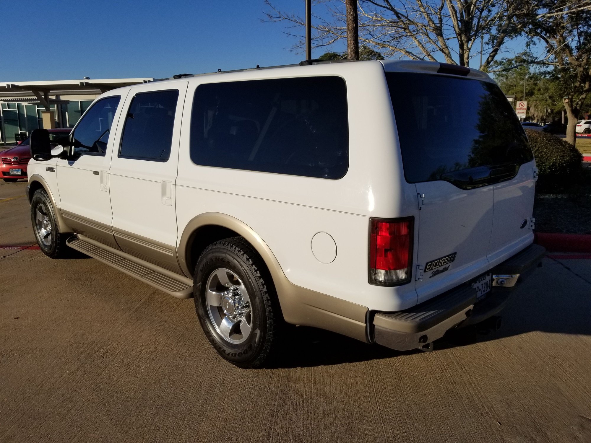

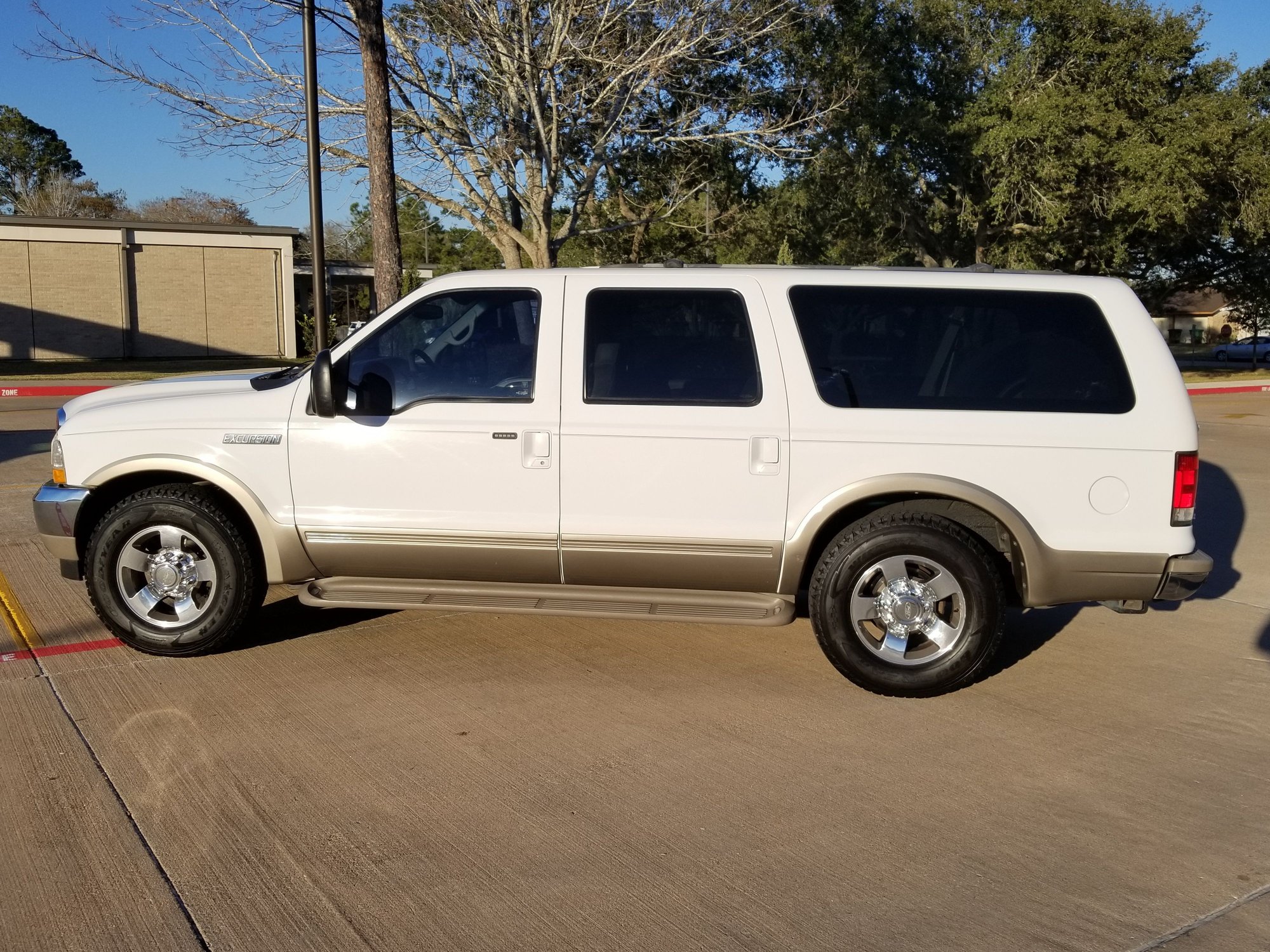

I just installed some factory 04 18" King Ranch wheels on the wife's Excursion. The 2wd actually has more room for bigger tires. I wrapped the wheels with Goodyear Wrangler Adventure with Kevlar 275/70/18 all terrains and could probably go bigger. This scenario picked the truck up about an inch. I plan on installing the same wheels...but in the Lariat edition...with 35's on my F350 4wd soon and plan on test fitting them on the Excursion just to see if they will clear. I had 285/75/16 tires on stock wheels on both trucks for years. We've been really happy with this setup for her buggy and I like the way these fill up the fender wells.

@bwguardian They look great! Do you have any rubbing? I had the tire shop try that first but was told they slightly rubbed so went down to the 65.

Thanks, as stated in my post above, there is no rubbing and actually have room I could go a little bigger. It's probably due to the wheel offset though...
