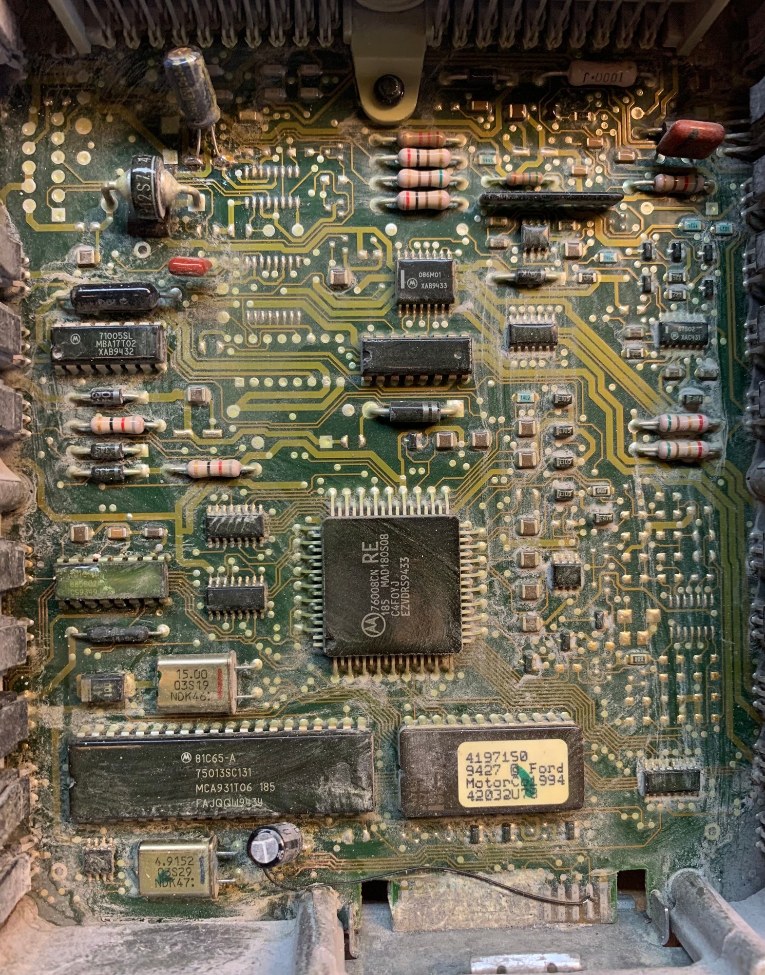

As you can see in the picture in this thread my ECM was fried so it was replaced and didn't fix the problem so it was replaced again then again for a total of three different units, last two were reman's.

For the heck of it I pulled the ECM out to check for burnt stuff , everything was ok. Looks like they replaced both of the troublesome capacitors and as you can see in the bottom of the pic they added a jumper wire to one of them, I'm assuming since I am having the same exact issue with three different ECM's that this isn't a problem. And for 570.00 they could have at least cleaned the board everything is covered in a white dust.

I do not like that picture of your ecm ,I would clean where the connector attaches to your ecm plug
