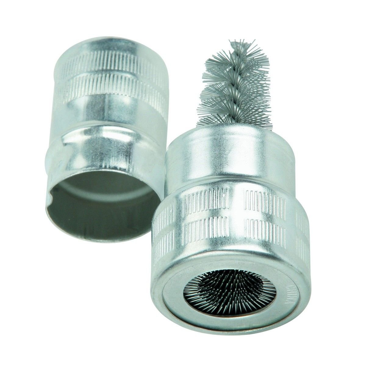

There is a neutral safety switch. Since you messed with the battery, I would double check your connections on the battery. I would make sure the terminals on the cables looked good, and I would go to the store and buy one of those battery terminal cleaners. Looks like the picture below. Take it and shine up the battery terminals and the cable ends. All it takes is a little corrosion to mess it up.
https://www.harborfreight.com/batter...rminal+cleaner

I do have one and used it to clean both ends. They are on solid and clean. I also used that protective spray on the after the battery was connected.
