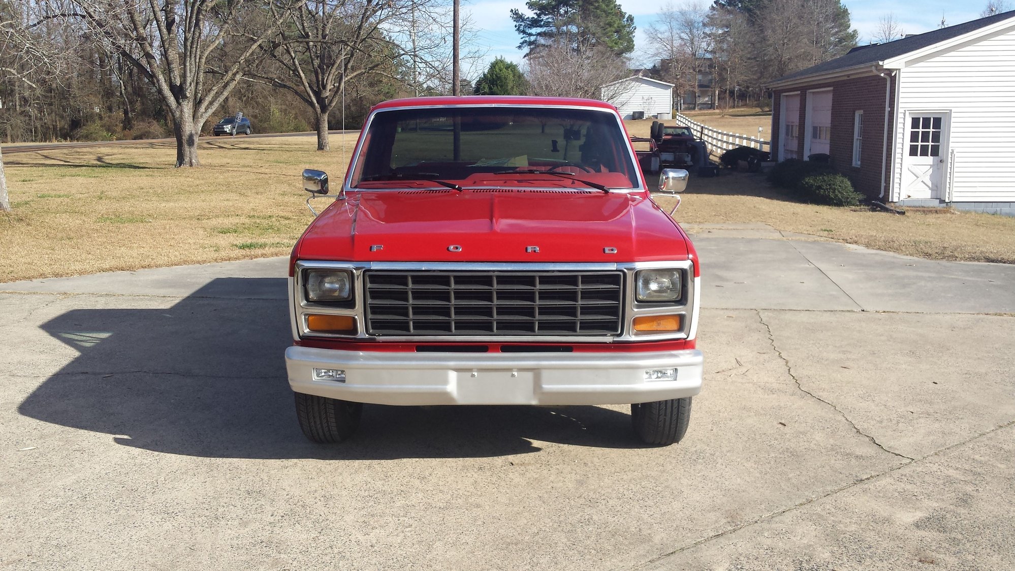

I run the same bulbs in my truck and I think they are pretty good evevn at 70 MPH the speed limit here and no street lights.
The only difference maybe between you and me is I run the head light relay kit.
This did make the head lights brighter as they are now getting a full 12 volts. Stock the power has to go through a lot of old small wiring, fuse box, head light switch & dimmer switch before hitting the head light bulbs.
The relays use battery power to power the bulbs and all the old small wiring, fuse box, head light switch & dimmer switch is used to turn on / off the relays.
BTW I light the head lights better on my pick up than my 02 Durango
If you do go with another type of bulb you will need to do the relay kit so I would do that first and see how you like it.
I also think there is a post in here on head lights like you asked about, do a search.
Let us know how you make out.
Dave ----
ps your head lights adjusted right?
If to high it will not light up the road then again you cant hunt squirrels at night
