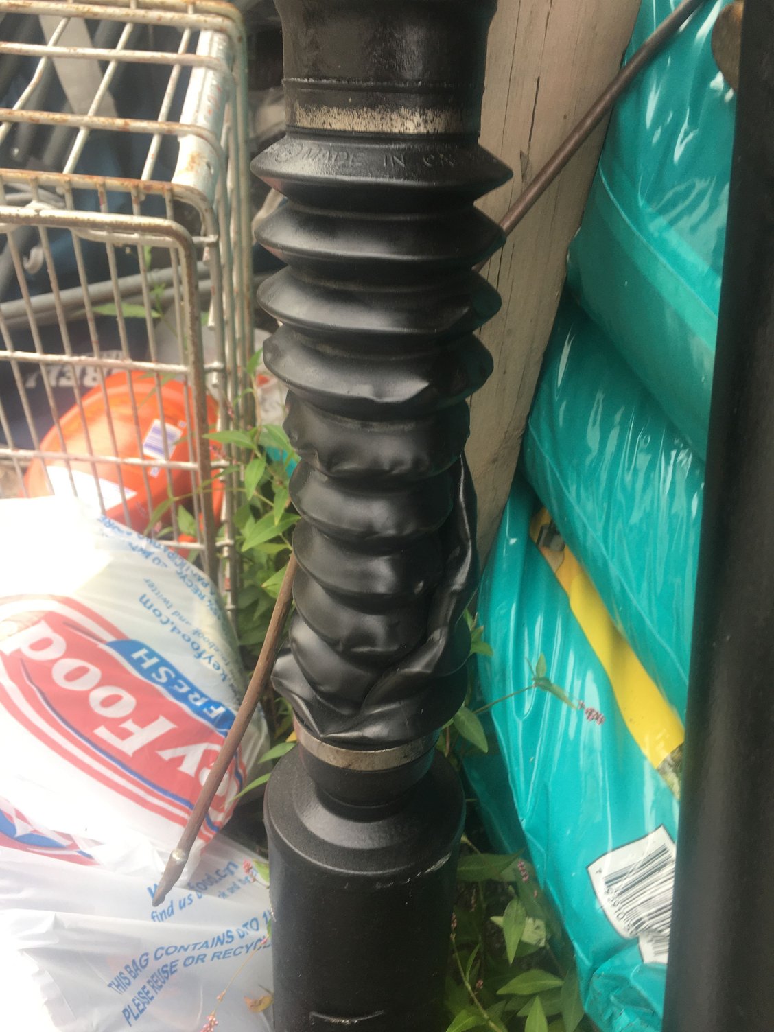

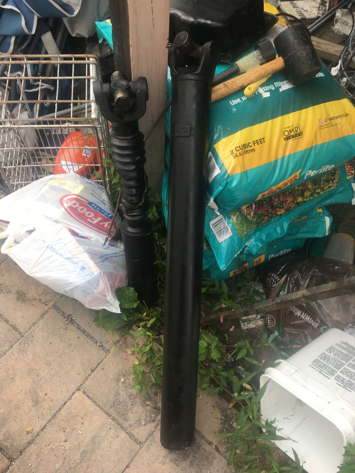

this is how bad the spline section twisted
replacement shaft is the whole shaft at a. OST of 1200. Should be here Tuesday.
I had to cut it to get it off and then it sprung out….scary
mat least the install will be easy.

so yes, I had 37”s on 22’s with a 2.5 lift in the front and no lift change in the back at the time the shaft twisted. I was debating o. The size of lift for the back and had ordered different sizes.
the shaft twisted when I floored it racing a new Camaro . After that I noticed a vibration.
The next day I started the new lift install ….taking out the level kit and putting in a 5” kit.
that’s when I noticed the twisted shaft.
the spline area was twisted so bad that the shaft would not come out with out cutting it.
I got the shaft out , orderd a new one which will be here Tuesday .
installed the lift and everything is ready for the shaft install.
I have some new carrier bearing drop kits which I ordered in different sizes and when the shaft comes in I need to do some analisys to see which spacer I need to use.
I thought the carrier bearing drop kit would be simple but after watching a few YouTube videos on the subject …this is more of an art than a science.
I theory you want some angles on both ends of the shaft and ideally the angle degrees should be equals as possible but one should ideally be reverse of the other ….else you lose the vibration cancellation .
so basically the carrier bearing spacers need to be put in to adjust the correction of obtaining the correct angle relationship. These shaft angles relationships has become pretty interesting.
had I not viewed these videos, I would have mistakenly tried to get a straight line , which would have resulted in less vibration cancelation.
I’m not sure if the shaft length is a concern yet until I get the new on and figure out how much travel are in the splines of the shaft.
interestingly,you can’t buy just the section that twisted ….I have a two piece shaft and the section that twisted is the section between the carrier bearing and the axle. To replace that section, Ford sells an entire new shaft drive line …rear shaft bolted to new carrier bearing with the front section bolted to it. These are balance as a unit and sold that way. This explains why there are a few front sections for sale as used items on eBay.
