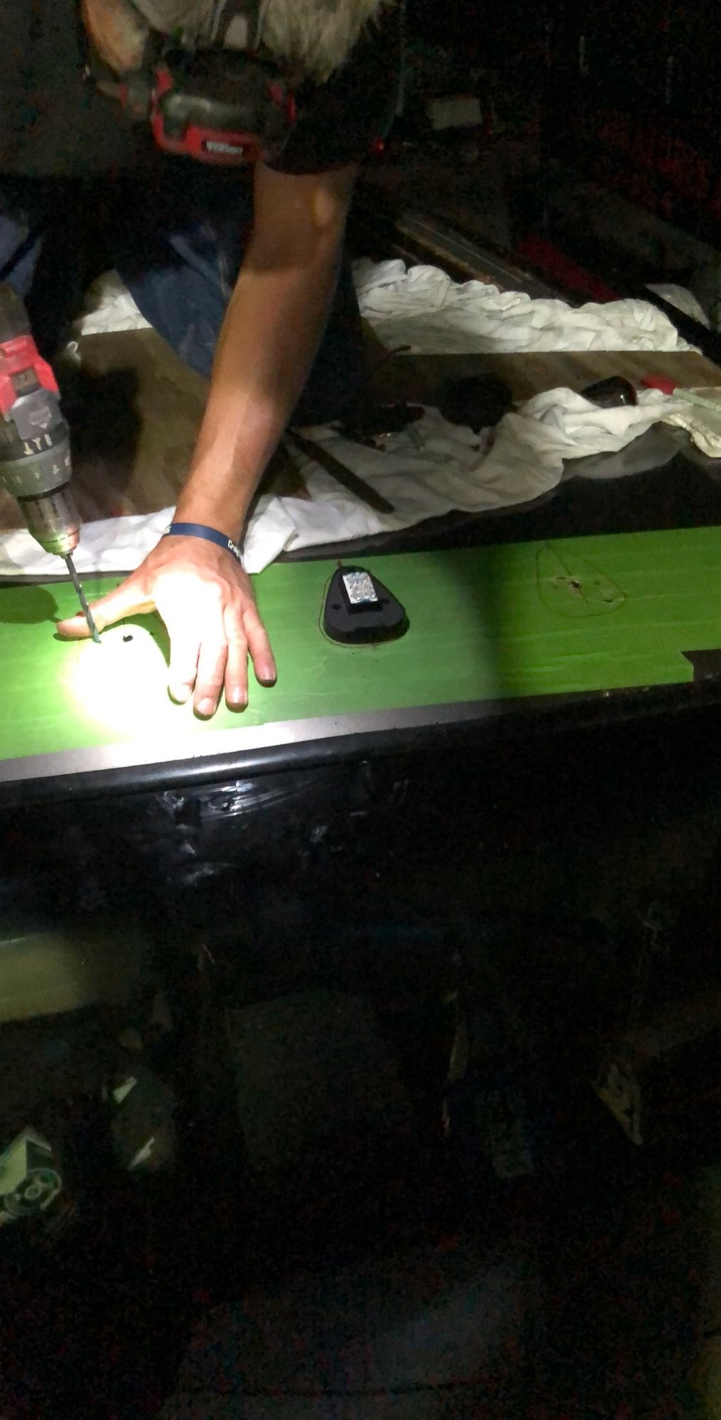

I installed cab lights on my truck, and I really like the way it turned out. You can definitely shop around and find higher quality lights, but my total cost of materials was $39.48 for the lights, and the harness. Install was not too difficult. I laid painters tape across the top of the truck and drew everything out, taking measurements from my dad's 02' F250. Links to the parts I bought on Amazon:
Markers:
Amazon Amazon
Harness:
Amazon Amazon
The only reason I did it was because I had already had the truck stripped out, headliner out, etc. The before and after was quite a difference, and I really think the Excursions do not look nearly as good without them. Would highly recommend people do this if they want to take the time. Don't drill your holes too big, and use silicone. I wired mine into the switch behind my dash to come on with my parking lights. Keep in mind, drilling holes in your roof is obviously creating another rust/fail point for the truck.
Also, don't be like me and make this an evening project unless you have a garage!
