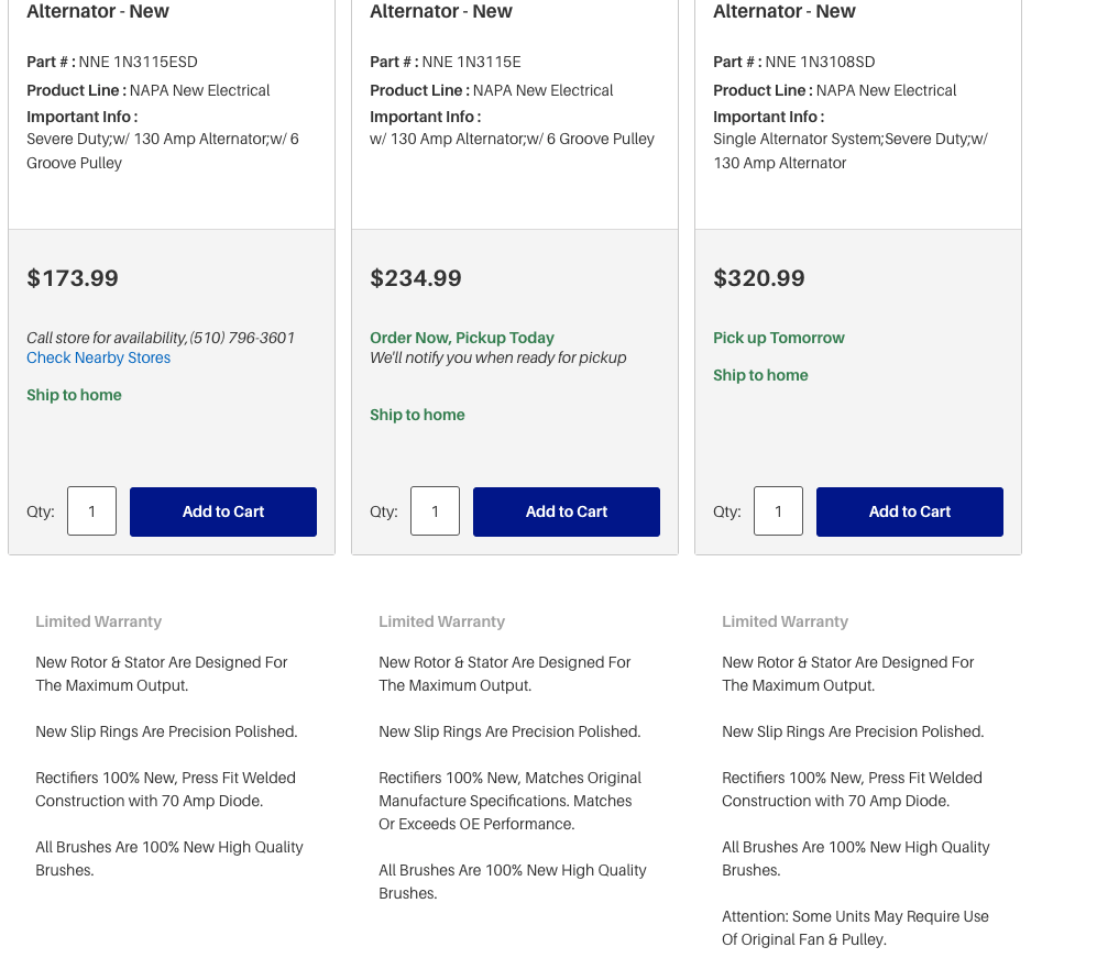

Seems like the lower priced severe duty is a better choice. These are the 2 best new Napa alternators listed.

Coolfeet I'd get a more clear understanding as to what that "limited warranty" caption really means---it doesn't seem to be described how long or what's covered.
I also don't see the spec's of your choices shown---what difference is there in the two and what justifies the price differences?
Seems to me last alternator I bought from NAPA was just at $200 but it's been at least 5 years by now.

The less expensive alternator is online-only, is rate "SD" or severe duty, press-fit welded, 70 amp diode. The limited warranty does not transfer when the vehicle is sold to the new owner. Since many Napa stores are independently owned, you cannot take back an online purchase to the local store. I suspect taking back a part purchased from another local store is just as difficult. I purchased a serpentine belt from Napa in Utah and was not able to return it to my local California Napa.
