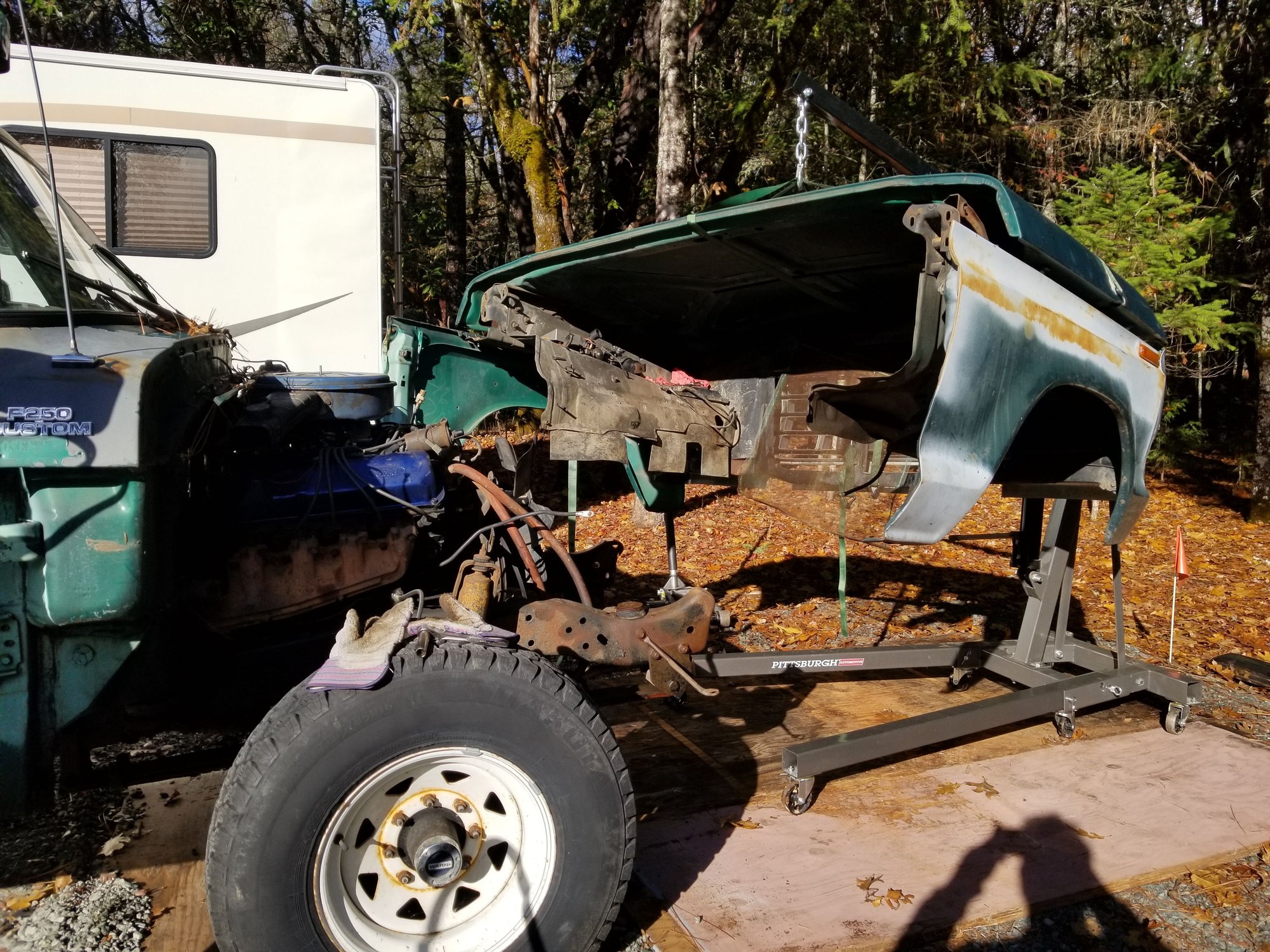

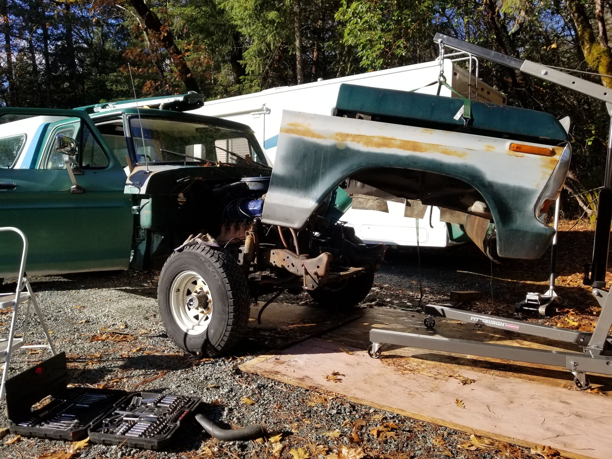

Did mine in one piece with engine hoist by myself, took some time to find balance points. Would have been easier with couple friends.
I also removed my front clip as one piece. I put a couple of ratchet straps. One going across the hood, and one going along the peak in the middle of hood and hooked engine hoist where the 2 straps crossed. Worked much better than I thought it would.
