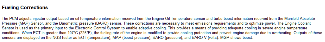

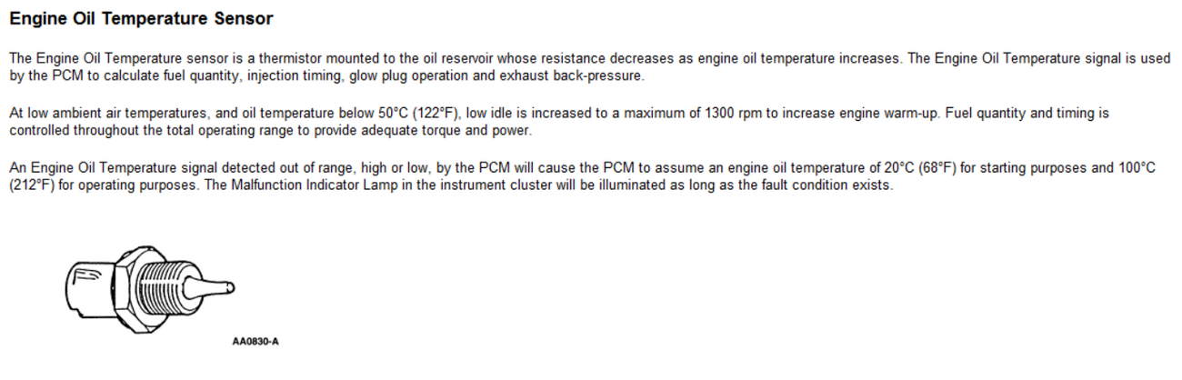

While researching another issue for an FTE'r, I ran across these bits of information that may be useful to you Listor.

If EOT exceeds 250* - I’m going to say something is broken.
I agree 100% that if EOT gets near or exceeds 250°, something is not right.
Although, when a statement such as the one below comes across from someone that portrays themselves as having extensive mechanical experience with diesels to include 6.7L's, Duramax, multiple 7.3L's, etc... and a visitor to the site or a new FTE'r reads it and takes it to heart, that is not good either.
I had a 203 about 4 trucks...I think? LOL....anyways, hotter EOTs are the reason I started running the 180* stat. Did the hotter oil really hurt anything? In short, no. But I was much more comfortable with maintaining 235-240 then the 265 I was seeing with a 203 thermostat. But, like anything, take it for what you will. That is my real world info as best as I can give it. Like it's been stated before, we can talk science and vectors and formulas about it all day long, but the bottom line is you need to be comfortable with whatever your engine oil temp gauge is telling you. I don't think the average Joe 7.3 owner can tell a real difference in an engine running 23 degrees warmer or cooler.
We all know that there is misinformation all over the internet and anything read should be verified. I am wrong just about everyday of my life, but if I make a statement here on the FTE in a post that is wrong, I will go back and insert an "edit" to correct my error. Just like if I stumble across a new bit of information that is relevant to an older discussion, I will update that discussion for future readers.
In my opinion, we (the FTE community) do a fairly good job of keeping that misinformation to a low boil and that is why the FTE is considered a great resource for validated and factual information.
