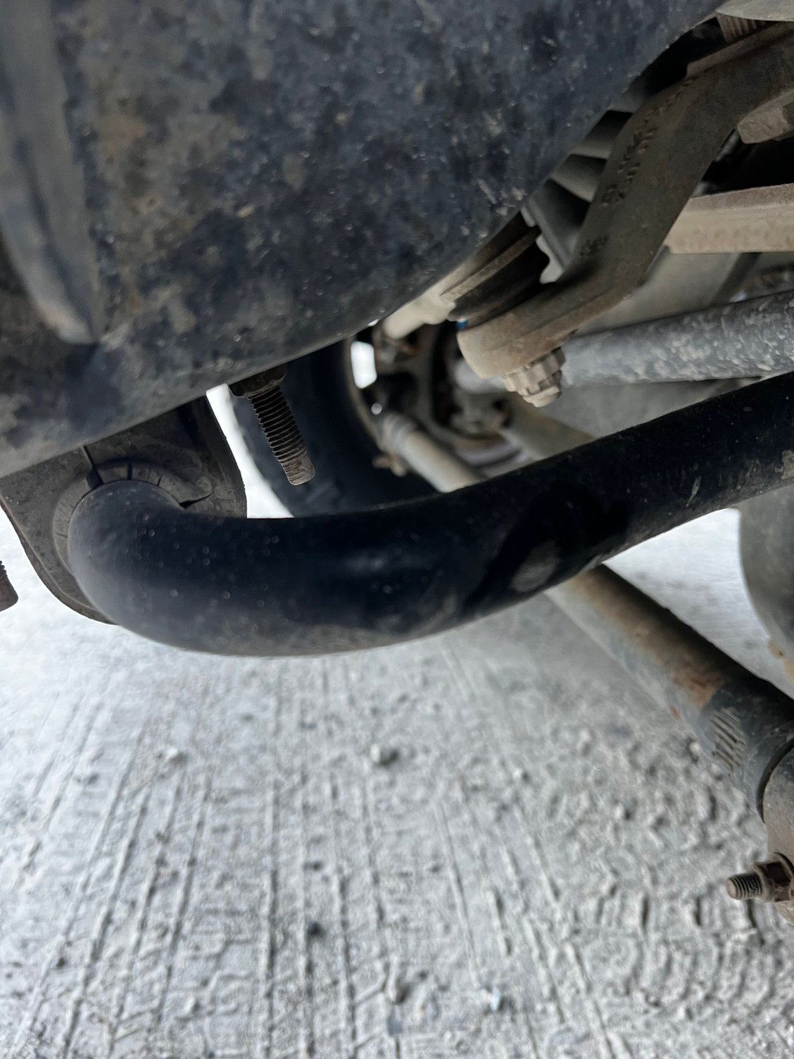

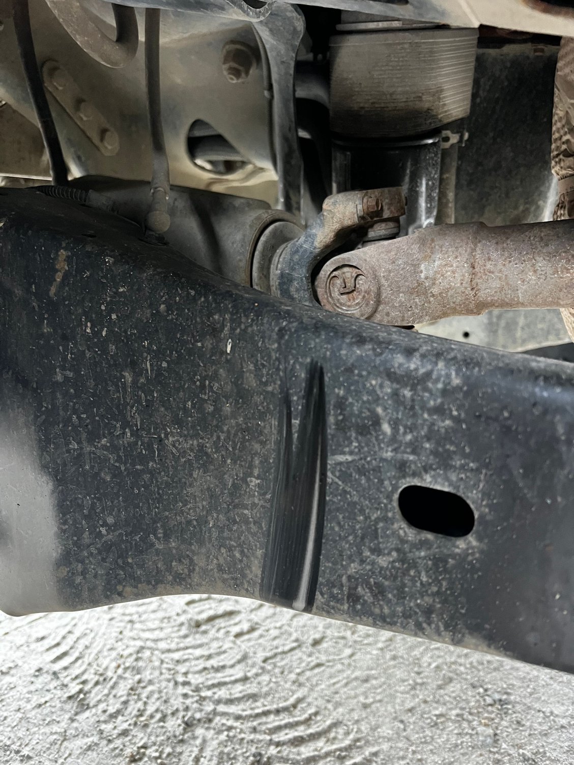

Some more info and pictures for anyone else who might be looking into this. 2019 F250 37x11.5 Nitto Ridge Grapplers on stock rims. Little rub on sway bar and arms, only lost 1/4 of a turn at full lock.

The helwig f-350 sway bar will take care of the turn radius rub.

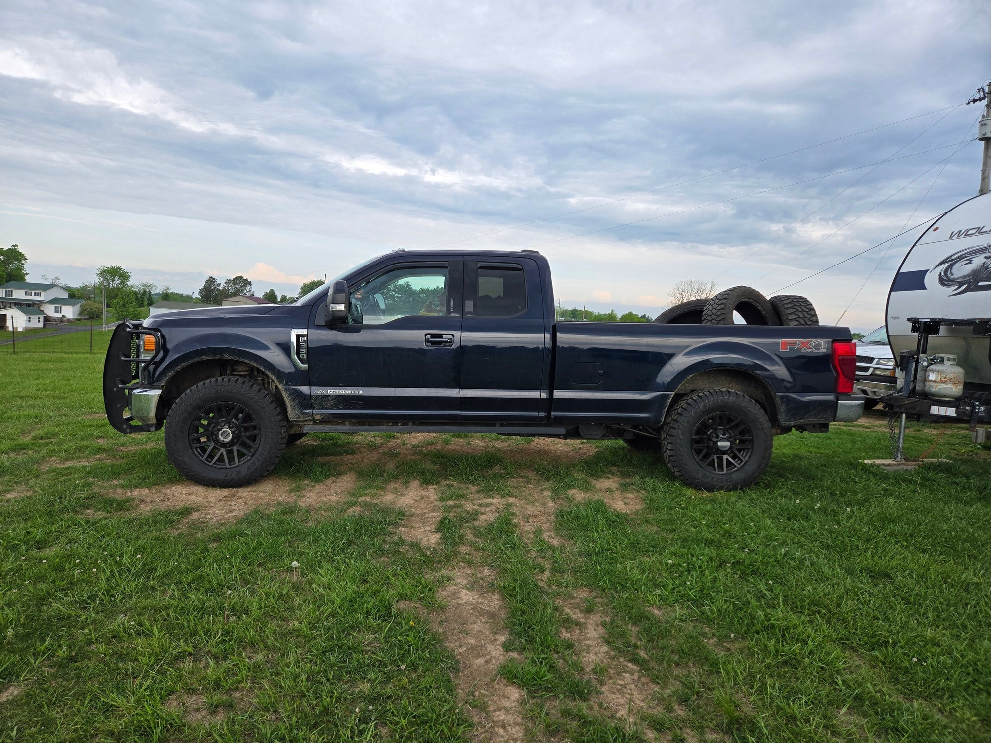

2” commuter level from Carli. 37nittos
climb.on
