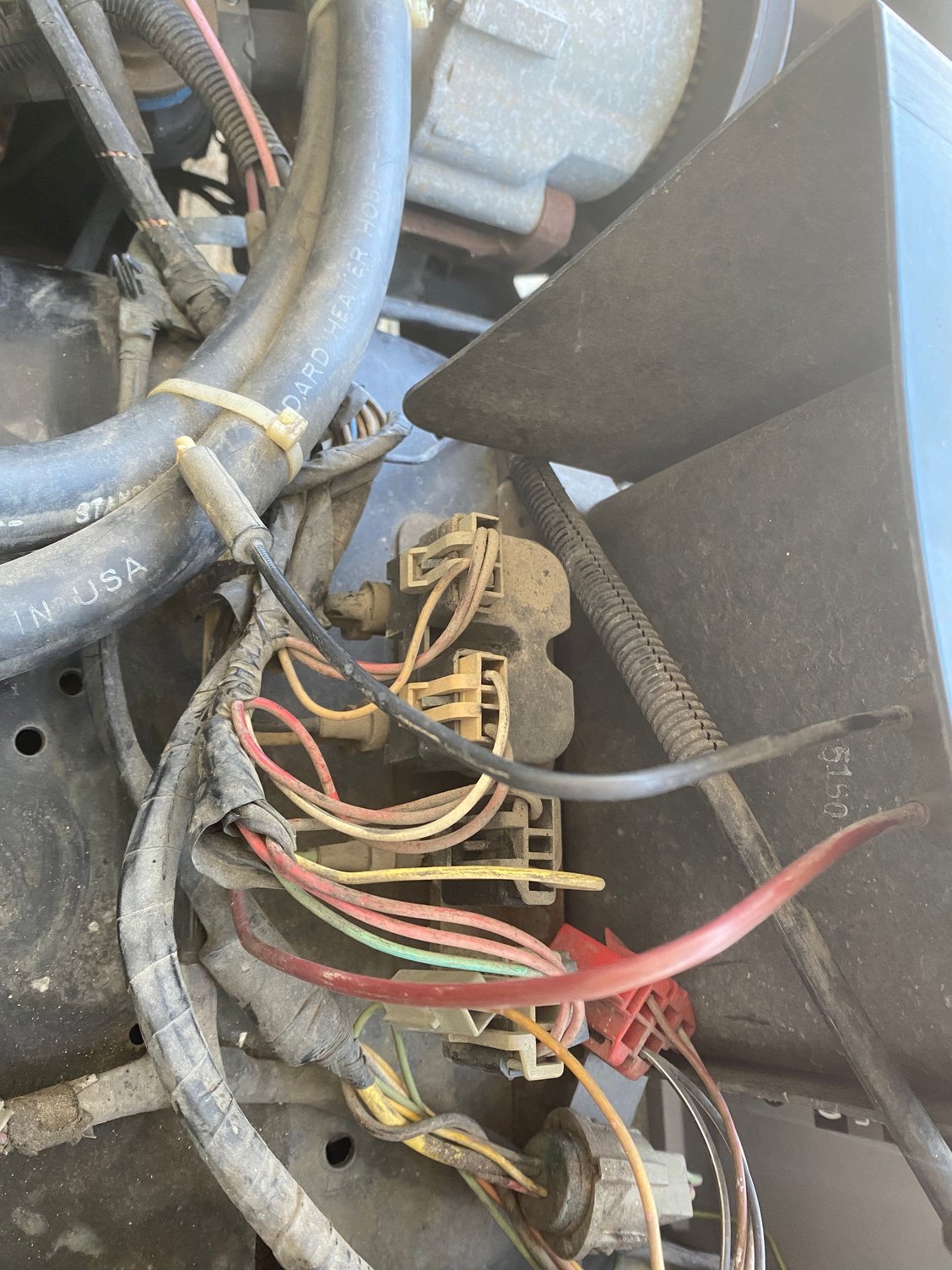

i found a black box with one hose thats not connected anywhere.

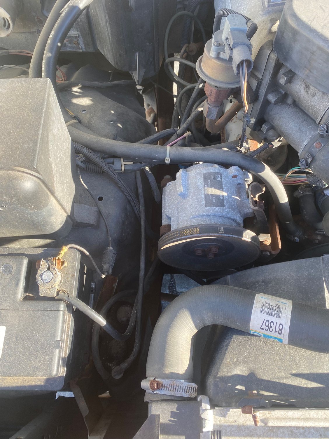

What is this box for? There is also a smaller box right next to the battery with two hoses.

I'm not sure what that black box is. I can tell from the second picture that your battery cables are toast. Eventually you'll want to replace your battery cables, that wouldn't cause your poor idle though.

Originally Posted by serik1980
I found a black box with one hose that's not connected anywhere.

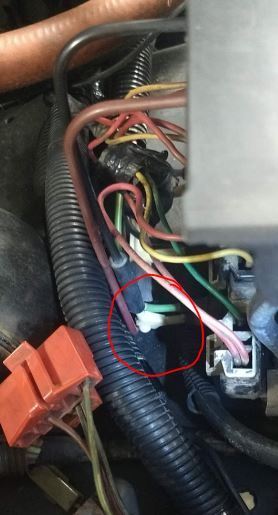

That loose hose is a vacuum leak. The red hose next to it is the vacuum supply from the manifold. The black box is a reservoir to hold a constant source of vacuum for the EGR and AIR systems. The loose black hose should connect to a tee in the EGR solenoid but it is broken off. part of the tee fitting is in the loose end. The broken fitting is under the wire circled in red. There is a sticker on the radiator support with an outline of all your vacuum line routing.
Tee here
Tee here
Thank you! I found it. There are alot of cracks under there. So need to order a new one.
thanks again
