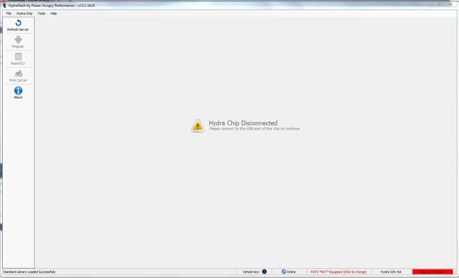

What tunes are you running? Canned, or modified injectors? I've had zero pats conflicts with my Hydra chip and PHP tunes. You need to go to the PHP site and download the HYDRAFLASH link so you can look at your tunes already on the chip, you may have to alter, or re-download the tunes again with the PATS Equipped option selected.
If you don't want to pull the chip and bring it to your PC, you can buy the USB cable to connect to the chip with a laptop and still installed on the PCM.

Here's the tunes I have loaded.
They're all php stock tunes, nothing custom at this point. The theft light blinks like crazy and disables the truck from starting, but when I unplug the chip it works immediately...
Later today I'm going to pull the pcm again and clean those terminals again with alcohol. All this is so strange. I installed the chip Saturday night and started the truck up, it was just fine and switched tunes... The next morning it was no good.

You are showing PATS Equipped, it's worth a call to PHP as well, they are usually helpful to answer questions.
