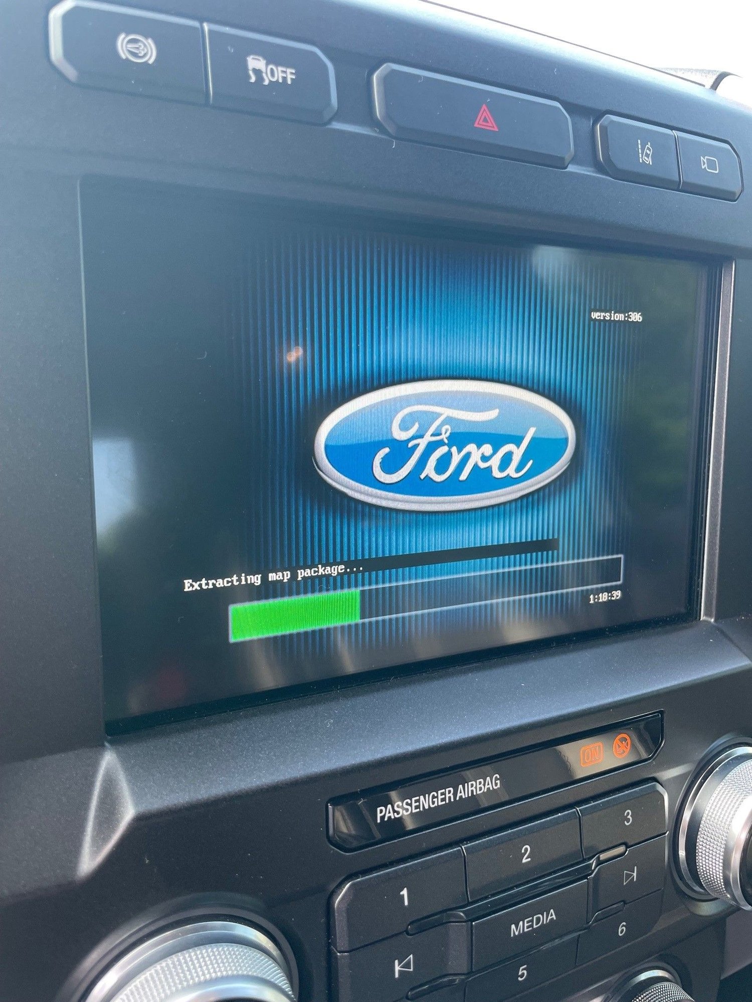

Anyone have issues with this taking forever? It seems like its stuck on "extracting map package." I tried this last night - got over 2 hours and ultimately I had to go to bed... Started it this am - it asked for the USB stick again and seems to get stuck in the same spot. Timer still counting up and pics still changing - I guess just let it run forever and see what happens or can it get "stuck" somewhere like this?

Yes the map packages do take a while but not 2 hours.
Are you updating all packages ? Sync and maps at the same time ?
It s recommended to do one at a time Sync then maps

Its at almost 3 hours now... The issue is that I initially tried to go from 3.4.21020 to 3.4.21194. I did the updater as in the past - and it was oddly quick. I checked the software and it was 3.3.19052. Not sure how that happened exactly. It worked - but I wanted 3.4.21194 so I re-downloaded the software again making sure that it said going from 3.3.19052 to 3.4.21194. I did include maps - I did that before on my truck and wife's Explorer w/ no issues. Should've left well enough alone I guess - but now I've got this thing stuck in some sort of update. Clock is still ticking up and pics keep changing like its doing something - but its been extracting map packages for 2.5 hours... I had stopped it late last night because it was after midnight - just kept coming up w/ the insert USB notification. Probably not a great scenario...

After 4.5 hours...I'm good to go! It finally finished updating and I have a fully functional 3.4.21194. Crazy it took that long...
