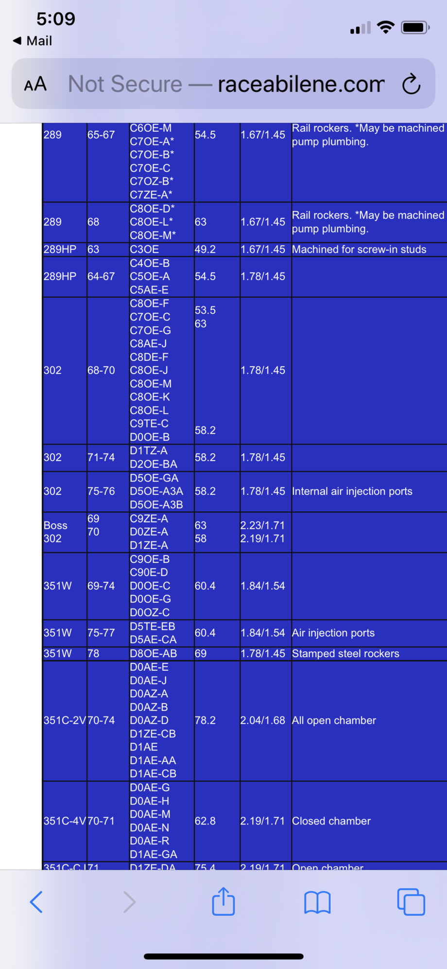

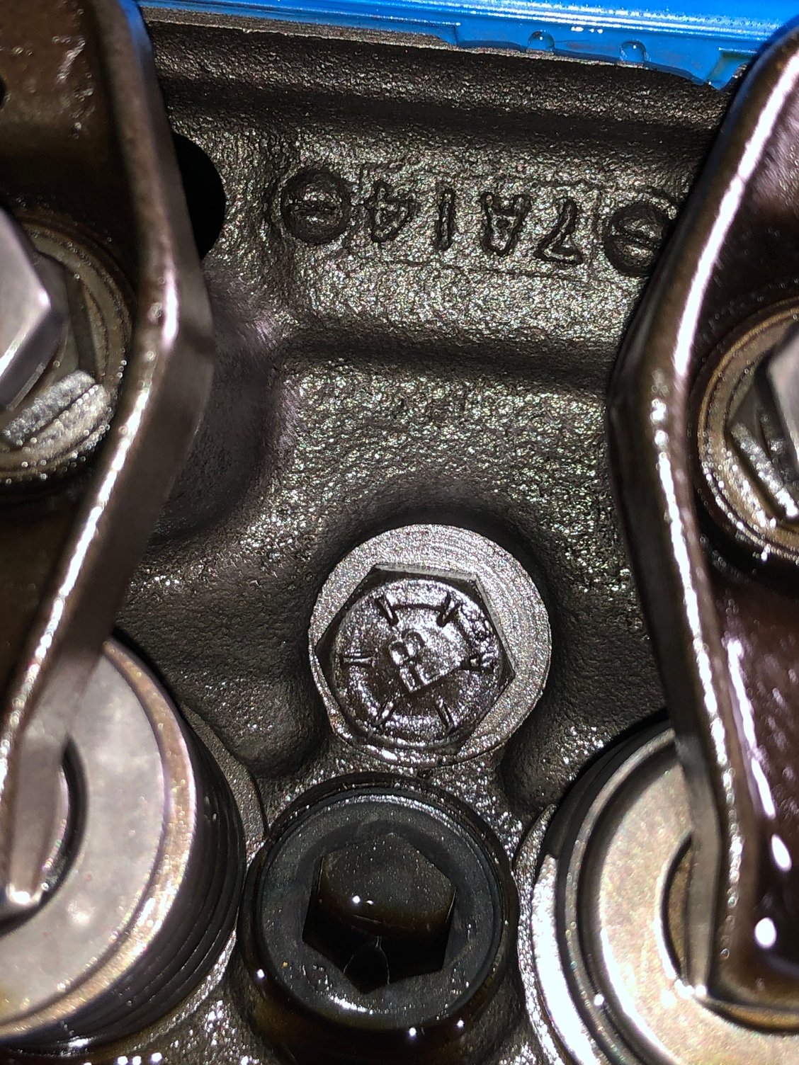

Actual usage date may be stamped on the block in front of the drivers head.
manufactured date code and type might be found under the valve cover.
(302 in the pictures)
Codes
Codes
Manufactured date stamp
Manufactured date stamp and type of head (different head)
Actual usage date (drivers head to the right and oil pressure sender below)
