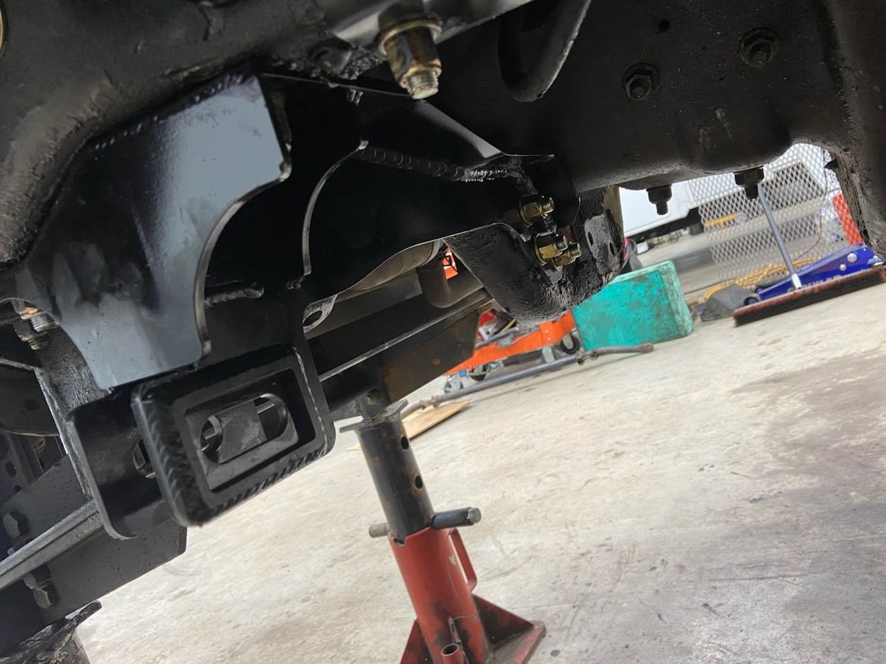

Worked on the front axle installed new ball joints and axle ujoints and hub seals.

never heard of TTX until now, i had those green ones on one side of mine and couldnt find out who made them
what did you do for torque sequence?
those top BJ sleeves look dirty, did you remove them so they can slide?

Impressed with them so far even come with adapters for ball joint press. Time will see how well the hold up, install went well.

I removed sleeve and cleaned them, tightened lower first then upper. If knuckle is still hard to turn loosen upper and tap on axle c until sleeves adjust then tighten. If knuckle is hard to turn you will have bad memory steer. This has worked well for me so far on solid axle fords.

The TTX were in good shape but i replaced them all since i didnt know the age.
i learned my lesson last year on the sleeve. thanks for that info
I went with tighten lower to 30, tap sleeve down, tighten upper to 69, tighten lower to 150
