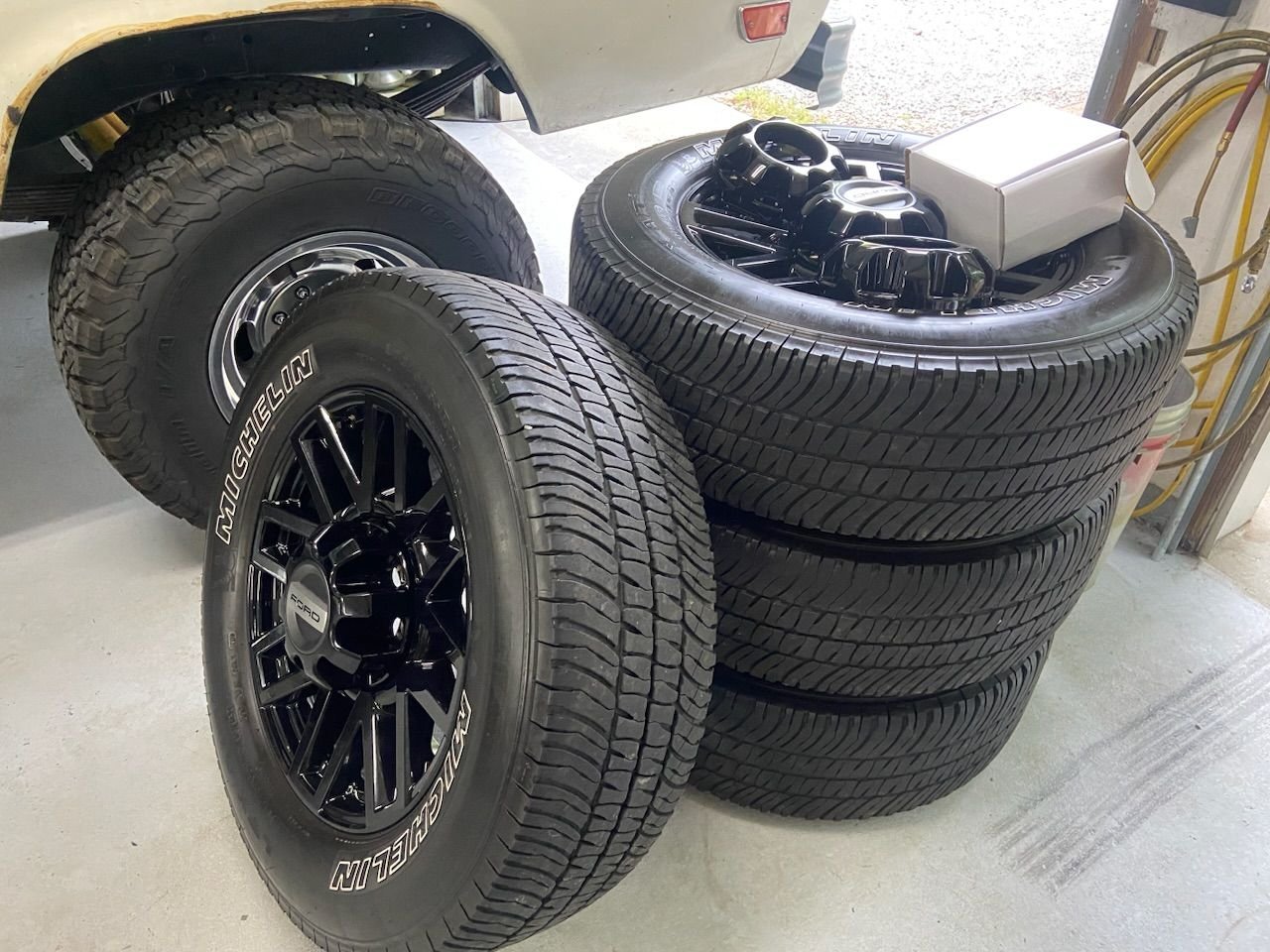

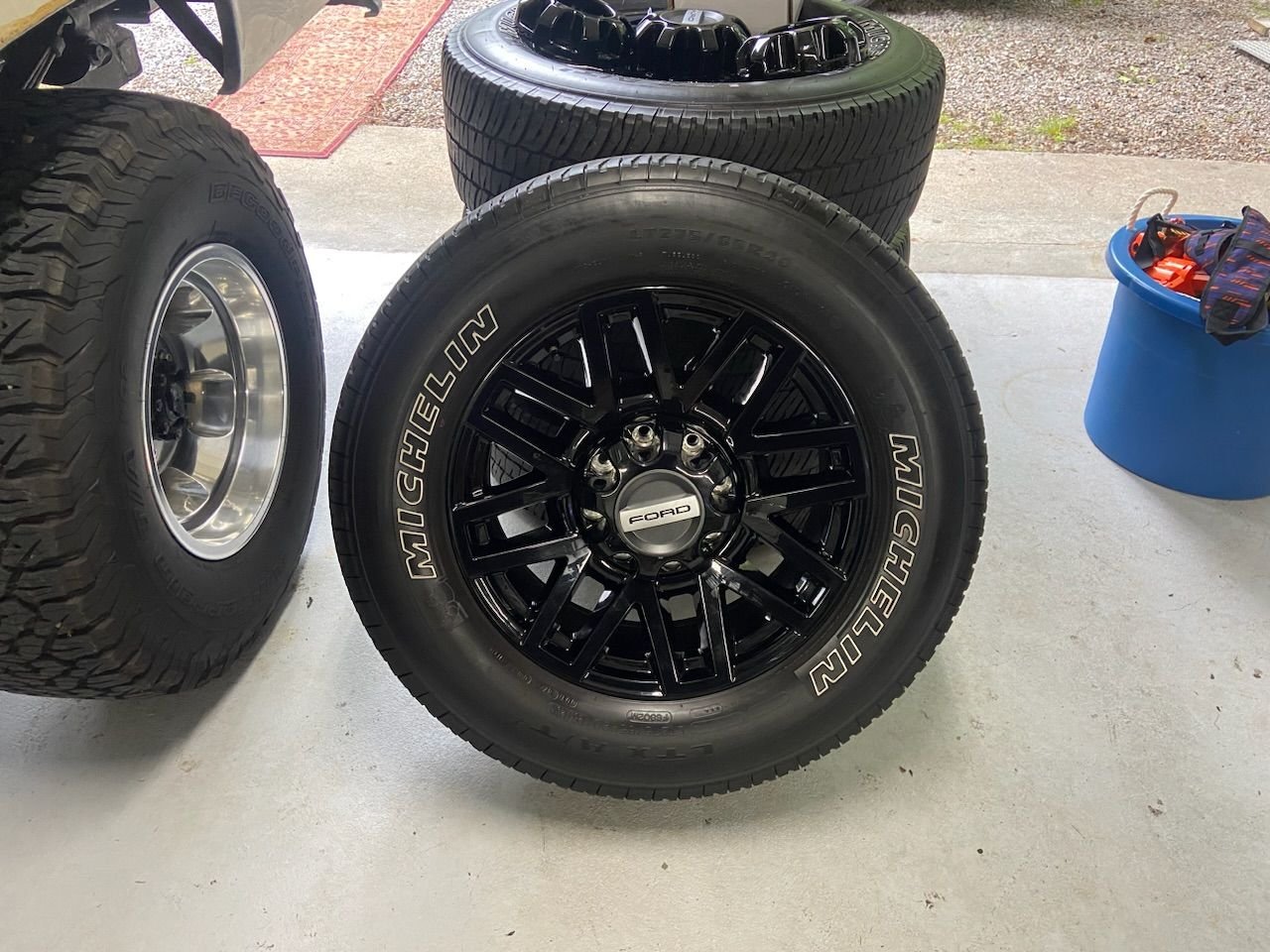

Picked up a set of superduty wheels and tires off of a 2019 f250.

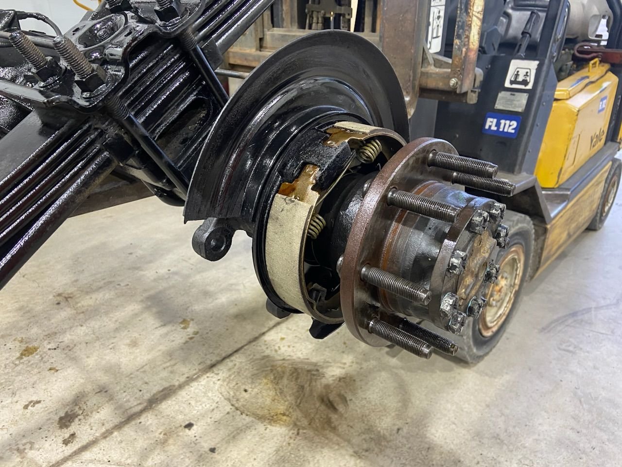

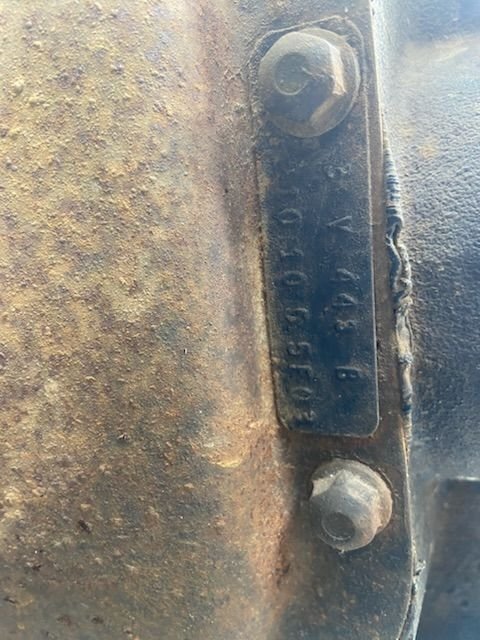

Went through the rear differential this afternoon, new axle seals, parking brake shoes and wheel studs. Took the cover off and inspected the ring and pinion. Everything looks new even the fluid looked like new, also confirmed the gear ratio and limited slid differential.

Old May 17, 2023 | 08:25 AM
